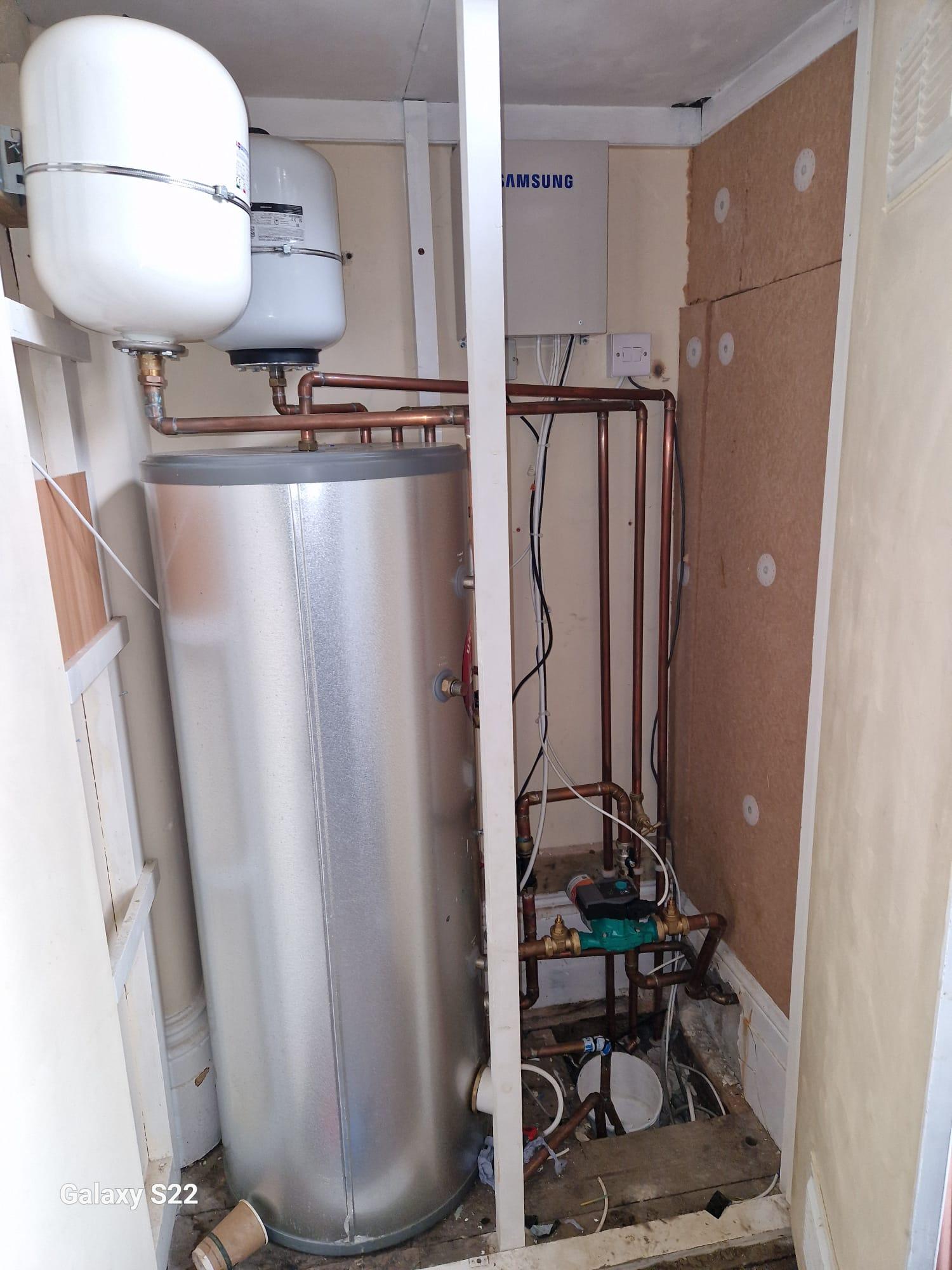

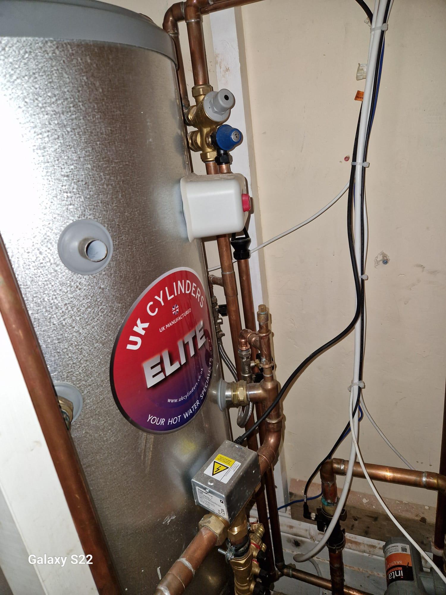

Erik79 Posted December 26, 2023 Share Posted December 26, 2023 We had recently installed a new ASHP, including new cylinder etc. The cylinder and pipework installation looks a bit messy but it is inside a cupboard so happy if it is just 'ugly' but otherwise works ok and is safe. Some of the things I noticed: -There isn't an isolation valve for at least one of the pipes coming out of the cylinder and feeding the circuit. There is no way to tell what is the mains cold water feed vs the warm water unless you know what you are looking for as none of them seems to be labeled. -The cables connecting the control kit to the various bits seem to be touching the pipework at places. -The only drain valve on the system seems to be on the radiator, neither externally or inside the cylinder cupboard I can see another one (maybe is not needed?). -I was told I would be a able to use the Smart things app to remotely control the Heatpump but there is no WiFi kit installed, again maybe not needed for that? -Externally apart from bits of insulation missing there is no drip tray installed at the moment,again is this just optional? Apart from the installation manual that came with the heatpump is there any other document I can consult for the installation mandatory requirements? It would be good to have some peace of mind as this installation has been quite a headache for us and now that it has been 'done' we would like to ideally forget all about it! Link to comment Share on other sites More sharing options...

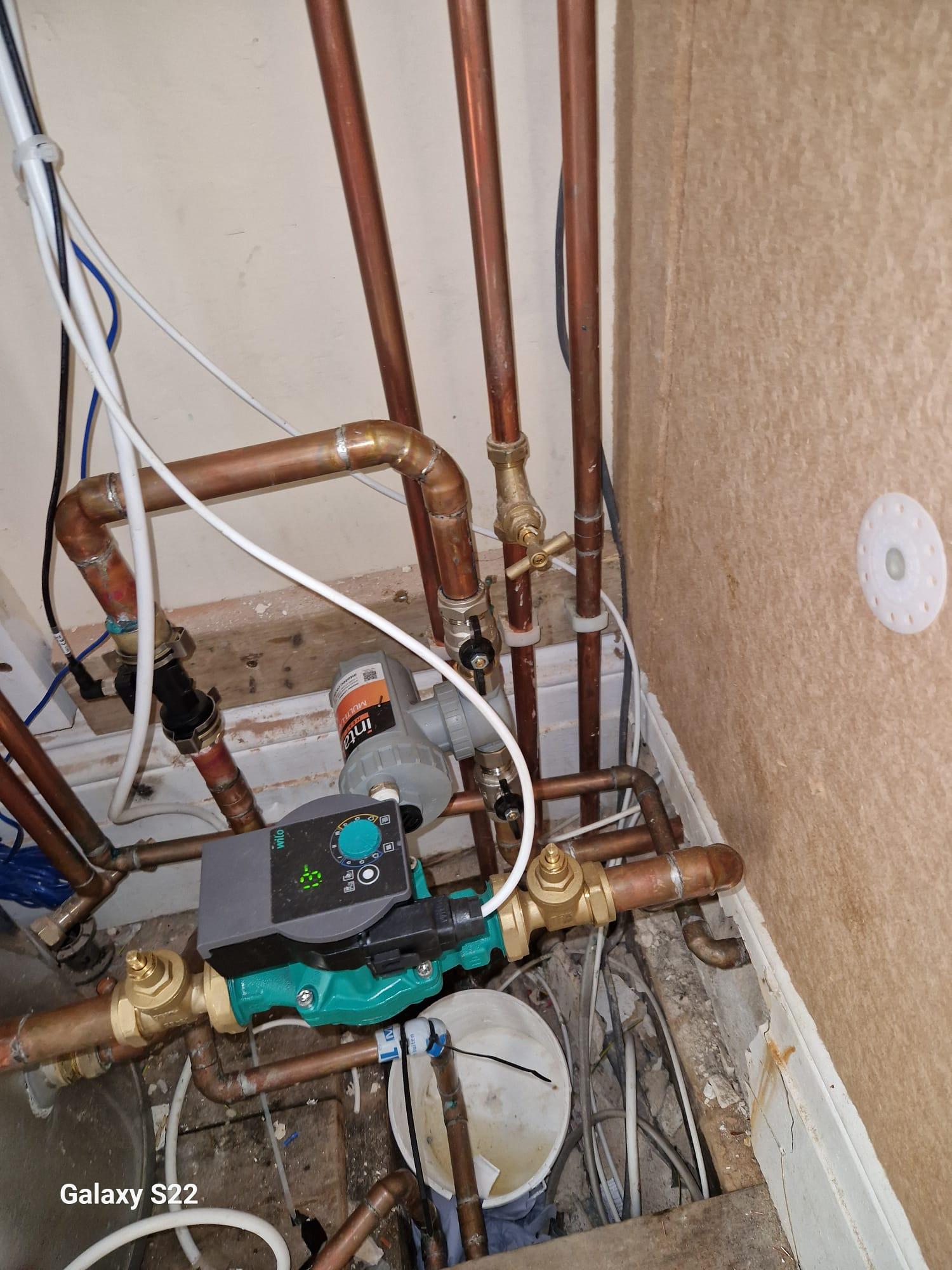

Beelbeebub Posted December 27, 2023 Share Posted December 27, 2023 pretty sure the intraklean filter should be vertical. Not a great sign if it was left likethat. In fact, the general state of the cupboard is pretty bad *if* this was how it was handed over to you. if this is mid job, or during some other work then it's forgivable. I notice the bucket and what appears to be some sort of cable tied repair? Link to comment Share on other sites More sharing options...

Dillsue Posted December 27, 2023 Share Posted December 27, 2023 In fairness if they've not finished it may be abit premature to be critiquing the job?? Obvious things that stand out are- No/limited pipe clips to support pipework- it shouldn't be relying on the fittings for support No limited support for cabling- it shouldn't be dangling from the control box No pipe insulation Hopefully they'll sort everything out when they come back Link to comment Share on other sites More sharing options...
Erik79 Posted December 27, 2023 Author Share Posted December 27, 2023 7 minutes ago, Dillsue said: In fairness if they've not finished it may be abit premature to be critiquing the job?? Obvious things that stand out are- No/limited pipe clips to support pipework- it shouldn't be relying on the fittings for support No limited support for cabling- it shouldn't be dangling from the control box No pipe insulation Hopefully they'll sort everything out when they come back Thank you, it is good to know what to expect as the final product. Link to comment Share on other sites More sharing options...

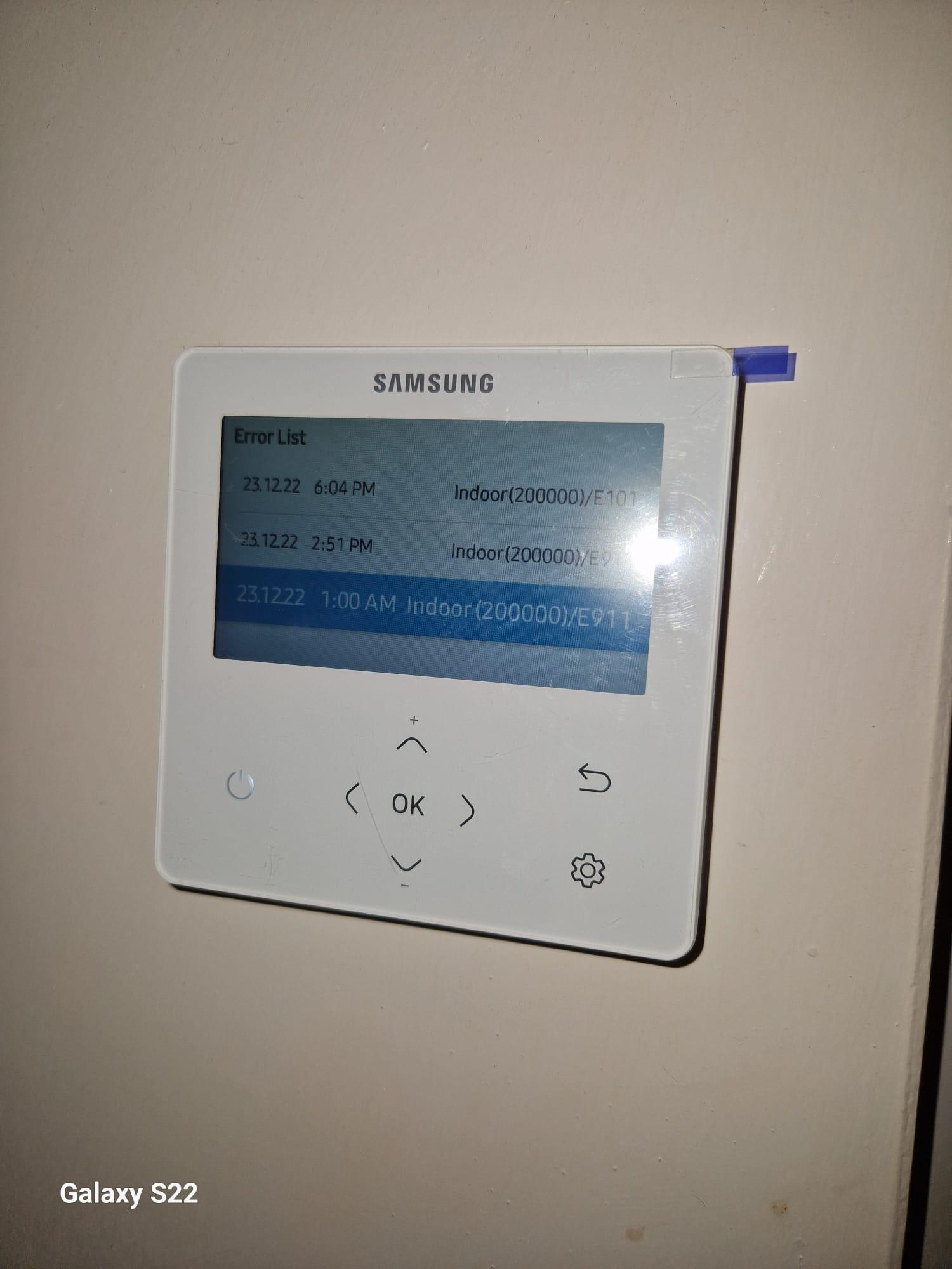

Beelbeebub Posted December 27, 2023 Share Posted December 27, 2023 E911 is a problem with the flow and e101 is the controller not being able to see the outdoor unit? Link to comment Share on other sites More sharing options...
billt Posted December 27, 2023 Share Posted December 27, 2023 56 minutes ago, Andehh said: The Samsung controls are very basic, and with the thermostat built in will always read overly warm by the nature of an airing cupboard. As part of the hand over they must take you through its operation, including how to use it. The Samsung instructions are quite complicated for a novice. Have a look through YouTube videos so you know enough to know what they're talking about! Most systems will have an external thermostat, then use the Samsung system for the hot water which is obviously fine for basic controls. That install does look quite messy, I would encourage you to keep a close eye on this project! I can't see the remote in the wide pictures of the airing cupboard so one would hope that the remote has been installed somewhere sensible. Even if it isn't you can get a remote temperature sensor which can be installed in a suitable location. https://midsummerwholesale.co.uk/buy/samsung-heat-pumps/Remote-Temperature-Sensor-MRW-TA I installed my remote in a location which didn't perform very well so I installed a remote sensor in a more suitable location. I think that the Samsung remote is pretty good, as long as the system has been designed correctly. You can programme several heating or hot water schedules; I don't see what an external control would give you more than that. Have to say that it isn't at all intuitive to use initially, but once you've set it up the home page has easy access to control either the heating or the hot water, both on/off and temperature. IOW it's pretty similar to most programmers, not intuitive and fiddly to set. In the end scheduling doesn't work very well with our slightly undersized system so it's been setup to 20C in the living room constantly. That works better than timed control both for comfort and economy, but the system does have to be carefully adjusted to work properly. 1 Link to comment Share on other sites More sharing options...
billt Posted December 27, 2023 Share Posted December 27, 2023 48 minutes ago, Beelbeebub said: E911 is a problem with the flow and e101 is the controller not being able to see the outdoor unit? It may be something as simple as the wiring between the indoor control box and the outdoor unit; there doesn't look to be any securing for the cables so it might have come adrift. (It's only 2 wires.) The flow sensor for the pump control is the black thing on the vertical pipe to the left of the magnetic filter, but I suspect that there could be a flow switch in the outdoor unit as well. 1 Link to comment Share on other sites More sharing options...
