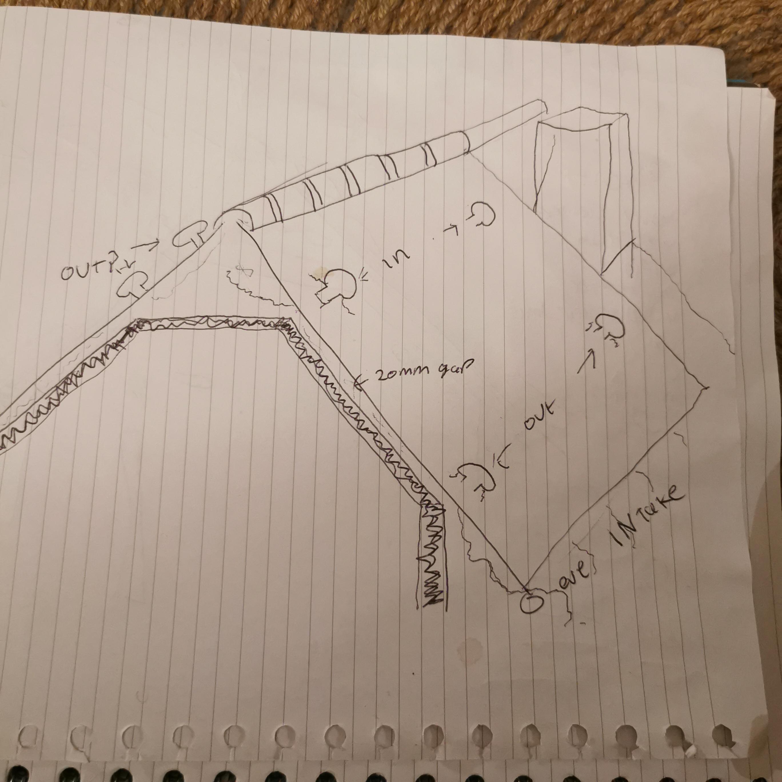

Looba45 Posted December 18, 2023 Share Posted December 18, 2023 Hi everyone hope you're all well and enjoying the warm spell. In need of some help with my roof which I did myself (novice roofer/builder) in the summer. Looking for advice and not criticism please! I have a loft bedroom and it has recently been plagued with bad condensation and mould, and I believe the issue is that there isn't enough air flow between the insulation and felt. I was wondering if installing vents in certain locations as on the drawing I've done will help or just make things worse. It's a fiber slate roof with breathable felt, eve vents and dry ridge with the felt cut at the ridge. Holding my hands up, this was a big lesson, I opted for more warmth than airflow and I'm paying for it now. Just wanted to see if what I suggested is an option to avoid having to get the scaffold back up and the insulation board swapped. Thanks Link to comment Share on other sites More sharing options...

Mike Posted December 18, 2023 Share Posted December 18, 2023 13 minutes ago, Looba45 said: I believe the issue is that there isn't enough air flow between the insulation and felt. .....It's a fiber slate roof with breathable felt If it's a breathable membrane installed in accordance with the manufacturer's recommendations / the BBA certificate, and the conversion was done to Building Regulations standards, then the probability of that being the source of the problem is low. More likely it's a problem generated within the house. Condensation is caused when warm humid air cools down, which suggests that you need to improve ventilation in the room / house, remove or reduce the sources of humidity, improve the heating in the room, or all of these. As the problem is only in this room, maybe that's because it's not much used and therefore may has a shut door and maybe isn't heated often / much? At least I'd guess that the eves cupboards are the least heated / worst ventilated part of the room. Link to comment Share on other sites More sharing options...

Looba45 Posted December 18, 2023 Author Share Posted December 18, 2023 Iknow the diagram of the roof vents I've drawn is far from detailed but wondering if where I'm planning on placing the vents will help with the intake/ outtake and airflow, never had a problem with condensation before the new roof. And just wanting a cheep fix while Christmas time is always hard financially. Link to comment Share on other sites More sharing options...
Mike Posted December 18, 2023 Share Posted December 18, 2023 1 hour ago, Looba45 said: It is only used for sleeping in and doesn't get much heat. The eves cupboard is in the cold part of the roof where the air flow is and shower /bathroom underneath with an old extractor fan. That ticks off everything I mentioned above. So most likely a major part of the solution is to replace the extractor fan, boost the room temperature, and leave the eves cupboard doors open. And apply some mould killer. 1 hour ago, Looba45 said: I have been wondering if re plastering with a damp proofing behind the plaster would help? It seems unlikely that the damp is coming through the roof (if that's what you're thinking the damp proofing would help), so probably not. But maybe I've misunderstood. 1 hour ago, Looba45 said: wondering if where I'm planning on placing the vents will help with the intake/ outtake and airflow As you're sure it's all built OK as above, I don't think that's likely to help. Link to comment Share on other sites More sharing options...
Redbeard Posted December 19, 2023 Share Posted December 19, 2023 Is there a leak in the extractor fan duct, or around its exit through the bathroom ceiling (i.e. are you feeding water vapour into the eaves void? In terms of 'quality' of ventilation I much prefer eaves ventilation (preferably about 25mm) across the whole width of the roof on both sides, so that you have excellent cross ventilation. In most of the situations I come across with a roof moisture problem where a few tile vents have been used, the problem continues, suggesting that whatever number of tile vents you think of putting in, it's often not enough. Add to that the fact that they tend to start say 900mm above the gutter, and that leaves the water vapour 'un-purged' from the bottom of the triangle. Link to comment Share on other sites More sharing options...

Looba45 Posted December 19, 2023 Author Share Posted December 19, 2023 And no leak just an old extractor fan that sounds quite haggard and is coming out the wall so the steam could be coming back in through the existing eve vent. I installed the eve vent when I did the roof it's just that there's not a 50mm air gap That can take the air up to the ridge line. was planning on installing 8 altogether. 2 either side just where the air gap gets tight 20mm so could be sucked in the eve and put the vent and 4 at the top 2 low down just above the 20mm gap and 2 higher up in the hopes air will flow through one side and out the other. Link to comment Share on other sites More sharing options...
