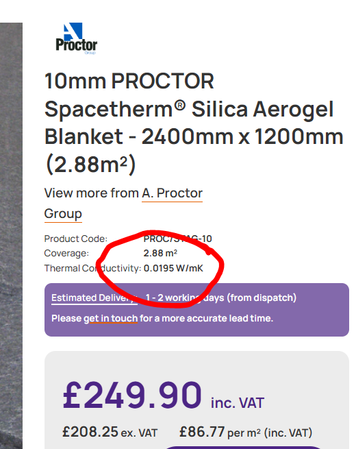

nwnw Posted December 16, 2023 Author Share Posted December 16, 2023 10mm 'Spacetherm' aerogel blanket is about £150 for the area I need. Not cheap, but if it makes the room warmer I'm willing to stomach the price Link to comment Share on other sites More sharing options...

Iceverge Posted January 13, 2024 Share Posted January 13, 2024 On 12/01/2024 at 15:54, nwnw said: This doesn't make sense to me. The U-value of aerogel blanket far exceeds that of rockwool. Sorry I was a bit off with my calcs. 10mm of a thermal conductivity of 0.0195W/mK will give a U value of 1.95W/m2K. for £150. 18mm of Rockwool with a thermal conductivity of 0.035W/mK will also give you a U value of 1.95W/m2K. You can't buy 18mm though so if you can fit 25mm of rockwool it'll be a U Value of 1.4W/m2K for a cost of £3. 1 Link to comment Share on other sites More sharing options...
nwnw Posted January 16, 2024 Author Share Posted January 16, 2024 Yes, Iceverge you are spot on. I should have dug into the numbers. I thought aerogel was supposed to be some wonder material but once manufactured into the blanket form a K value of 0.02 vs 0.034 is Rockwool is not exactly groundbreaking. I now see why aerogel has not taken off! Thanks. 1 Link to comment Share on other sites More sharing options...

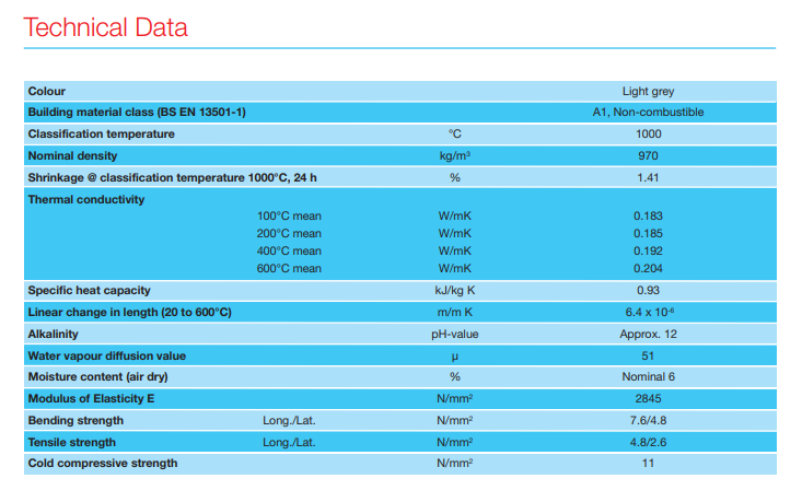

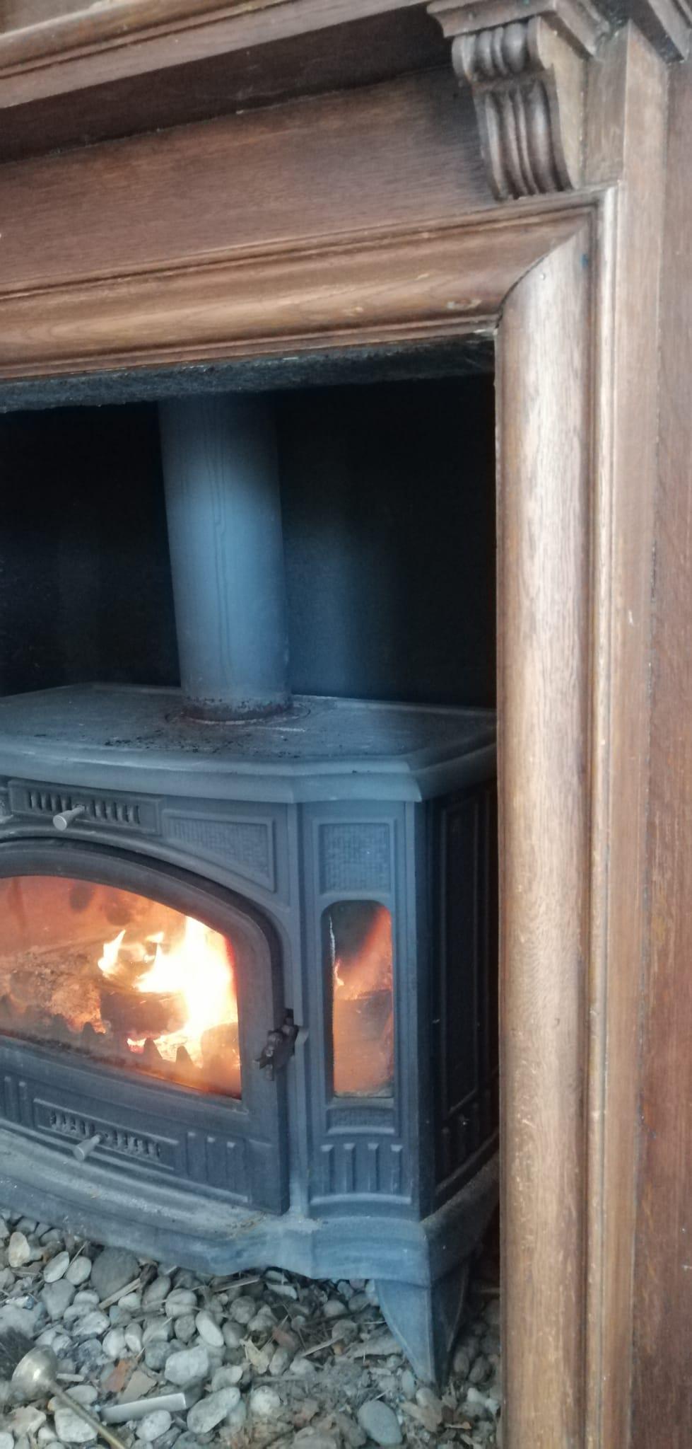

Polish Builder Posted January 17, 2024 Share Posted January 17, 2024 You can go for Promat Promafour board but they are very expensive as they are designed for fireplaces and wood burning stoves. Also using a promat you need to use their filler, glue and it would cost a fortune. Personally, I would go for a cheaper option using rockwool ablative coated batt combined with 6mm a1 multipurpose board. I got it installed 10 years ago and it works well, the board behind the stove is covered with black fire paint. See below: Link to comment Share on other sites More sharing options...
