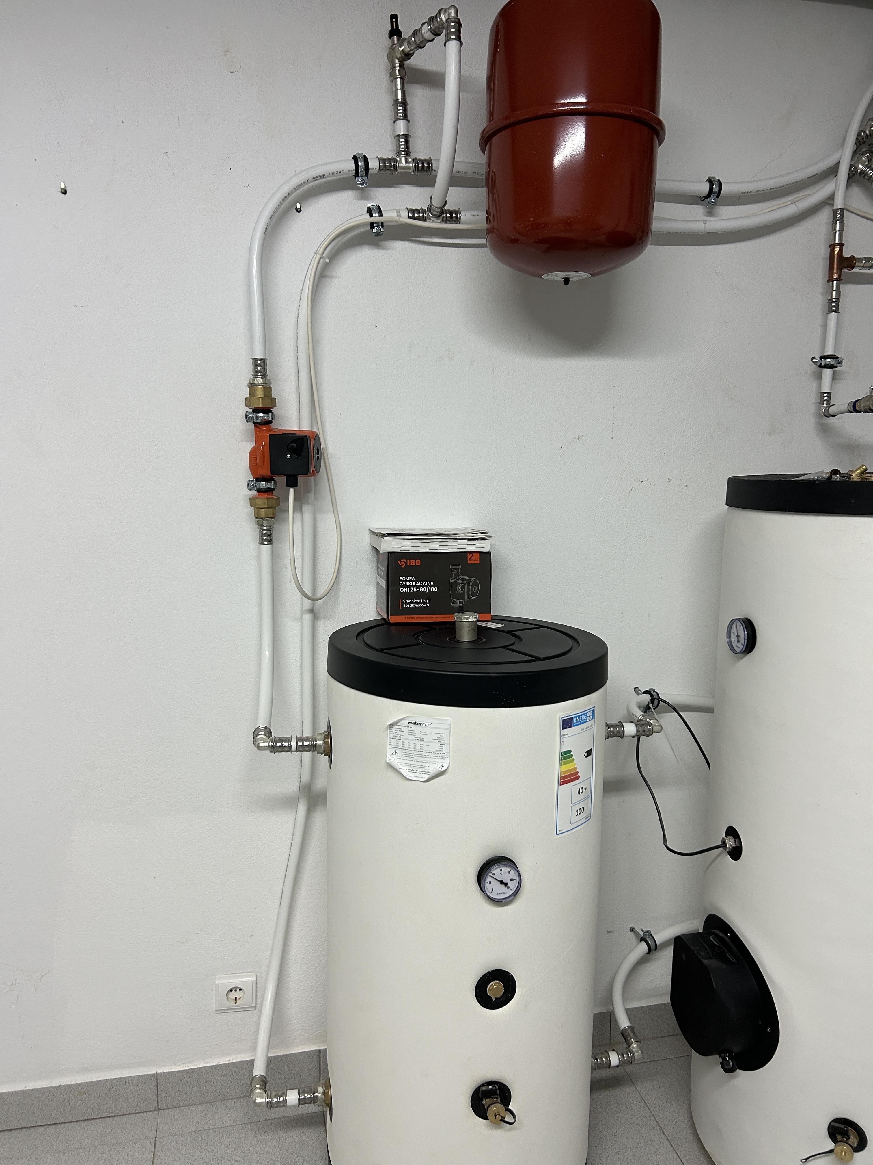

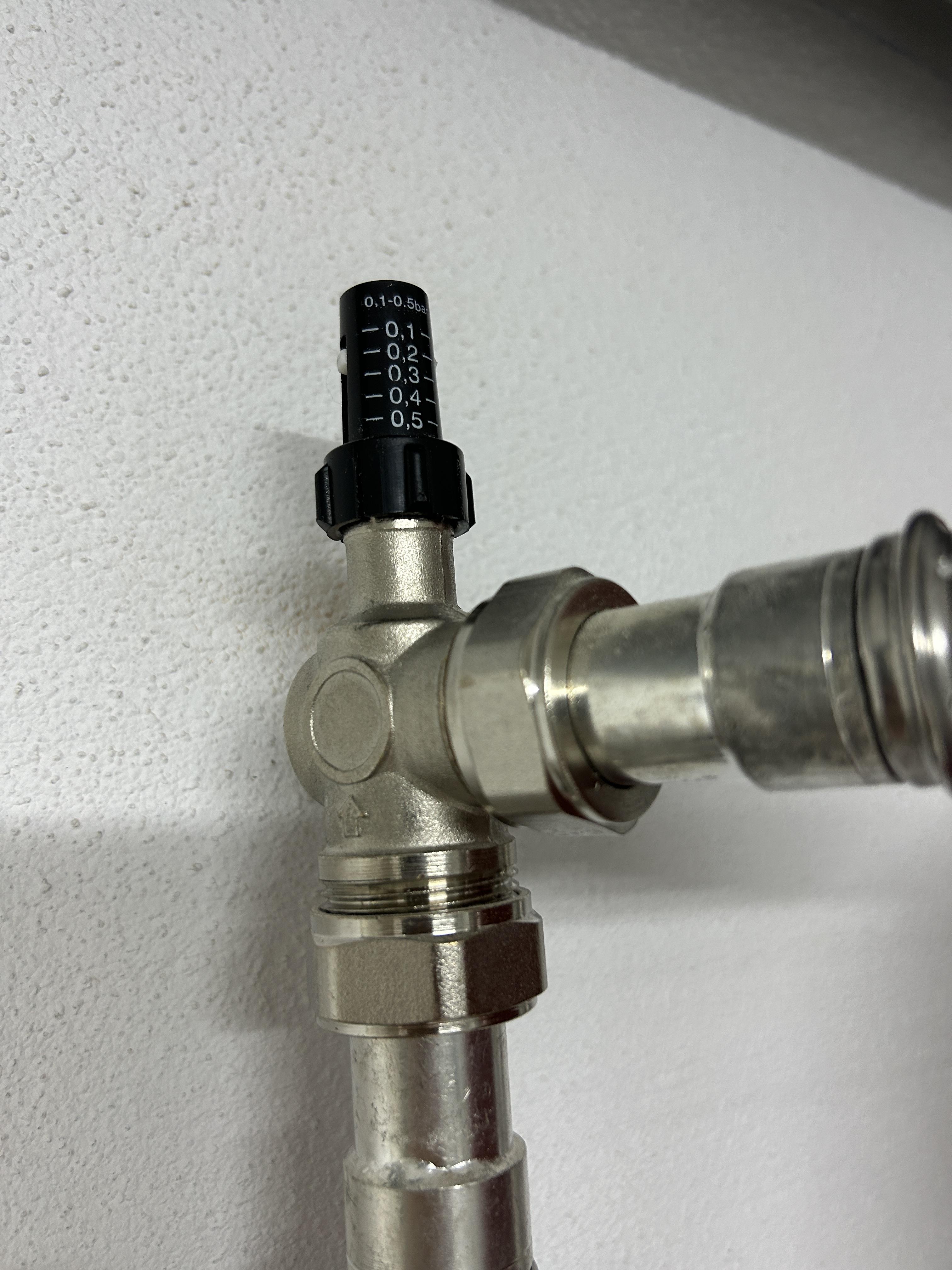

Wingover Posted December 15, 2023 Author Posted December 15, 2023 (edited) On 15/12/2023 at 17:45, JohnMo said: Sounds like a typical 4 port buffer, with a decent mismatch in flow rates, so plenty of mixing going on. Expand I adjusted each loop's flow based on length and it seems that all rooms heat up evenly. What else can I look at? Here are two pictures of the setup. What is the flow control valve? should it be adjusted? Edited December 15, 2023 by Wingover
Marvin Posted December 15, 2023 Posted December 15, 2023 (edited) Bypass valve set to about 6 foot head. 30 foot *0.2 = 6foot or 2 meter head. When the pressure to go through the UFH reaches over the 0.2 bar the valve will open and the water will circulate through the bypass valve. Edited December 15, 2023 by Marvin clarification
Wingover Posted December 15, 2023 Author Posted December 15, 2023 On 15/12/2023 at 17:57, Marvin said: No internal pipe insulation?? Expand From the ceiling and up yes. I haven't insulated the pipes from the tank to the ceiling. I will. Is the valve set correctly? The upstairs manifold is 3.8 meter above the orange pump in the picture.
JohnMo Posted December 15, 2023 Posted December 15, 2023 3.8m.is .38bar, plus piping pressure losses, so it's likely the pump is just pushing the bypass open. You should be able to here it passing. Get everything up and running and slowly increase the setting until you cannot hear it passing. You should also adjust pump speed, reduce setting until flow rates at the UFH drop a little. 1
Wingover Posted December 15, 2023 Author Posted December 15, 2023 On 15/12/2023 at 18:08, JohnMo said: 3.8m.is .38bar, plus piping pressure losses, so it's likely the pump is just pushing the bypass open. You should be able to here it passing. Get everything up and running and slowly increase the setting until you cannot hear it passing. You should also adjust pump speed, reduce setting until flow rates at the UFH drop a little. Expand I can hear the water slowly flowing past the bypass valve right now. If I increase (turn towards the 0.50) a little I can hear it flowing much more. I should not hear any flow?? I adjusted the pump to the mid flow setting. Less and the head pressure is at 2.7 meter and flow is way too low. 1
JohnMo Posted December 15, 2023 Posted December 15, 2023 On 15/12/2023 at 18:27, Wingover said: I can hear the water slowly flowing past the bypass valve right now. If I increase (turn towards the 0.50) a little I can hear it flowing much more. I should not hear any flow?? I adjusted the pump to the mid flow setting. Less and the head pressure is at 2.7 meter and flow is way too low. Expand In normal operation you shouldn't hear bypassing water, as the UFH starts to close down, it should start to open. The valve volume increases as the valve is just about closed, then goes silent once completely closed. Sounds like your pump setting was ok. 1
Wingover Posted December 15, 2023 Author Posted December 15, 2023 Okay, so if I am hearing water flowing past the valve while all zones are open, there is an issue with that valve?
Marvin Posted December 15, 2023 Posted December 15, 2023 (edited) On 15/12/2023 at 18:39, Wingover said: Okay, so if I am hearing water flowing past the valve while all zones are open, there is an issue with that valve? Expand Only in as much as it might need turning to 0.3 or further. ( change the valve a bit and wait a while to see the result, by turning the black top clockwise when viewed from above). If you still hear water passing then perhaps turn a little more, doing this when ALL zones are open. Edited December 15, 2023 by Marvin further thoughts
Wingover Posted December 15, 2023 Author Posted December 15, 2023 (edited) On 15/12/2023 at 18:47, Marvin said: Only in as much as it might need turning to 0.3 or further. ( change the valve a bit and wait a while to see the result, by turning the black top clockwise when viewed from above). If you still hear water passing then perhaps turn a little more, doing this when ALL zones are open. Expand Okay, all zones are open and I turned it to the 0.3 and now I don't hear a flow. Could that have been my buffer tank mixing issue? Edited December 15, 2023 by Wingover

Marvin Posted December 15, 2023 Posted December 15, 2023 On 15/12/2023 at 18:55, Wingover said: Okay, all zones are open and I turned it to the 0.3 and now I don't hear a flow. Could that have been my buffer tank mixing issue? Expand Er... When the bypass valve is closed, the water from the pump goes more forcefully to all the zone valves. If any zone valves are open the water will flow through the zone. If they are all closed the pumping will cause the pressure to rise and the pumped water will go through the BYPASS valve as a way out (assuming its not tightened down too much) Some pumps show what pressure they run at, and that pressure has to be taken into consideration when setting the bypass. HOWEVER @JohnMo is right - wait and see what the result is.
