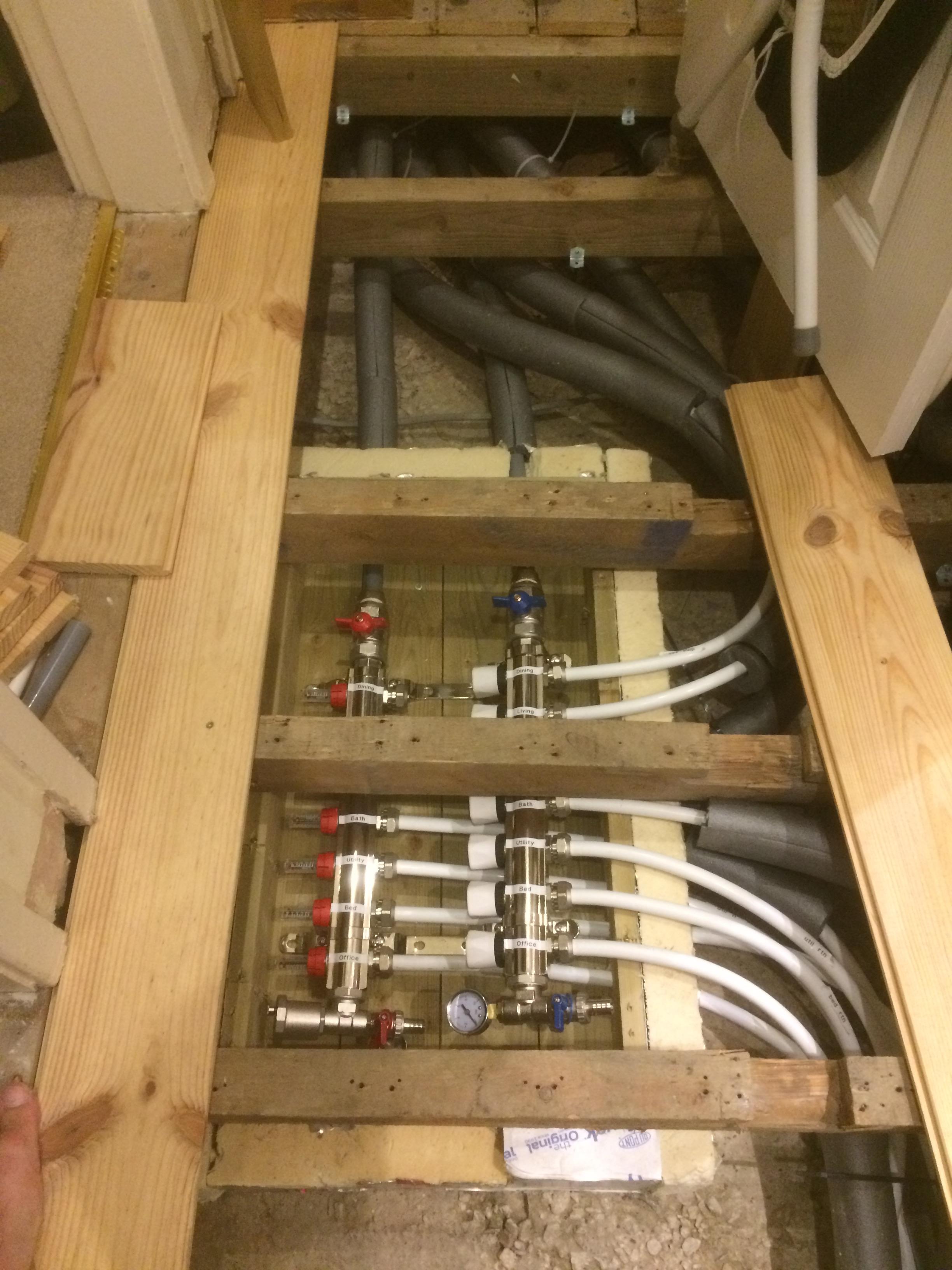

all my stuff came from psw trade suppliers, the eurocones (brass coloured) have just one external sealing ring, making it a perfect fit for a TRV - https://pswtradesuppliers.co.uk/brass-compression-fittings/92-117-16mmx34-eurocone-adapter.html#/39-pack_of-1
another bonus is no press fit, it’s all compression but works an absolute dream.

yeah, stainless steel, not had any issues, was easy enough to install even in the tight space I had for use (under the floor in a small hallway).

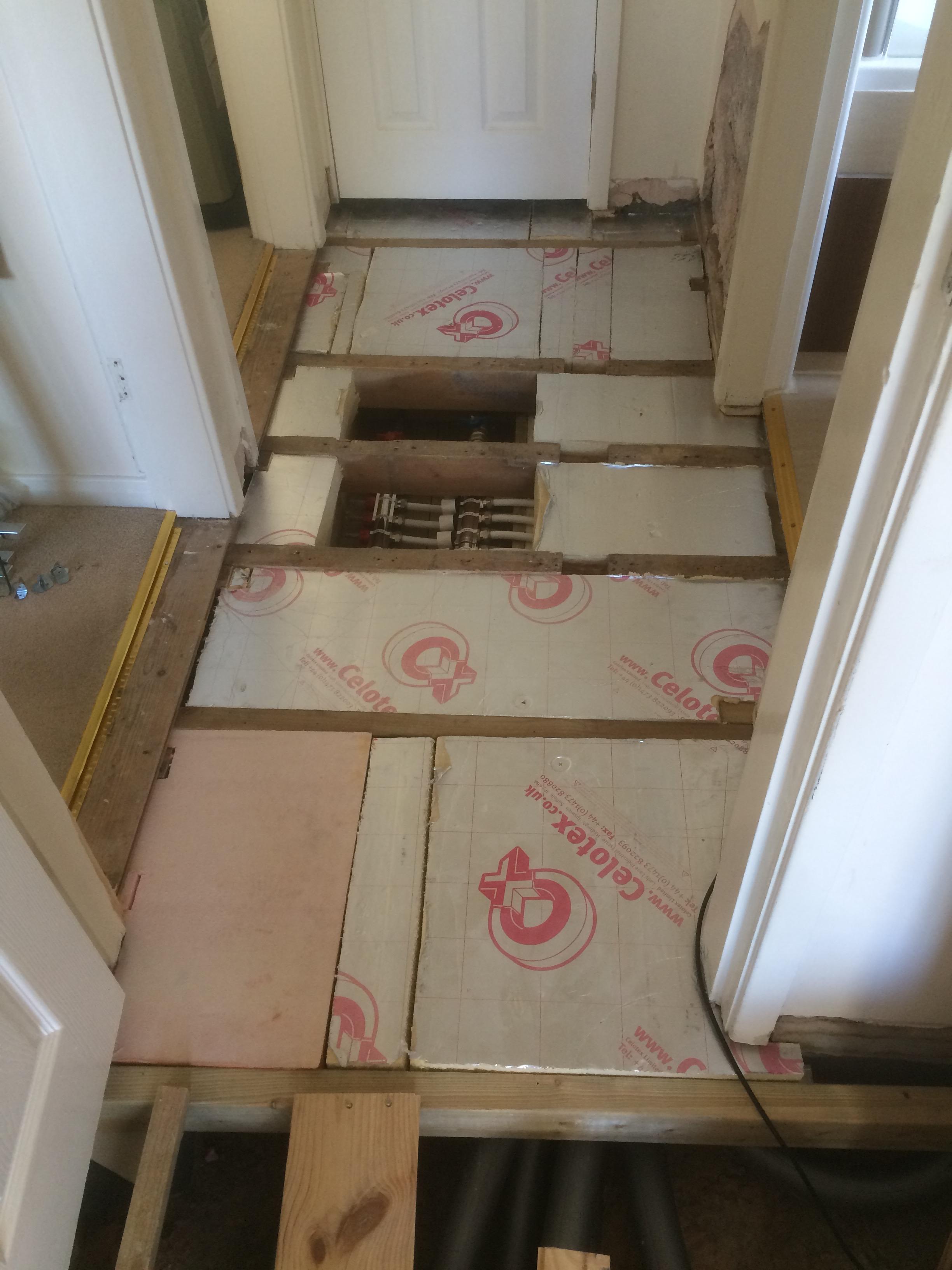

Found this from an old PM:
I found from the kit I used there were 2 types of cone, one which has a double seal on the opposite end to the 16mm connection and one which has a single seal, the single seal ones fit perfectly in a 15mm TRV thus converting it to 16mm without any hassle.
some very old photos too before I finished the floor
