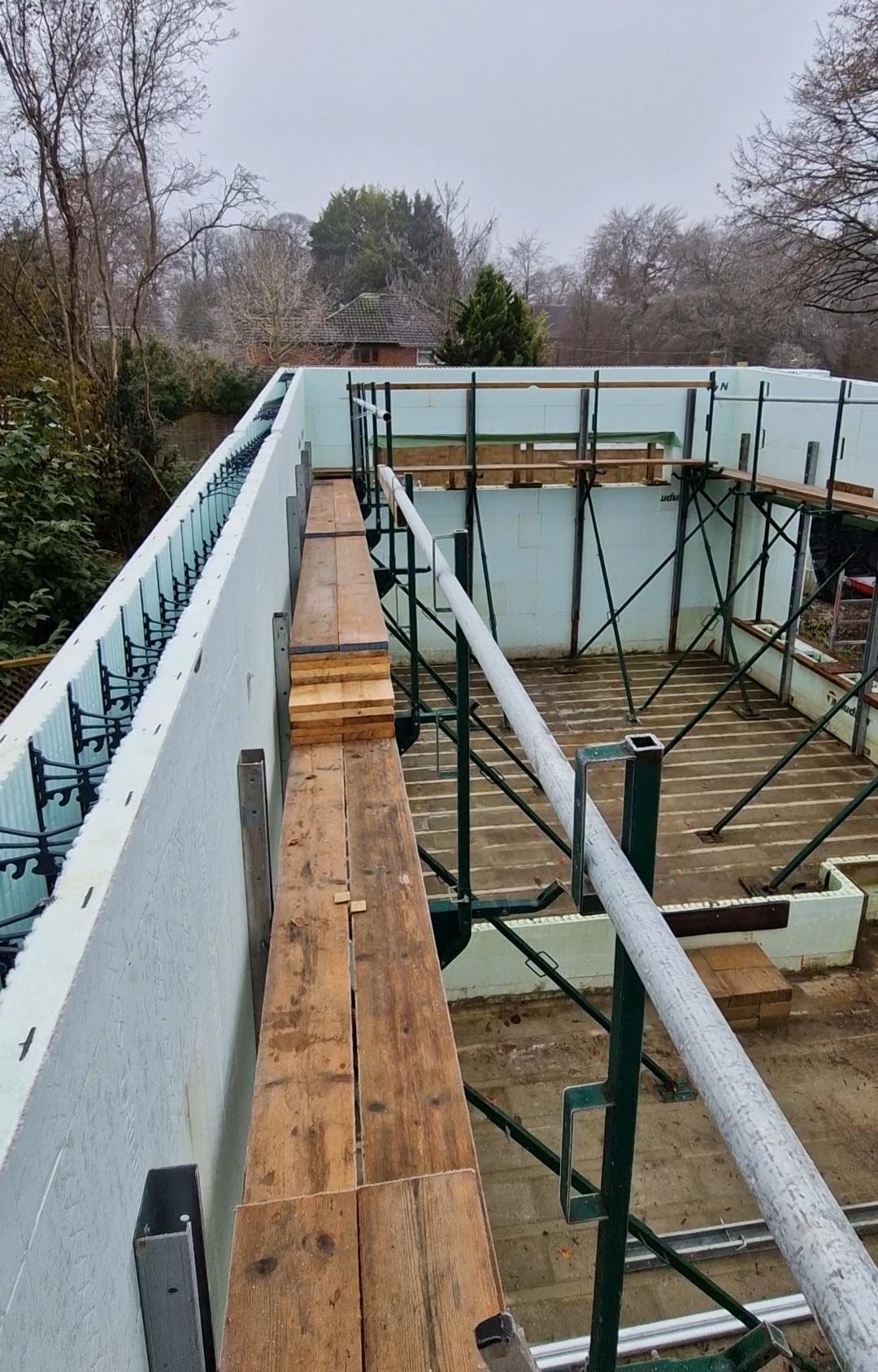

I've built my Nudura walls up to full plate height, with the idea that the Wall-plate will be installed along with the concrete and will match that height, essentially leaving the insulation all the way up.
However, the plywood deck will, I assume, be attached on top of the Posis and oversail onto the Wall-plate. So, how best to fix it?
I think my favourite way at the minute is to use Coach Bolts with the heads recessed into the Wall-plate, bolted on the back, then with a Nut/Washer/Nut at the bottom of the thread to anchor it if necessary. This would be pressed into the wet concrete and aligned with a laser/string. Of course I would not be able to cram the Wall-plates down once the concrete is cured, but is this necessary?
Float the concrete to the right height. Let it set. Then fix the wall plates down after using LONG concrete bolts or chemical resin bolts. I think the bolts our guys used were something like M12, 200mm long. His impact wrench was bigger than my SDS drill! He had had the face of the timber machined to the roof angle. Also left the insution on the inner leaf higher than required, it was.later.trimmed down to the tight height, again, matching the roof angle. Meant less filling on the inside.
Edited by Conor
Engineer to approve, but your posijoist system will complete the diaphragm of the structure, typically you have straps on top of the posijoist which too will flyover the top of the ICF and need fastening to the top of the ICF wall. Your plywood can simply flyover for a smooth surface for the roofing membrane to be on. I'd suggest leaving the posijoists 5mm higher then the ICF wall, no one gets the concrete perfectly flat or smooth for the plywood to sit accurately on, laydown a nice spread of spray foam before putting each sheet of plywood over and then use some concrete screws to fasten the edge to the concrete, just snug them, don't over tighten to distort or skew the plywood. once the spray foam has cured, trim any extra that has expanded past the face of the exterior ICF wall
Looking at your picture, the angle of the ICF cut, embedding a 6x2 to be flush with the top of the ICF will be almost impossible as the webs are in the way in several spots, if you cut them to make proper space, you will need to do additional bracing prior to pour so as the ICF block doesn't flare out from the concrete pressure during the pour

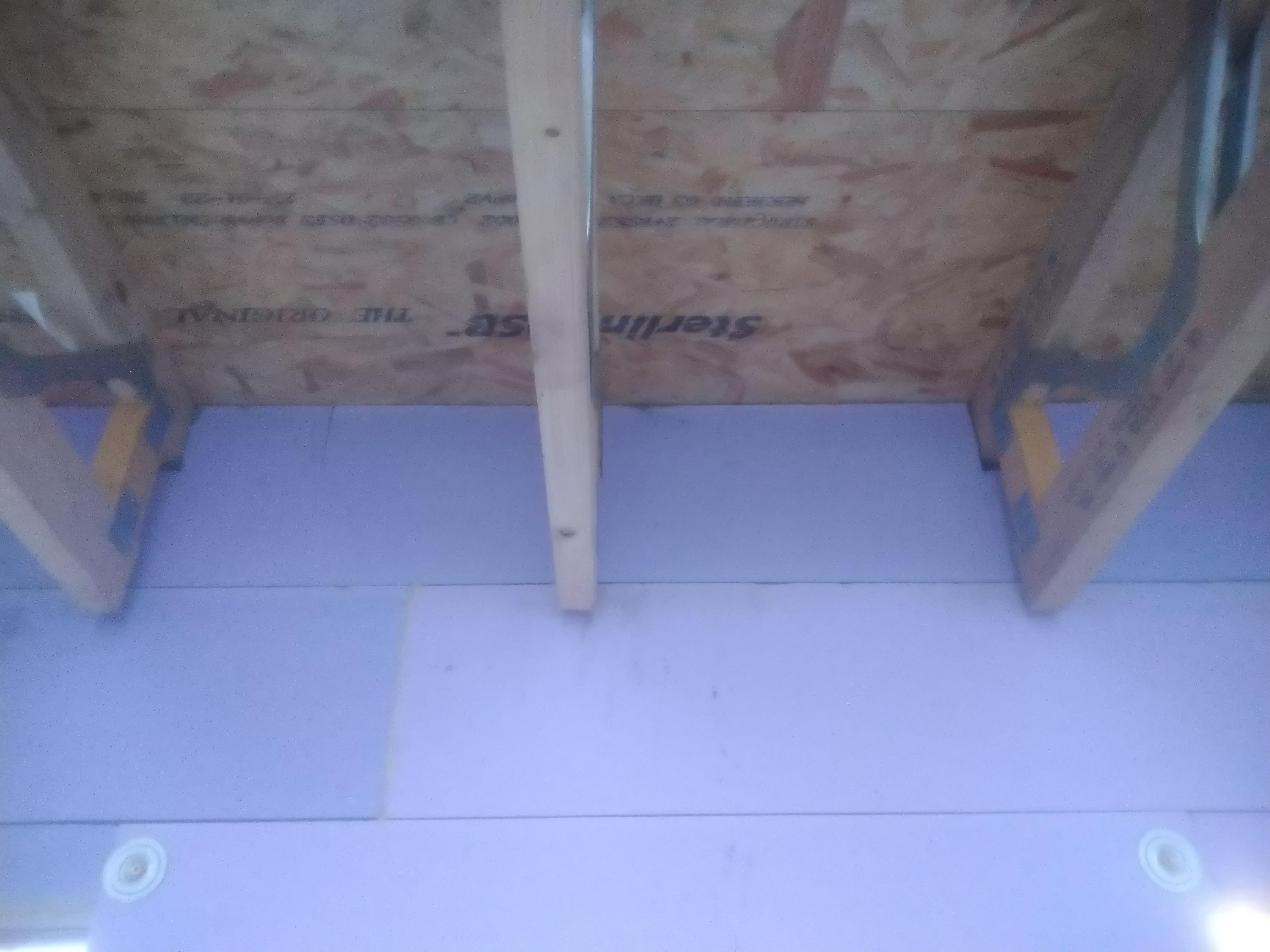

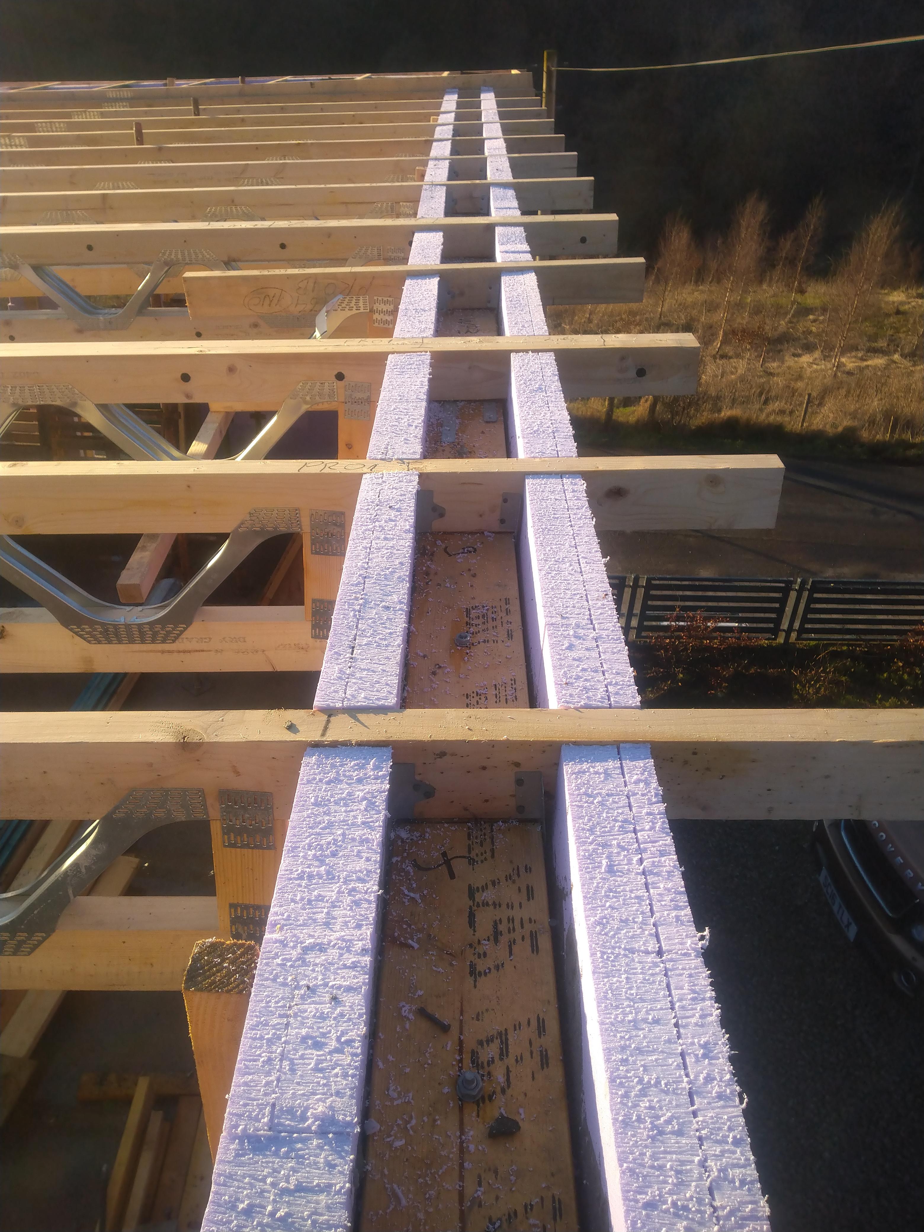

We did something similar. The first time, we laid the wallplate on the poured concrete, this time we simply got the level and them secured the wallplate using resin bolts. As you can wee, we'd left enough ICF to be trimmed down flush to the top of the joists, then when the OSB went on, we used air tight foam, as well as between the joists and the ICF.
That looks good and not entirely different from my setup. I do not have a soffit as such, so do not have the oversailing timbers.
As far as you having installed the wall-plates both during and after the pour, which was your preference and why please?
Preference is after. The gables are the tricky bit and trying to get concrete to go off but not too much whilst having it all plumb/straight at the same time and then get a wall plate and j bolts on was stressful. Doing the wall plate post pour was arguably more work (drilling )but was easier to do, and easier to do right.
