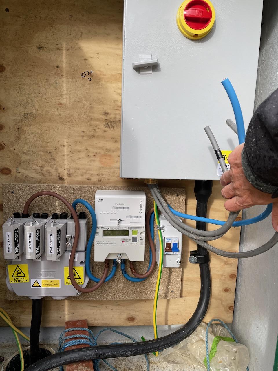

I'm not an electrician and don't know for sure if they'd allow separate fuses and isolator. I bought a 3-phased fused isolator. not cheap and not small either!
https://www.cef.co.uk/catalogue/products/4920299-100a-tp-n-metal-fused-switch
we only have a single phase meter and running the house at the moment but I didn't want to have to upgrade later so just put the 3P fused isolator in from the start. when/if we move to a 3P meter it'll just be a case of connecting the tails to the fused isolator.
