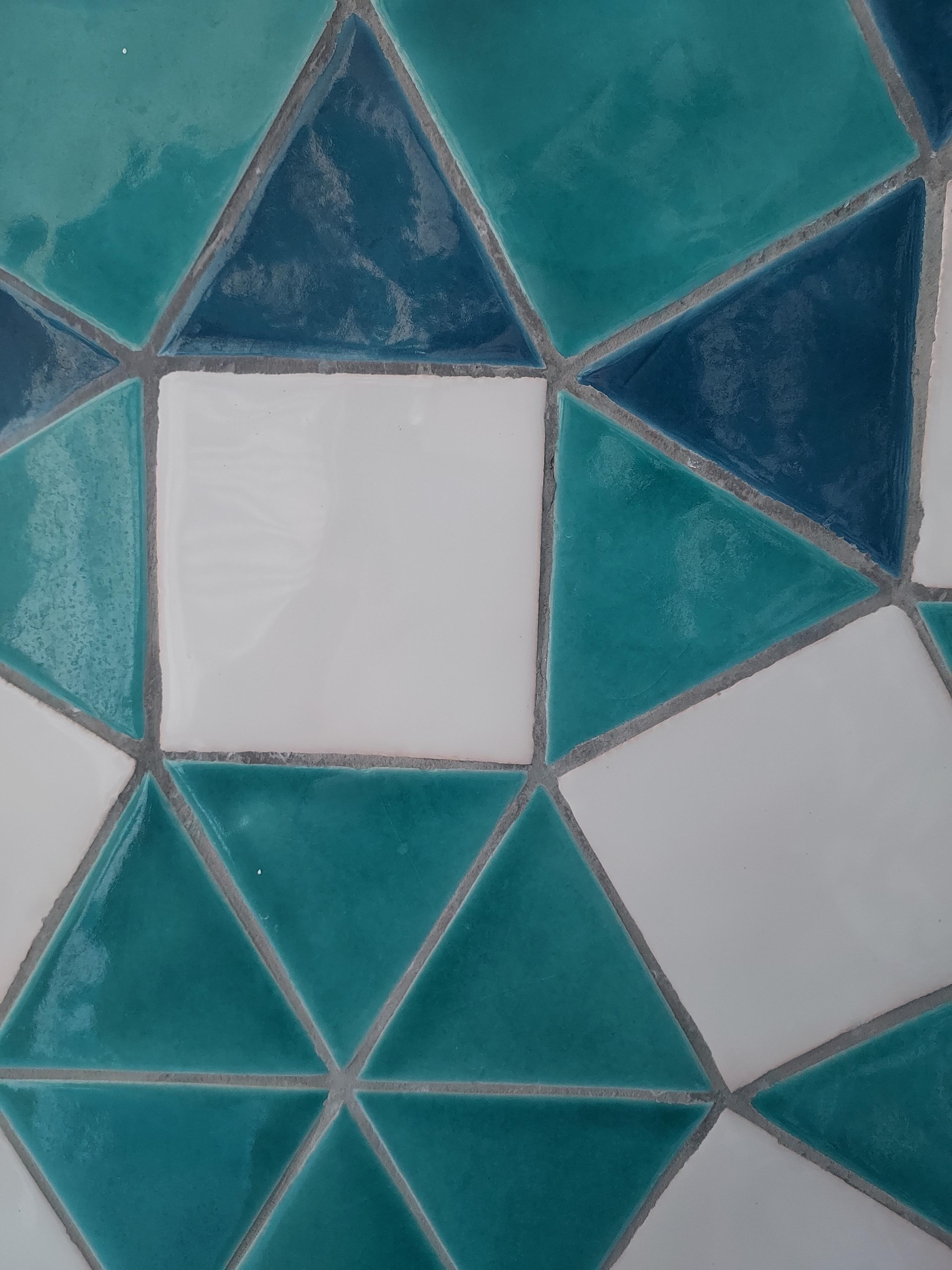

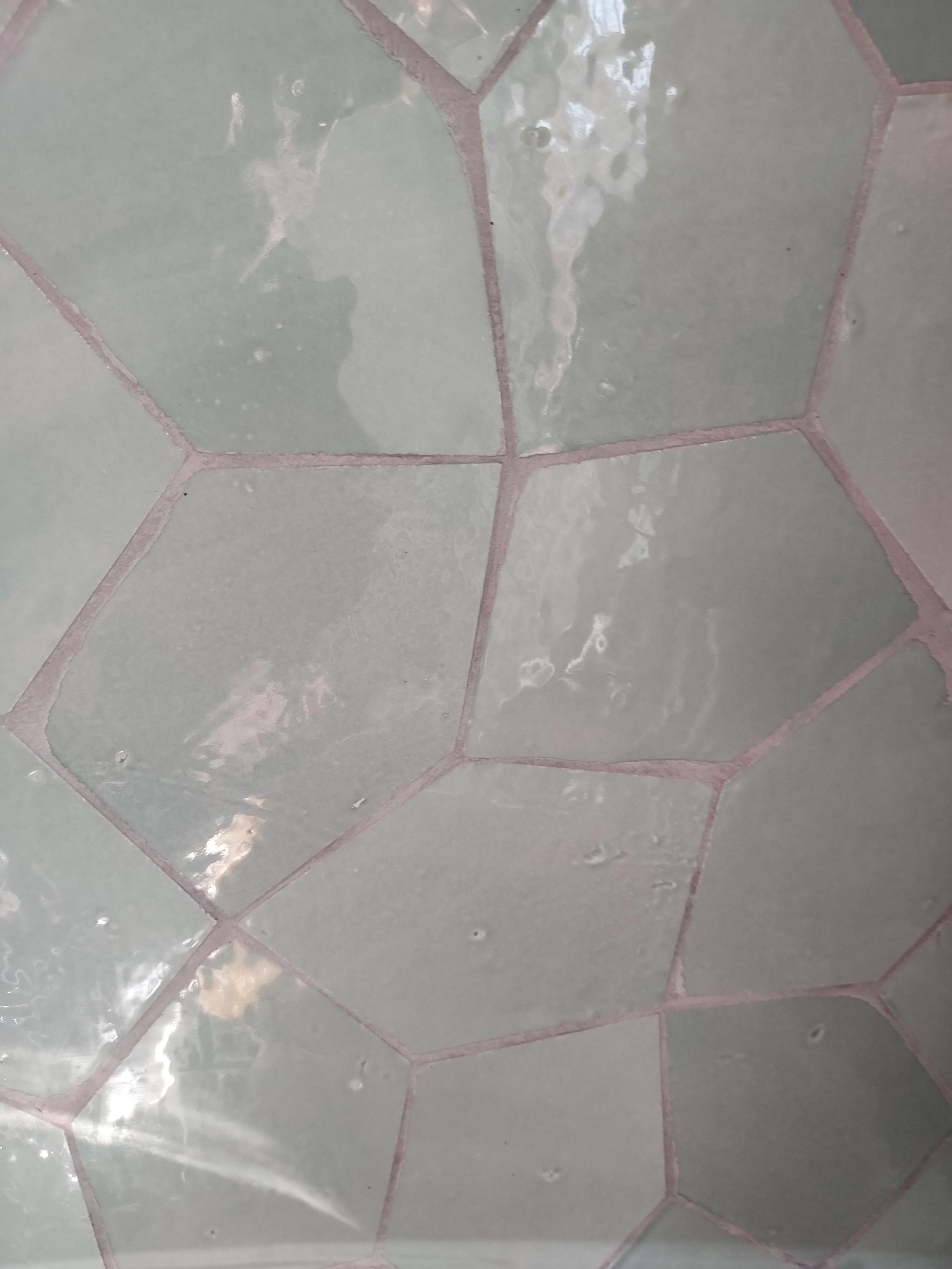

Here is the current state of affairs. It's pretty much indistinguishable from what it was when I looked closely a couple of weeks ago. There's some variation in grout coloring. What obvious problems can you see?
