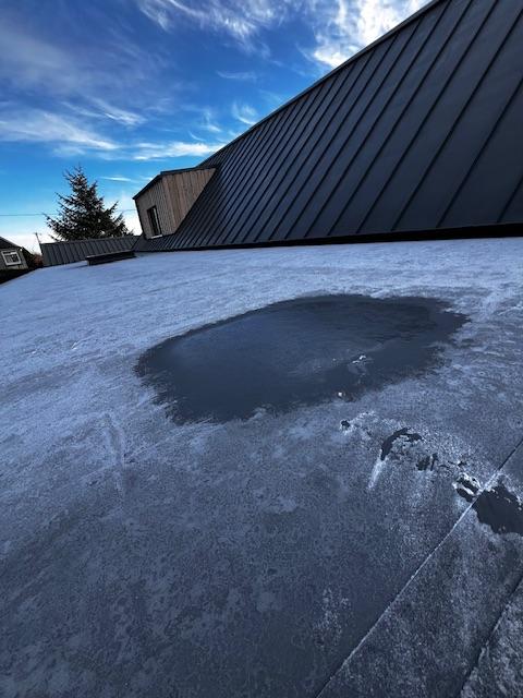

Kelvin Posted December 1, 2023 Posted December 1, 2023 Looks like we have a gap in the insulation in the flat roof. I can’t easily get to this without cutting out area beneath it to find out what the problem is. Should I be concerned about this?
saveasteading Posted December 1, 2023 Posted December 1, 2023 Something is certainly differen there. Is there another cause? Flue nearby, water dripping, something underneath?
Kelvin Posted December 1, 2023 Author Posted December 1, 2023 (edited) No downlights fitted yet. Nothing over hanging it to drip onto it. I thought there was a slight depression in the plywood here a while back when I was up on the roof as I noticed a very slight puddle of water in roughly the same location a few weeks ago. I have four speaker holes cut out in this room and one of them is close to it. It’s not easy to see up inside it with getting a camera in there. Edited December 1, 2023 by Kelvin
