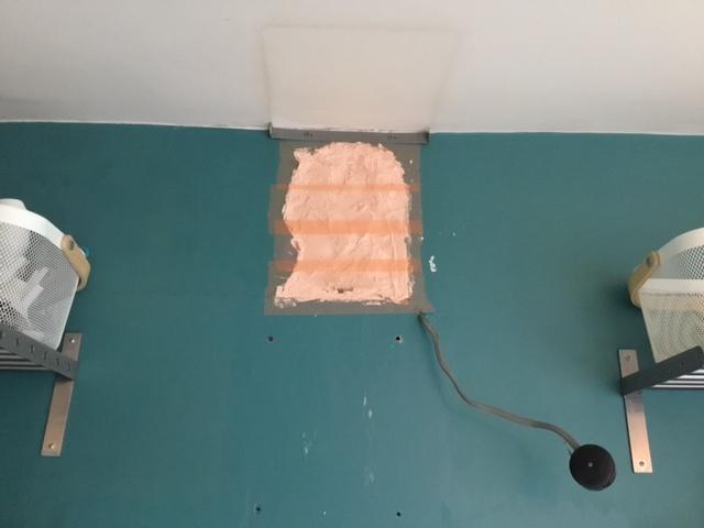

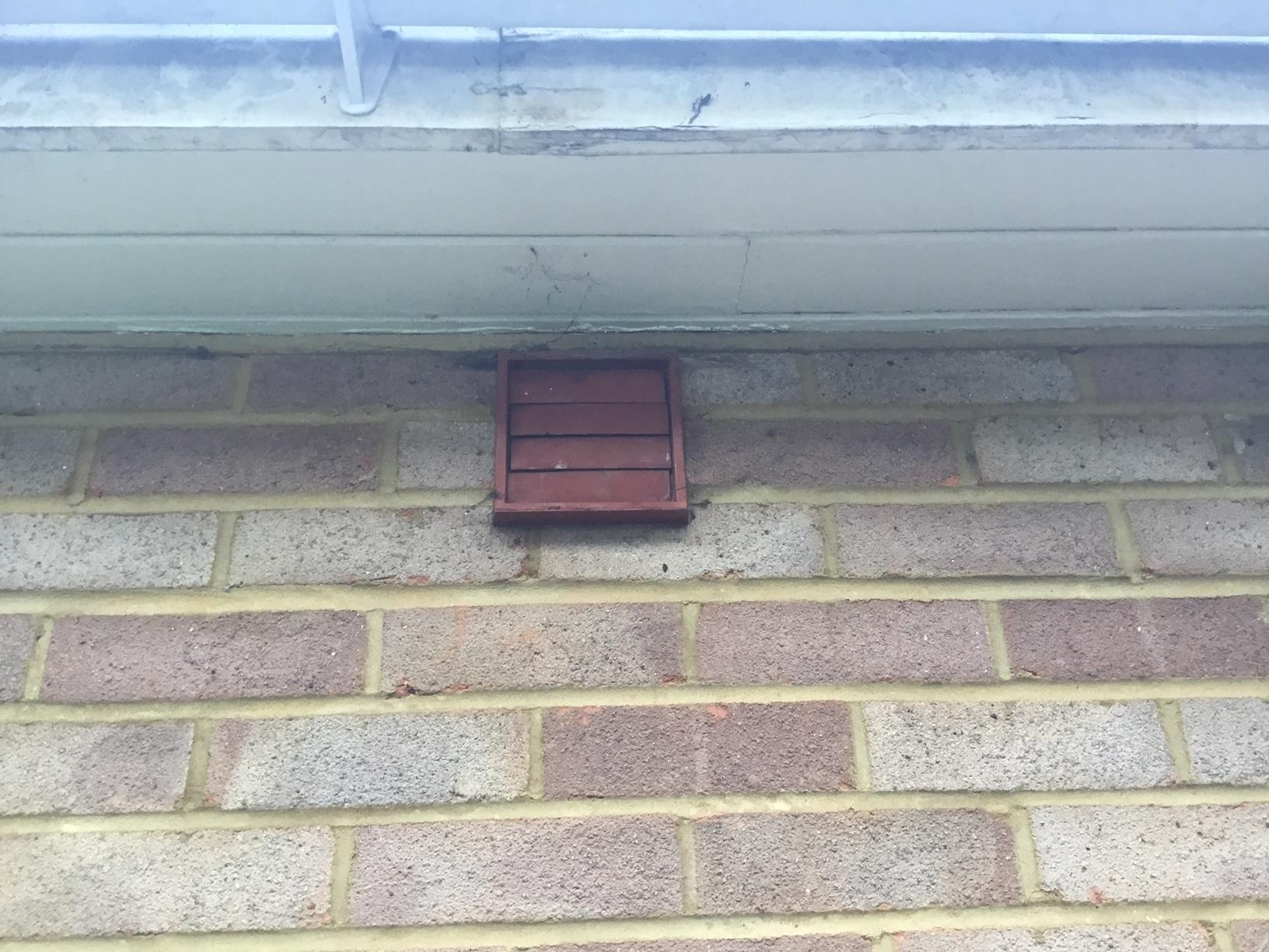

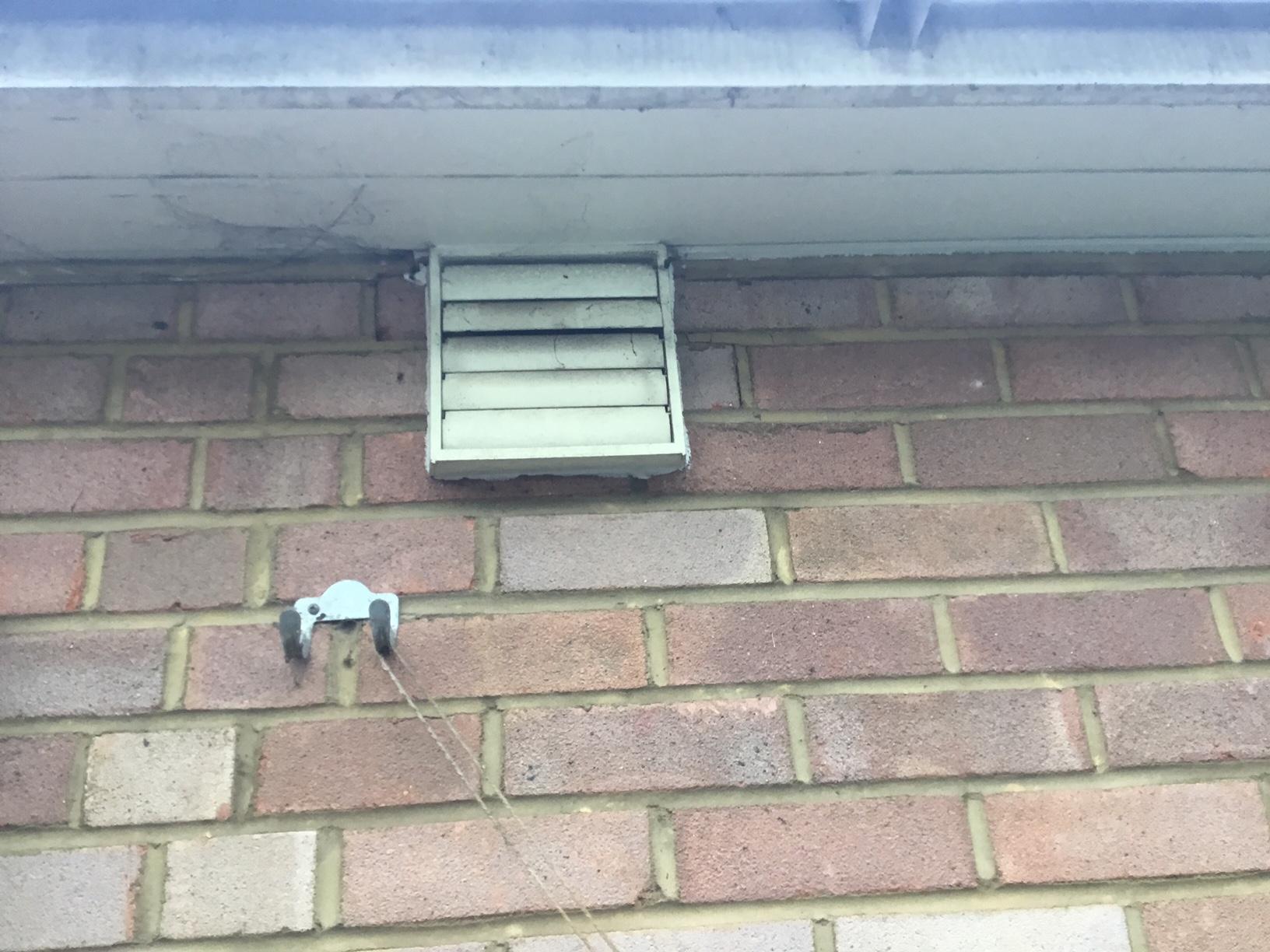

Novice Becky Posted November 30, 2023 Share Posted November 30, 2023 Question from a novice (not sure where to post this). How would you go about blocking up 3 extract fan vents? 2 bathroom extracts (100mm) and 1 kitchen extract (150mm) - I'm having an MVHR system installed next week (retrofit) so I want to remove and block up these 3 vents. (Obviously I'll work on airtightness elsewhere) - Walls are brick and block. - Bungalow so it's all accessible - I'll then have the failed CWI extracted and replaced with EPS beads - overall objective of retrofit is to get rid of condensation and make my home more sustainable (use less energy) Do I need to try and leave a cavity? Would people just use expanding foam? How do I prevent a thermal bridge? Any recommendations of products please? The vents are close to the soffits. Link to comment Share on other sites More sharing options...
Conor Posted November 30, 2023 Share Posted November 30, 2023 Remove everything and brick up the hole, with bricks. Link to comment Share on other sites More sharing options...
markc Posted November 30, 2023 Share Posted November 30, 2023 If you don’t mind the grills being there, remove grill, pull out the sleeve and fill with foam, trim face flat and refit grill. if you want better aesthetics then it’s brick replacement Link to comment Share on other sites More sharing options...
Novice Becky Posted November 30, 2023 Author Share Posted November 30, 2023 Thanks @Conor. Would I remove bricks that aren't whole bricks and replace with a new whole brick? What would you do on the internal wall? Link to comment Share on other sites More sharing options...
Novice Becky Posted November 30, 2023 Author Share Posted November 30, 2023 Thanks @markc. Would I fill the entire space with foam, so from the internal to external wall? what foam would you use? Are some expanding foams more insulating? Link to comment Share on other sites More sharing options...
markc Posted November 30, 2023 Share Posted November 30, 2023 One of the best foams by far ilbruk FM330 foam. No problem with going full wall thickness but depends what the finish is inside, if plaster/plasterboard then put a piece in first and you can foam up behind it, externally brick is best but would require taking out any damaged bricks, hopefully 2 but could be 4 and replacing otherwise you end up with a horrible circular patch Link to comment Share on other sites More sharing options...

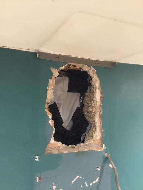

Novice Becky Posted December 17, 2023 Author Share Posted December 17, 2023 Thanks @markc. Apologies, I've been distracted by the MVHR install! That's good to know about illbruk FM330 foam - it's been mentioned on lots of window discussions. I'll try and do the replacing bricks method. If I do this then how do I block up the hole inside? It's a 1960s house so the cavity walls are block on the inside with plaster (not dry-lined). I assume I need to put a patch of plasterboard (or wood?) in the hole, leaving enough space for a coat of wet plaster. But how do you secure and stop the plasterboard patch from falling down the cavity? And does something need to go behind the plasterboard? Once everything else is done I'll be having the CWI sucked out and replaced with EPS beads. One of the bathroom extracts (not in photo) is in the extension so this one is dry-lined on timber studs - I think I'll do this one with foam as it's not visible and not having replacement CWI. I hope this makes sense - I don't know all the correct builder terminology. Link to comment Share on other sites More sharing options...
markc Posted December 17, 2023 Share Posted December 17, 2023 Hi @Novice Becky for the inside use brick or block piece/s and mortar - like the outside but no need to make it look good, then just finish to required level with plaster Link to comment Share on other sites More sharing options...

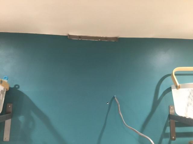

Novice Becky Posted March 14, 2024 Author Share Posted March 14, 2024 @Conor and @markc a belated thank you for your help! I managed to block up my extract vent holes - first time for everything. The cooker hood one was nasty - the builder years ago had hidden his shoddy job and there was a massive double hole to fill. I stuck some ME508 airtightness tape at the back of the inner leaf, filled with FM330 and then plastered over the top. Now all covered up with a new recirculating cooker hood. Cheated slightly on the brick work outside and happened to find a builder to come and brick up the holes. Thanks again. 1 Link to comment Share on other sites More sharing options...
