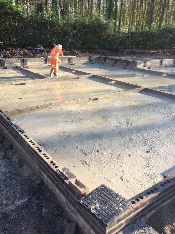

Vijay Posted September 12, 2017 Share Posted September 12, 2017 I need to install air bricks into the internal rising and sleeper walls and wondered if there is any reason I couldn't put them in the bottom course, so directly on top of the foundation concrete? Cheers Vijay Link to comment Share on other sites More sharing options...

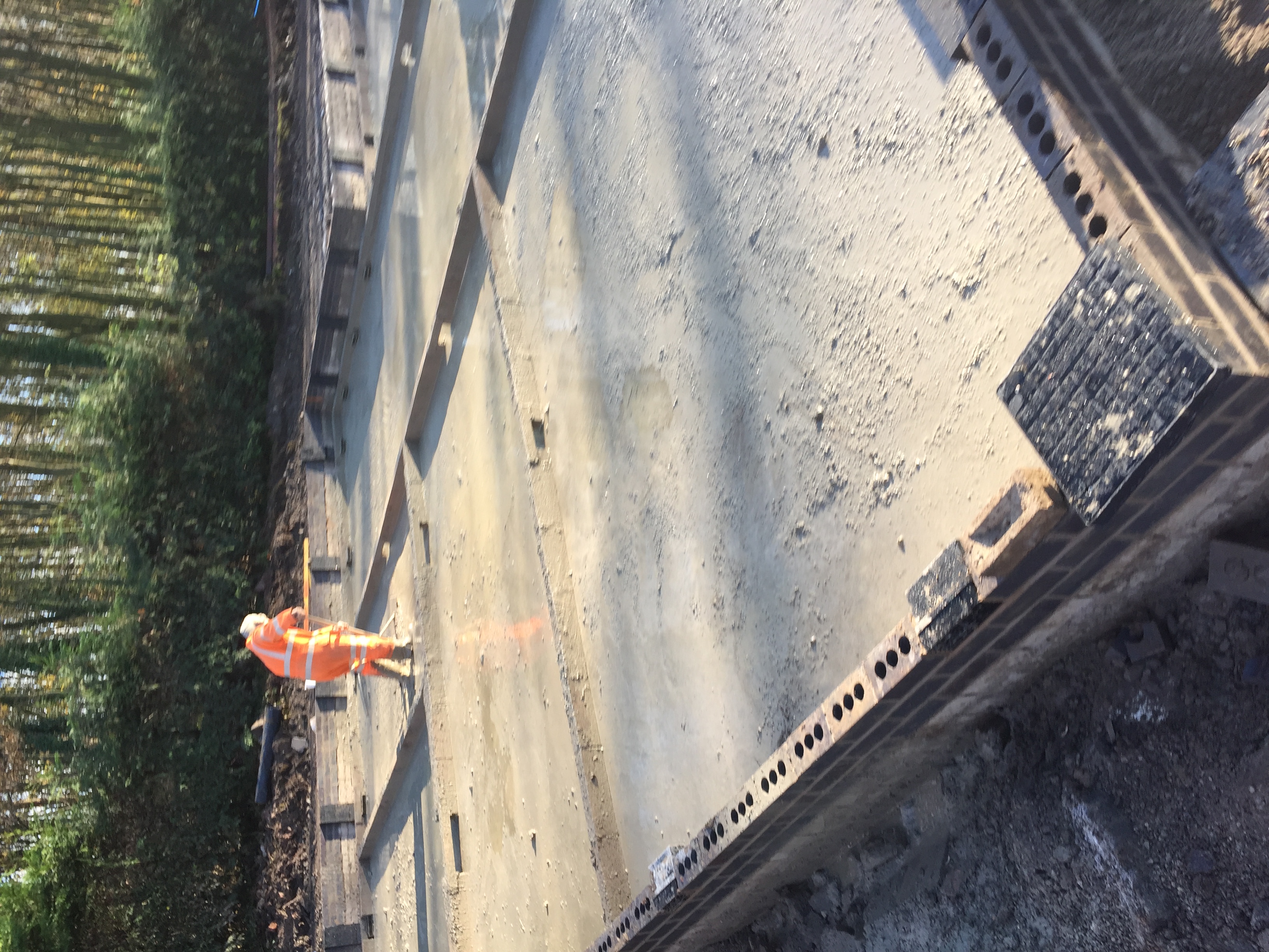

nod Posted September 12, 2017 Share Posted September 12, 2017 13 minutes ago, Vijay said: I need to install air bricks into the internal rising and sleeper walls and wondered if there is any reason I couldn't put them in the bottom course, so directly on top of the foundation concrete? Cheers Vijay I just left a brick out and cut a concrete lintel down to 600 and put it over the missing brick main reason was to allow underfloor ventilation But also so that any water would not be traped and would make its way to a drain under the centre of the B&B floor BC signed it off without ant issues Link to comment Share on other sites More sharing options...

Vijay Posted September 12, 2017 Author Share Posted September 12, 2017 Cheers Nod. I've got about 20 to do so would be much easier to do it with air bricks. Or is there any reason I couldn't use an air brick vertically?? Link to comment Share on other sites More sharing options...
nod Posted September 12, 2017 Share Posted September 12, 2017 22 minutes ago, Vijay said: Cheers Nod. I've got about 20 to do so would be much easier to do it with air bricks. Or is there any reason I couldn't use an air brick vertically?? You will still need to put a lintel in each one Link to comment Share on other sites More sharing options...
Vijay Posted September 12, 2017 Author Share Posted September 12, 2017 even if it's on a bottom course with a block over it??? Link to comment Share on other sites More sharing options...
nod Posted September 12, 2017 Share Posted September 12, 2017 15 minutes ago, Vijay said: even if it's on a bottom course with a block over it??? 16 minutes ago, Vijay said: even if it's on a bottom course with a block over it??? If you have a block over it you'll be fine Mine was only one block high so I had to lay 2 course of brick then a lintel Link to comment Share on other sites More sharing options...
Vijay Posted September 13, 2017 Author Share Posted September 13, 2017 Can I use plastic air vents under the floor or does it have to be terracotta? I can only imagine it would be an issue for rats but they can't exactly go anywhere Link to comment Share on other sites More sharing options...
nod Posted September 13, 2017 Share Posted September 13, 2017 15 minutes ago, Vijay said: Can I use plastic air vents under the floor or does it have to be terracotta? I can only imagine it would be an issue for rats but they can't exactly go anywhere As you say Vijay They can't go anywhere I would have preferred to use Clay but plastic vents came with the periscope vents Link to comment Share on other sites More sharing options...

Oz07 Posted September 13, 2017 Share Posted September 13, 2017 On 12/09/2017 at 19:41, nod said: What made you concrete under b&b? Link to comment Share on other sites More sharing options...
nod Posted September 14, 2017 Share Posted September 14, 2017 8 hours ago, Oz07 said: What made you concrete under b&b? The short answer is The engineer I was going to stone it He advised me that in the unlikely event of a flood i would be relying on the water seeping away under the house Leaving sewage under the house So we laid a central drain with six metres of concrete falling towards it it cost me an extra £350 plus half a days labour for two not a fortune in the grand scheme of things Link to comment Share on other sites More sharing options...
