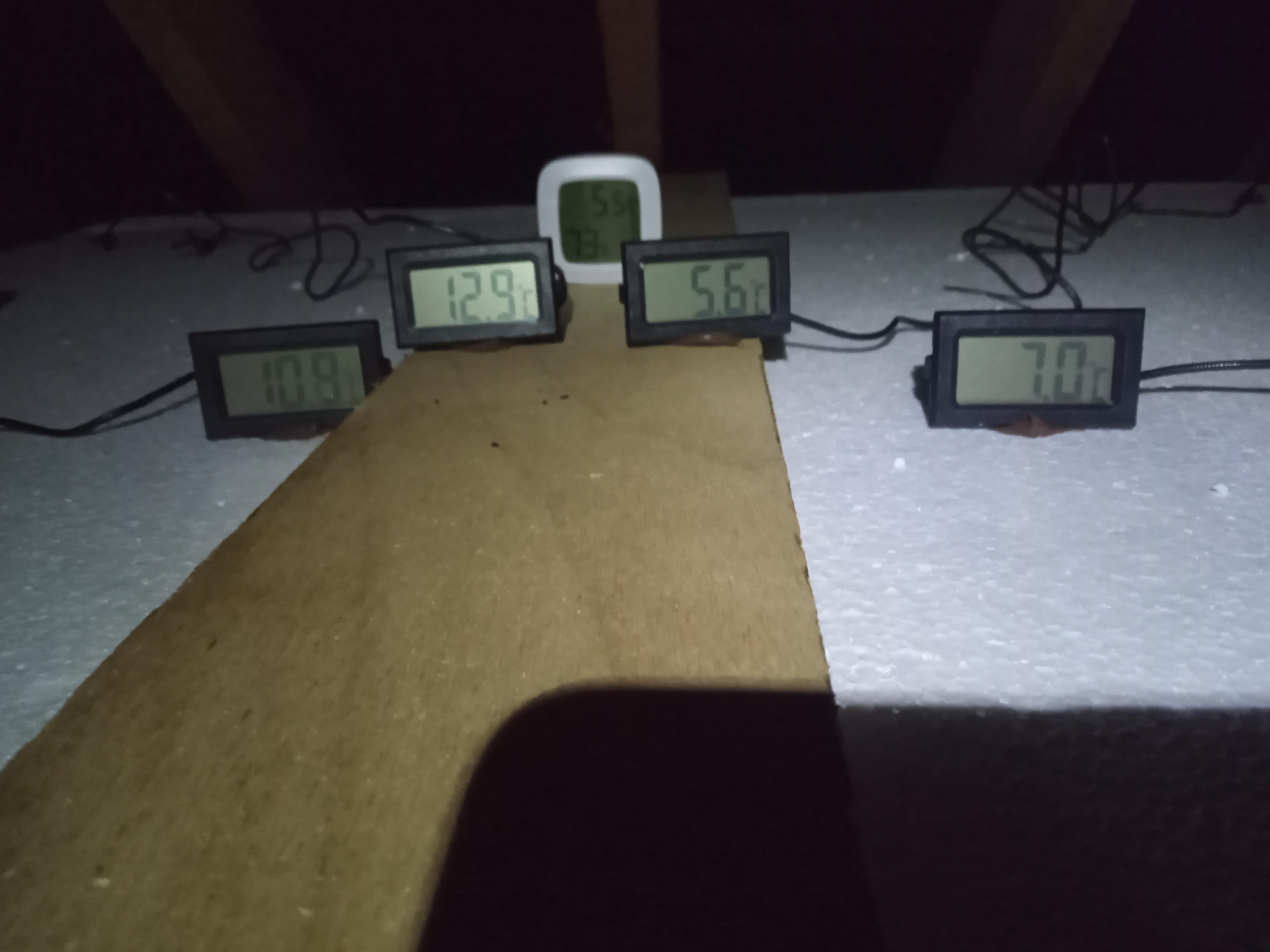

Up and running
I Took a oic this morning.
Which gives
SAP  73.6%
PHI   76.9%
I adjusted the incoming air to within 2,5% of each other. Life is to short to strive for better.

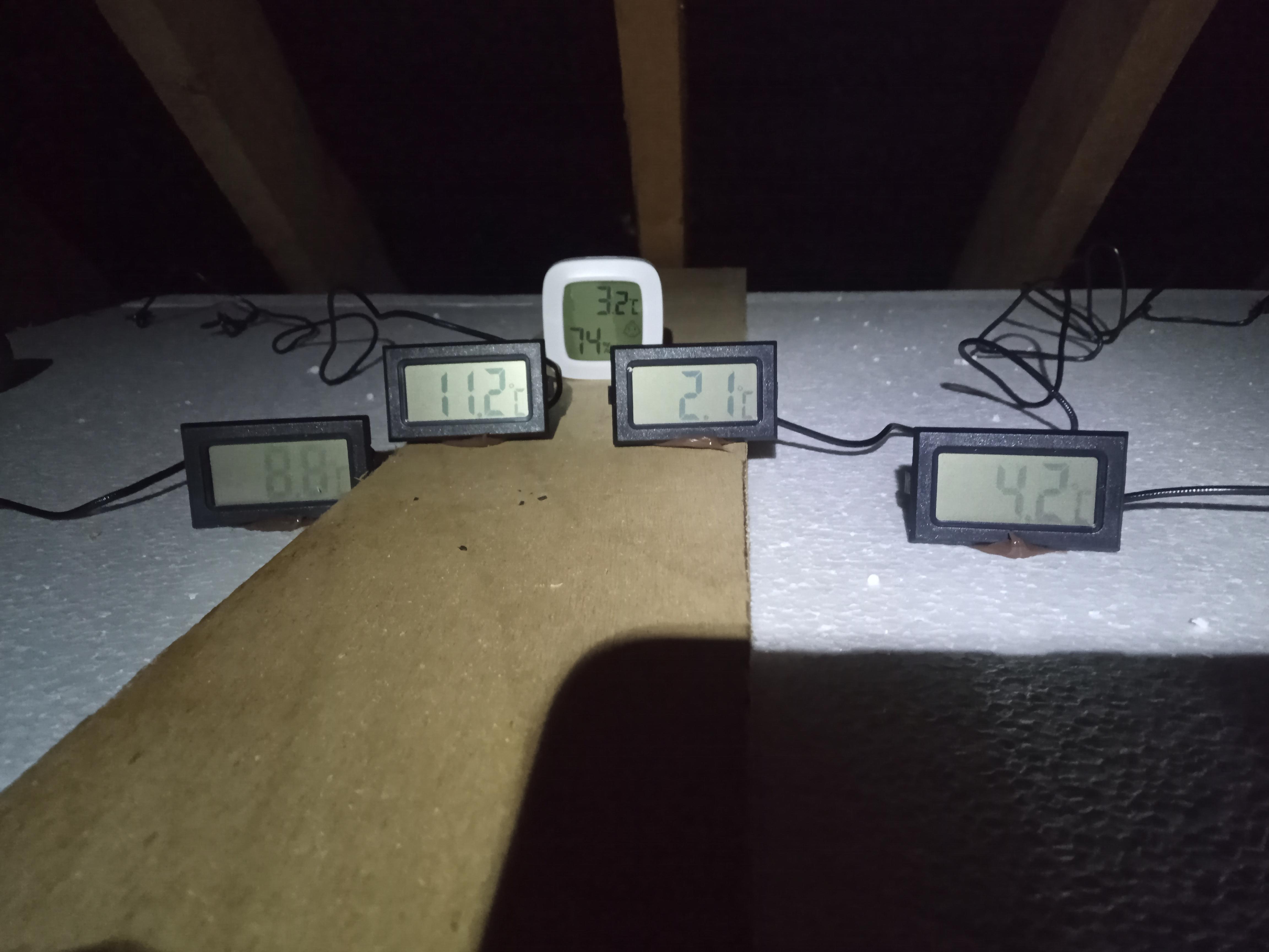

I left things for a few hours and took another.
Which gives
SAP  71.2%
PHI   80.8%
Making the SAP findings a bit lower and the PHI findings a bit higher.
Is it better or worse?
