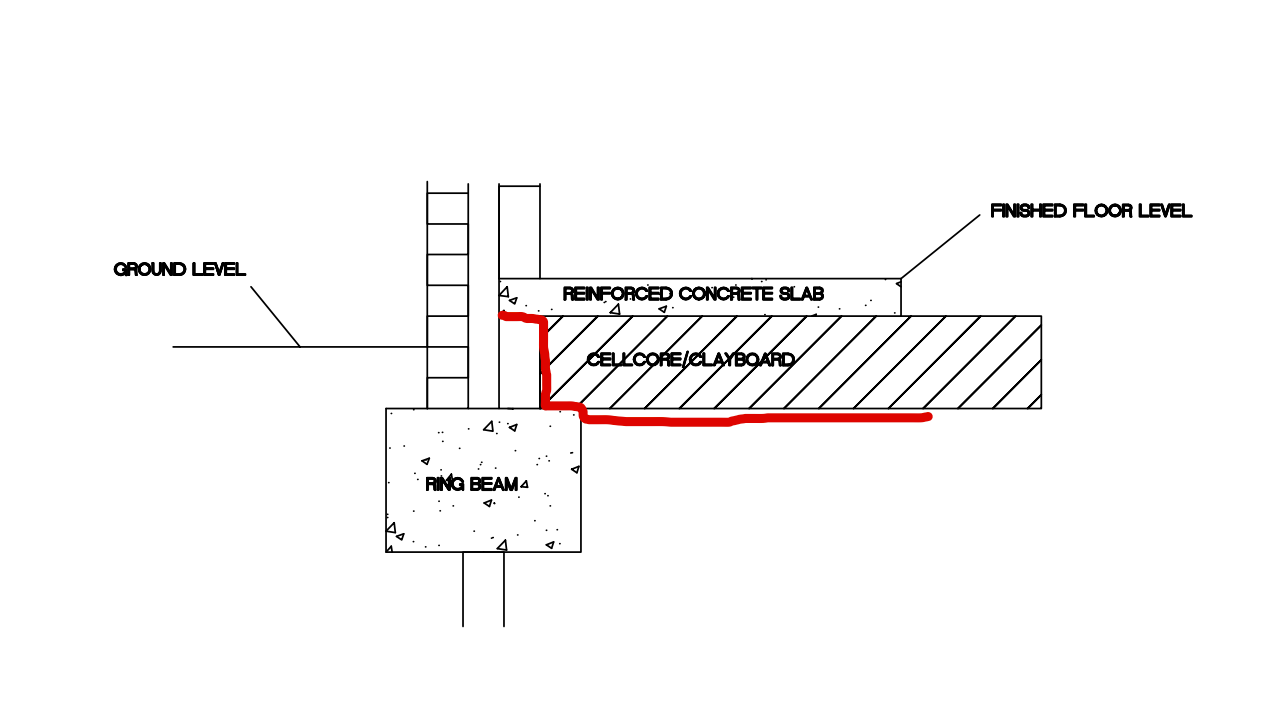

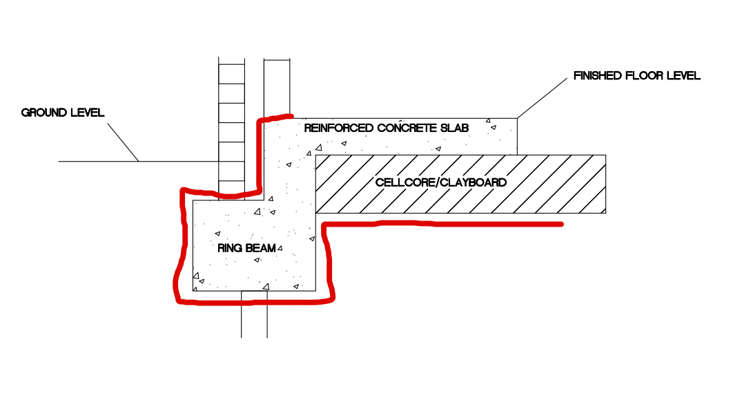

tscalfa Posted November 14, 2023 Share Posted November 14, 2023 Hi everyone, I'm after a bit of advice please. I'm having an attached garage built which due to the ground conditions and proximity to conifers means I've got to have a pile reinforced slab. What is the standard practice for the damp proof membrane, should it go under both the slab and the ring beam as shown by the red line in diagram 1, or should it go between the slab and ring beam as per the red line diagram 2, or is there a third way it should be done? Does the ring beam need to be tied in to the suspended slab as per diagram 1 or is the slab just sandwiched in to the inner leaf in a similar way to a block and beam floor as per diagram 2? Link to comment Share on other sites More sharing options...

kandgmitchell Posted November 14, 2023 Share Posted November 14, 2023 Diagram 2 is going to be easier to damp proof. Diagram 1 would be a nightmare. Check with your engineer that the slab is designed to span off the inner leaf of blockwork and get the blockwork strength confirmed. The dpm should be under the slab because as mentioned the clayboard is crushable in case of heave. Link to comment Share on other sites More sharing options...

tscalfa Posted November 15, 2023 Author Share Posted November 15, 2023 23 hours ago, kandgmitchell said: Diagram 2 is going to be easier to damp proof. Diagram 1 would be a nightmare. Check with your engineer that the slab is designed to span off the inner leaf of blockwork and get the blockwork strength confirmed. The dpm should be under the slab because as mentioned the clayboard is crushable in case of heave. I can see why the 2nd one would be easier but I've seen conflicting information on whether the slab needs to be tied in to the ring beam or not. Link to comment Share on other sites More sharing options...

saveasteading Posted November 15, 2023 Share Posted November 15, 2023 Definitely not as 1). The likely design is that the pile is left high, then cut back with the reinforcement tying into the edge beam. Dpm would interfere with bonding. No dpm is necessary as the concrete is (make sure it is) very dense. Neither option shows any insulation. Anyway, under the slab and tucked into the wall seems right to me. 1 Link to comment Share on other sites More sharing options...
