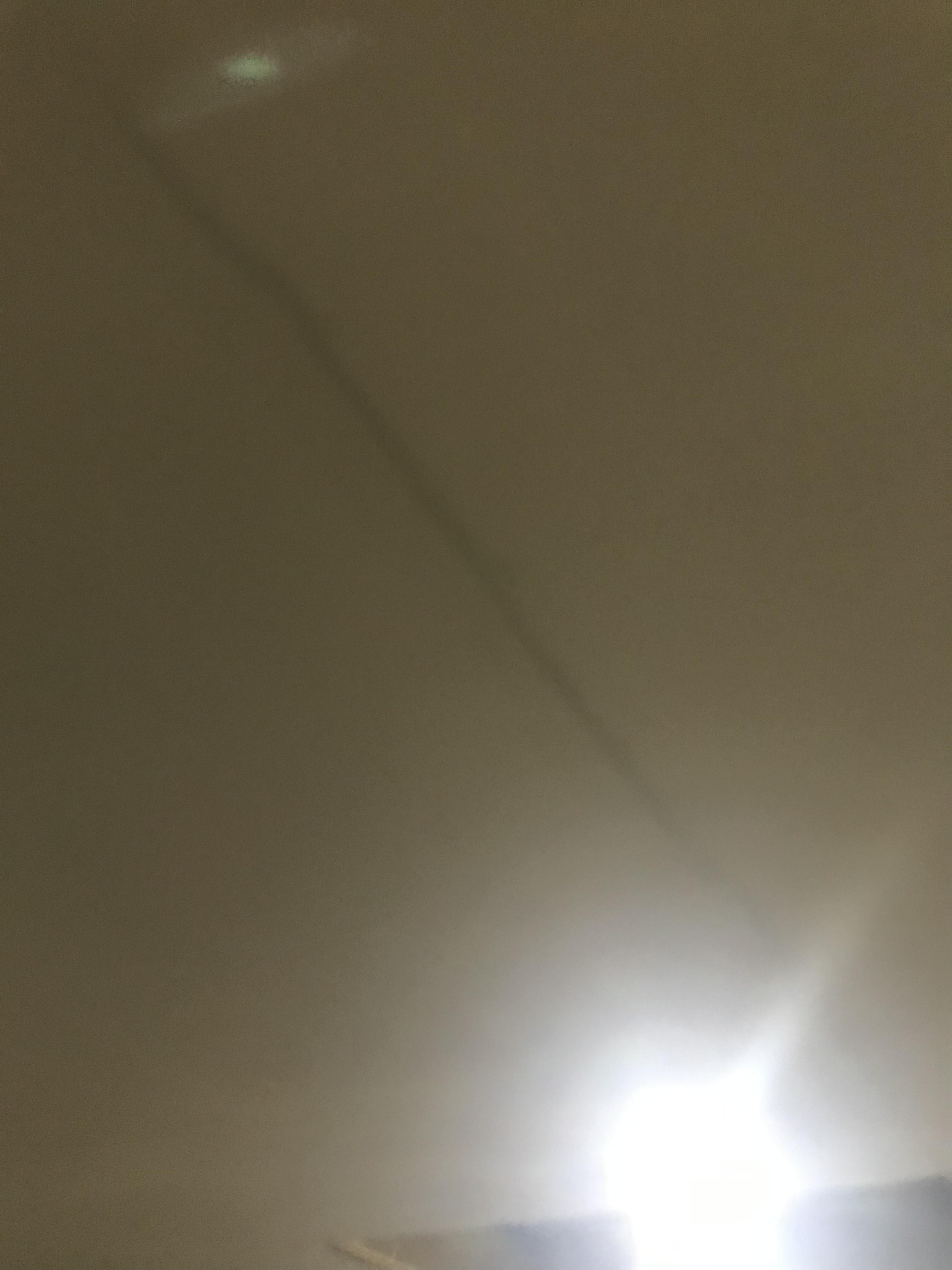

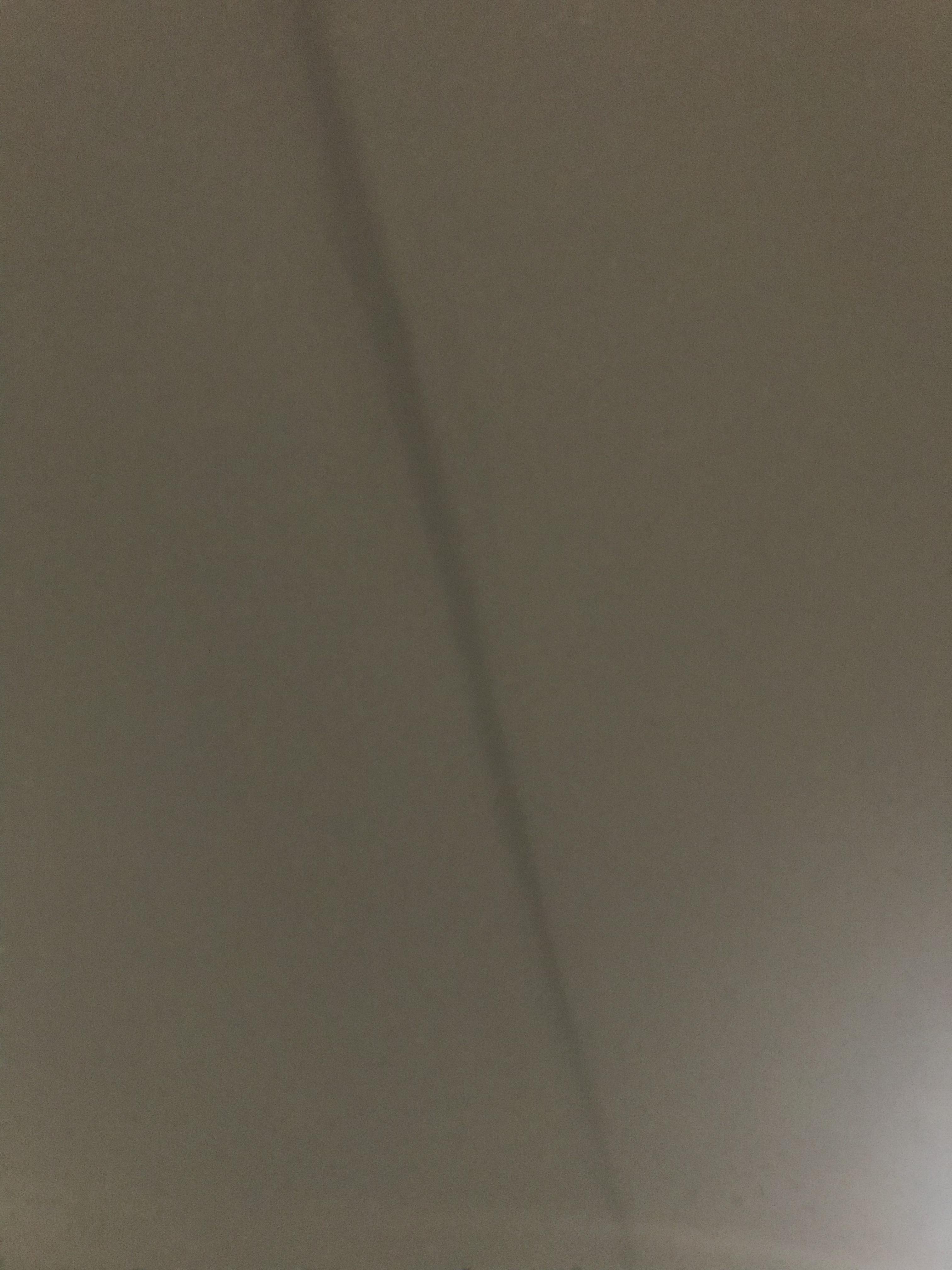

Dan1983 Posted November 14, 2023 Posted November 14, 2023 Afternoon all, Wonder if anyone has any advice. recently had the garage decorated in grey and found a couple of hairline cracks. The painter fillered these first time around but they came back. After some some advice I went with Geocel decorators mate as it’s flexible Had the ceiling re painted last night and unfortunately it’s left a shadow where the painters mate has been applied, same happened to me years ago painting over culk. Do I need to put some sort of under coat on or strip it all back and start again? Annoyed as I applied the decorators mate and was concerned about it showing through but shop advised it would be fine. Thanks for any pointers Â
SteamyTea Posted November 14, 2023 Posted November 14, 2023 42 minutes ago, Dan1983 said: Annoyed as I applied the decorators mate and was concerned about it showing through but shop advised it would be fine. Show the pictures to the shop manager and ask their advice, and a refund.
Dan1983 Posted November 14, 2023 Author Posted November 14, 2023 Will do but doubt they will pay for the decorator to sort the issue unfortunately! Is there some sort of a blocker I can paint on to stop it showing through then repaint the ceiling for the third timeÂ
Mr Punter Posted November 14, 2023 Posted November 14, 2023 A coat of Zinsser stain block should hold it back 2
