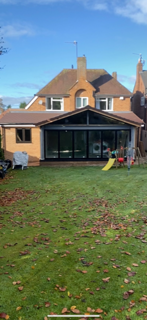

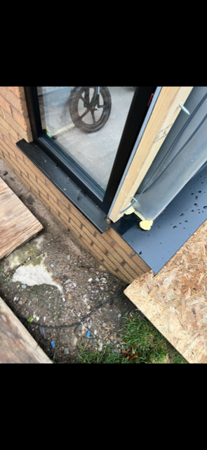

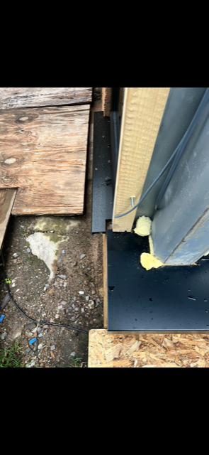

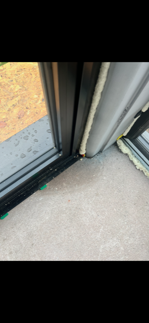

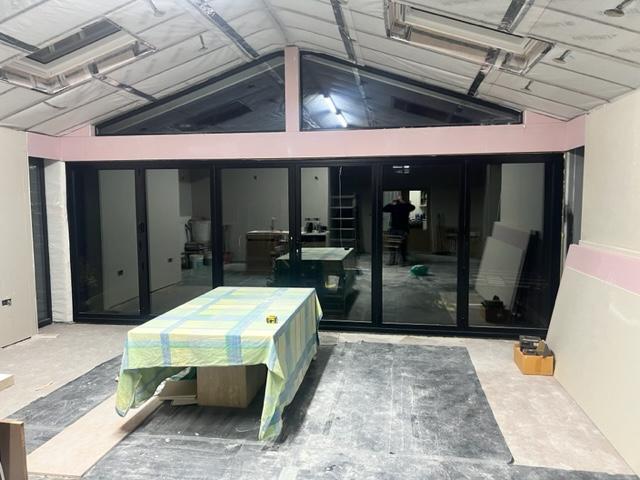

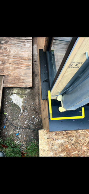

GasManDan Posted November 14, 2023 Share Posted November 14, 2023 Evening all, I’m looking for some help and advice regarding insulating a steel goalpost structure in order to try to stop thermal bridging and bad moisture problems internally. We have just had the internals plastered and the plan originally was to clad the external steels with oak but have had to put that on hold temporarily due mostly to cost. my plan B is now to insulate the external steel as best as possible then possibly clad with aluminium. it’s the first winter we have had doors and windows in but the moisture on the steels internally is real bad. I’ve purchased some 10mm cold bridge strips from proctor group to cover steels internally and then was maybe thinking again to clad with aluminium as don’t think plasterboard would last with the amount of moisture. has anyone else been in this situation and can offer any further advice? thanks in advance for your help Link to comment Share on other sites More sharing options...
Andehh Posted November 14, 2023 Share Posted November 14, 2023 Thin layers of 25mm PIR carefully and rightly packed around every bit of it outside, expanding foam on any nooks, then tape over the top for good measure, then aluminium sheet over the top of it! That's what I did, ours were I beams so I got lots in the middle of it difficult for the I protrusion but then most of it was behind external blocks with insulation which helped. Try it out over a days work, and see what difference it makes. That looks like quite a large damp patch for condensation? Sure its not water ingress from driving rain around windows? Link to comment Share on other sites More sharing options...
Conor Posted November 14, 2023 Share Posted November 14, 2023 We stuck on 50mm PIR then alu flashing over. Out posts were only 80mm tho and set back so minor surface area. Build out the insualtion, foam and gaps, tape up, until the right depth just to be covered by the flashing. Link to comment Share on other sites More sharing options...
GasManDan Posted November 14, 2023 Author Share Posted November 14, 2023 That’s great thanks and appreciate your responses. has either of you looked into a closed cell spray foam in place of the PIR? Just thinking if the spray insulation is directly bonded to steel then maybe insulation values would be better? Link to comment Share on other sites More sharing options...
JohnMo Posted November 14, 2023 Share Posted November 14, 2023 Your windows seem to installed within the steel instead of in front or behind the steel. So you have a cold bridge that bypasses the window. So you have a cold source outside in the winter and at any time external conditions are colder than indoors, plus the steel will never be warmer than the ground it's attached too. So will always be colder than either inside or outside or both. So you need equal insulation inside and outside of the house and it really needs to overlap the window frame to prevent a short circuit. You need a minimum of 10mm aerogel or 15mm PIR, ideally more covering the steel internally and externally. You need to tape the whole lot to make it airtight to stop condensation forming. Spray foam isn't you friend here, a couple of sheets of PIR and aluminium tape are. If you haven't done the above where it's been plastered, that will need to be stripped back and redone correctly. Link to comment Share on other sites More sharing options...
