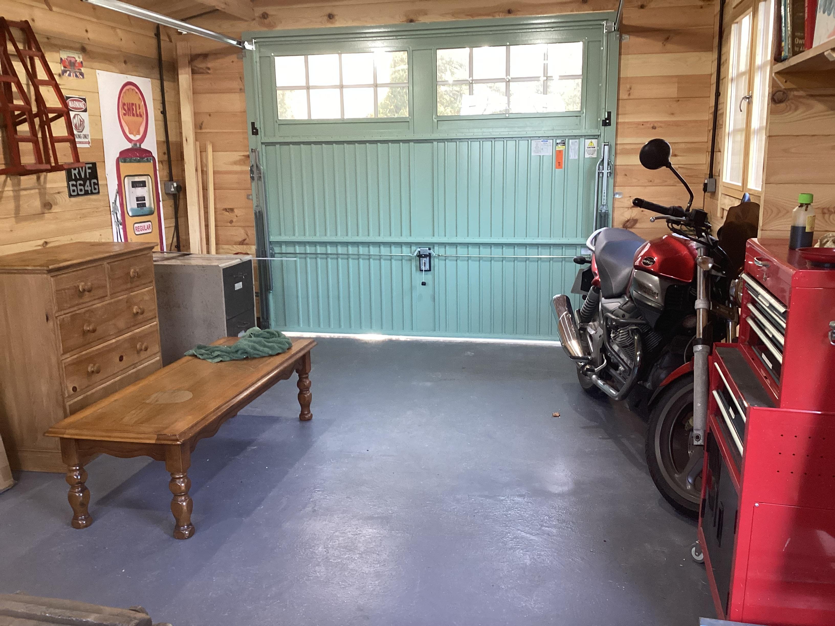

November 10, 20233 yr Hi all, I'm looking to install a steel across the width of my garage with a view to suspending a motorbike from it (I've not ridden it for a few years and it's more just a display piece now). The span is 5.7m and I wondered what spec steel I would need. I wouldn't hang the bike centrally - it would be nearer one end of the steel near the wall. The bike weighs around 180kg. I know I probably ought to speak to an SE, but I thought I'd see if there was any general consensus here on what spec I should go for. I'm kind of looking for the smallest possible size really so it's a) not too intrusive and b) I've got a fighting chance of getting it in place. Any help would be much appreciated. Cheers
November 11, 20233 yr Do you need to span if you are looking to suspend nearer to a wall? What about cantilevered bracket off said wall? If you do need to span you don’t necessarily need a steel beam, could be timber. If steel could also be cold rolled (purlin etc) rather than hot rolled. Loads of possible solutions.
November 11, 20233 yr More importantly, what bike is it? I can probably look after it for you, save you the hassle 😀
November 11, 20233 yr Author 8 hours ago, markc said: Do you need to span if you are looking to suspend nearer to a wall? What about cantilevered bracket off said wall? If you do need to span you don’t necessarily need a steel beam, could be timber. If steel could also be cold rolled (purlin etc) rather than hot rolled. Loads of possible solutions. I'd like to span the full width so I can swap ends if I rearrange the room and I may hang other items from it too (obviously vastly lighter than the motorbike, possibly a couple of mountain bikes etc). I did wonder about a timber I-beam or glulam etc but I think then the cost would exceed the cost of steel perhaps?? 7 hours ago, Russdl said: More importantly, what bike is it? I can probably look after it for you, save you the hassle 😀 It's an old 90's Ducati Superlight. I've not started it for around five years so it will need recommissioning - at some point I will sort it but at the moment the house is the priority sadly. It's currently in the lounge but her indoors said that's not a long term solution - strange! 53 minutes ago, JohnMo said: At 180kg, is it a Harley? It's a Ducati - I think officially it's about 170kg but I thought I'd err on the side of caution. (Harley's are generally over 200kg). Thanks for the input guys.
