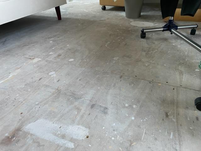

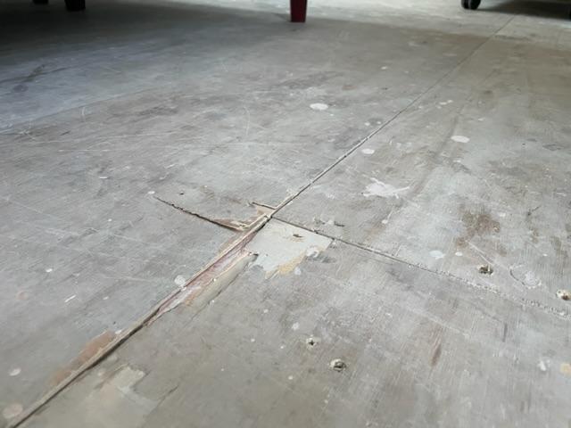

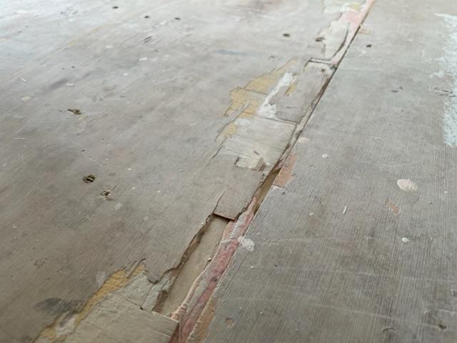

nmh Posted November 10, 2023 Share Posted November 10, 2023 Just done a major renovation throughout the house but the flooring laid for the top (loft) floor is creaky when you walk over them and seem to spring more than I’d like. See the pictures attached. Is this ply board the builder has put down? It looks @12mm to me. Rest of house is ok because he’s put down 18mm chipboard. We’re carpeting throughout. Any thoughts much appreciated. Thx Link to comment Share on other sites More sharing options...
Temp Posted November 10, 2023 Share Posted November 10, 2023 Whatever it is it's crap. Looks like 2nd hand/used shuttering plywood. Should be at least 18mm thick but I prefer 21mm. Check the joists are the right dimensions for the span first. Link to comment Share on other sites More sharing options...

Conor Posted November 12, 2023 Share Posted November 12, 2023 22 hours ago, nmh said: Thanks for this. I’ll get on it. It’s like a trampoline up there! Is this a full, proper loft conversion? Habitable room? Reason I ask is the original joists may not be up to the job and thicker floor boards might not make a difference. Link to comment Share on other sites More sharing options...
nmh Posted November 12, 2023 Author Share Posted November 12, 2023 Proper loft conversion. Think the joists are solid. 1 Link to comment Share on other sites More sharing options...
kandgmitchell Posted November 14, 2023 Share Posted November 14, 2023 That's got to be 2nd hand surely - it looks really rough! "Think the joists are solid"?? Presumably you have some professional drawings of this conversion. If it were me I'd be looking to see what was designed and approved has actually been provided. Link to comment Share on other sites More sharing options...
