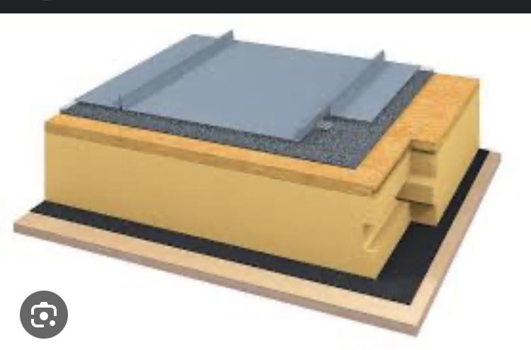

Nick Brown Posted November 3, 2023 Share Posted November 3, 2023 Hi everyone, I’m in the process of building our new house and just wanted to sound you out to see what you think. I am about to fix my SIPs panels onto my roof and and they are constructed using 11mm OSB 3. I propose fixing my Catnic Urban sheets using s/steel screws through the membranes into the OSB. Catnic ask for min 15mm OSB to fix into. I have consulted several different sources and they have said that it will be fine. just wondering what your thoughts are on the matter? Many thanks Nick Link to comment Share on other sites More sharing options...
eandg Posted November 3, 2023 Share Posted November 3, 2023 Do you not require some ventilation? We used standing seam but it went into 22mm sarking board on battens creating a ventilation gap to our sips roof. Link to comment Share on other sites More sharing options...
Nick Brown Posted November 3, 2023 Author Share Posted November 3, 2023 I’m pretty sure that no ventilation is required, using Tyvec Metal directly under the metal roof as a drainage layer, then membrane straight onto the SIP panel similar to the attached photo, but I will be adding 125mm Celotex below as well Link to comment Share on other sites More sharing options...
eandg Posted November 4, 2023 Share Posted November 4, 2023 9 hours ago, Nick Brown said: I’m pretty sure that no ventilation is required, using Tyvec Metal directly under the metal roof as a drainage layer, then membrane straight onto the SIP panel similar to the attached photo, but I will be adding 125mm Celotex below as well I'd check that out as our supplier told us ventilation was definitely required. There's also been some complaints on here about SIPS not being great with noise and while that has not been an issue for us I would think decoupling the metal roof from the structural one by way of a battened out void would be a good idea (we also had a noise dampening/anti-condensation layer fitted below the standing seam panels). Link to comment Share on other sites More sharing options...
nod Posted November 4, 2023 Share Posted November 4, 2023 1 hour ago, eandg said: I'd check that out as our supplier told us ventilation was definitely required. There's also been some complaints on here about SIPS not being great with noise and while that has not been an issue for us I would think decoupling the metal roof from the structural one by way of a battened out void would be a good idea (we also had a noise dampening/anti-condensation layer fitted below the standing seam panels). Plus 1 Condensation may be an issue further down the line Link to comment Share on other sites More sharing options...
