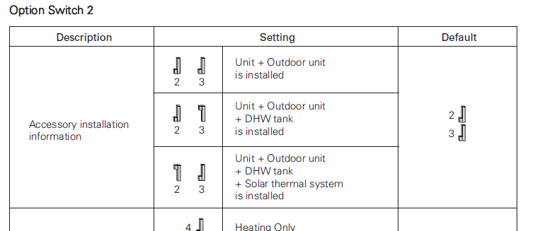

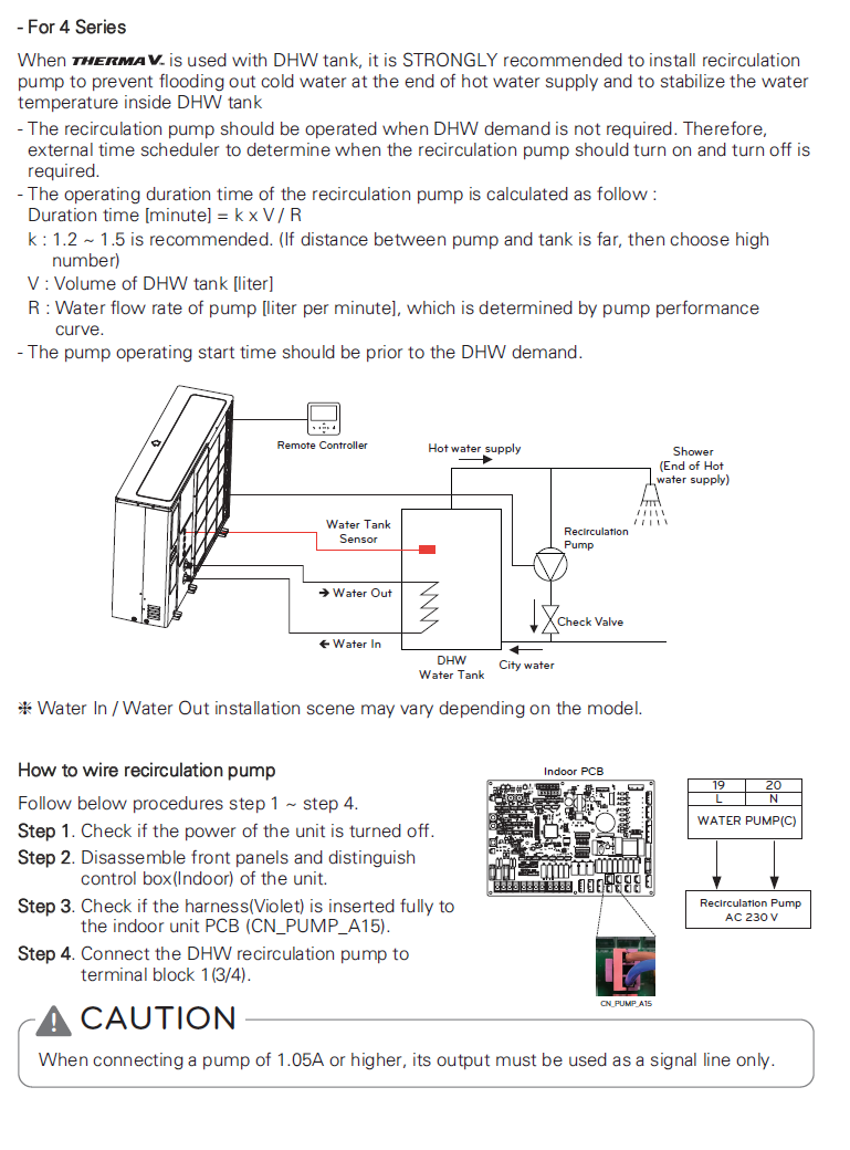

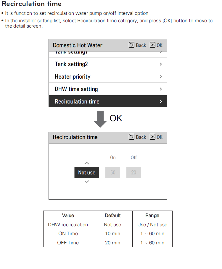

Willits Posted November 3, 2023 Share Posted November 3, 2023 Hello All, I have a Therma V 9kw monbloc installed with a DHW tank and recirculator pump. All is working as expected except the recirculator pump is not coming on. DIP switch #2 is off and #3 is on and the pump is connected to TB1 terminals 19 & 20 - water pump C. In the DHW menu recirculation time is set to “use” in the controller (for now I have set it at 60 minutes on and 5 off so I can see if it is running). My pump is a Grundfos Alpha 1L which uses a maximum of .26 A. I must be missing a setting or jumper somewhere. Does anyone have some advice what else to check? Many thanks, Peter Link to comment Share on other sites More sharing options...

Willits Posted November 3, 2023 Author Share Posted November 3, 2023 Hi John, What I am not finding is a way to set the circulator pump to on so I can check if the terminals receive power. The only thing I could find is the DHW recirculation on/off cycling setting. Which I am guessing when set should enable the power to the pump but in my case does not. Indeed the manual states series 3 models don't have the option but the series 4, which is mine, does. Link to comment Share on other sites More sharing options...
ReedRichards Posted November 4, 2023 Share Posted November 4, 2023 Quote Therefore, external time scheduler to determine when the recirculation pump should turn on and off is required. Do you have one? I think the previous sentence misses a "not" so the meaning is inverted. Should say: Quote The recirculation pump should not be operated when the DHW demand is not required I have both a Therma V and a DHW recirculation pump and they function perfectly well completely independently. Link to comment Share on other sites More sharing options...

ReedRichards Posted November 9, 2023 Share Posted November 9, 2023 On 05/11/2023 at 09:25, Willits said: I was trying to take advantage of the built-in function for the DHW circulation since it is there. My reading of the manual you quote is that this built-in function is not intended to work standalone. So maybe it just throws a switch but requires the pump to be powered independently. Then you wire it so the live goes to the recirculation pump via the heat pump so the recirculation pump is energised by a switched live as required. Link to comment Share on other sites More sharing options...
Willits Posted November 14, 2023 Author Share Posted November 14, 2023 Hi Reed, That is a good point. I was thinking that the heat pump provides 220 and switching on and off according to the program. That is how the how the 3 way valve is running. But the connections acting as a switch makes sense. I'll check that tomorrow. May thanks. Link to comment Share on other sites More sharing options...
