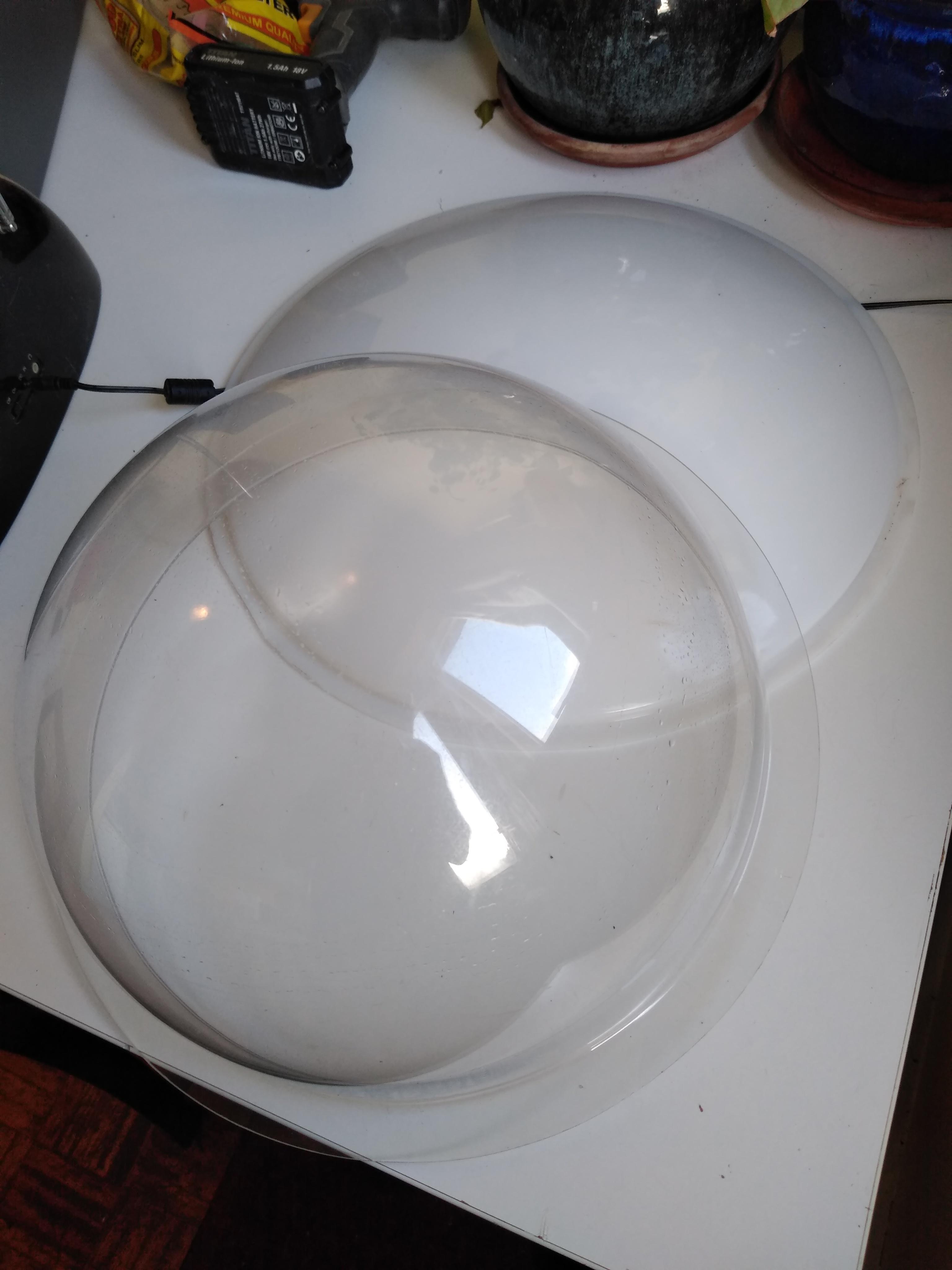

Here is a picture of the Monodraught parts I prototyped in the 1990s.
They are only circular to match the pipe, and only domed as that is what they wanted.
Prototype vacuum forming is relatively cheap to do as the former can be timber.
