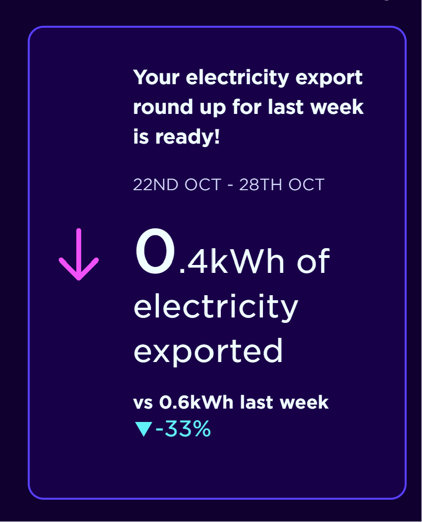

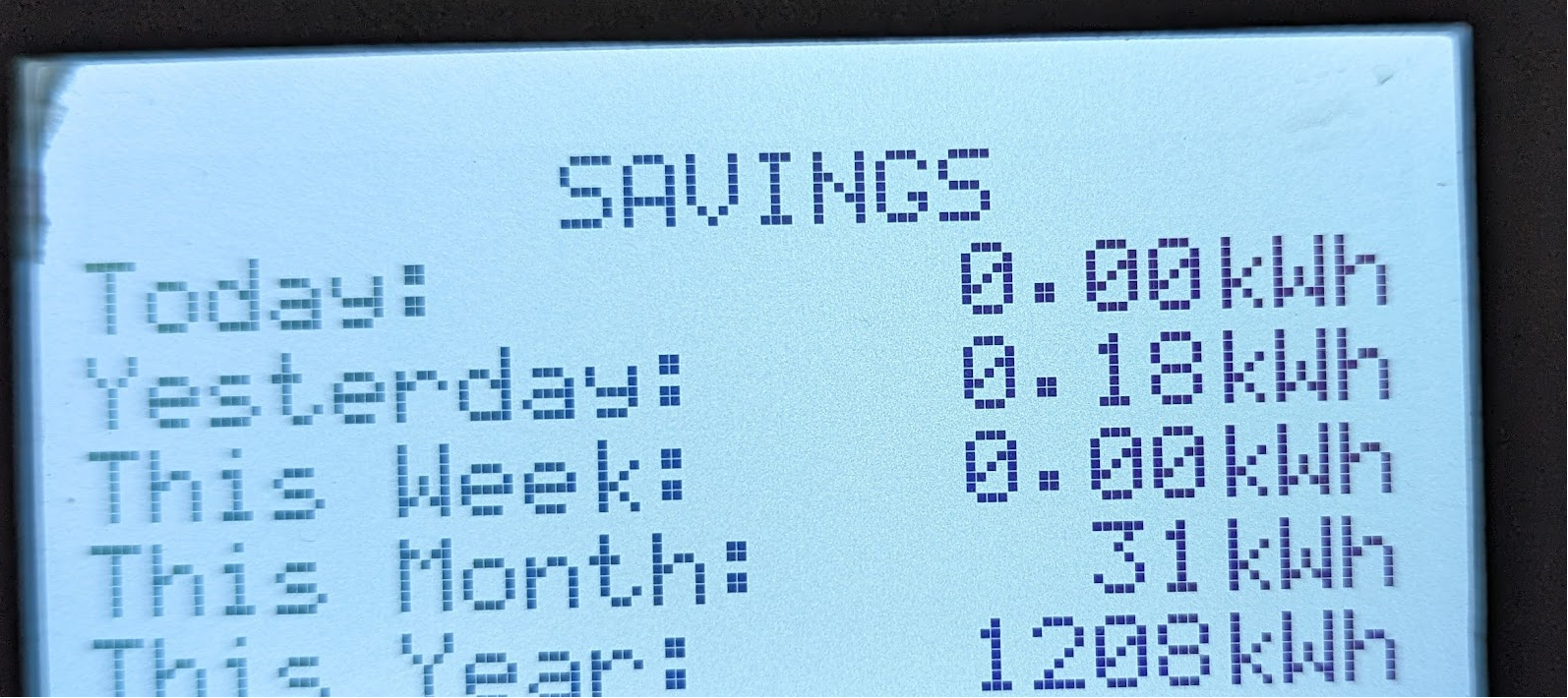

ToughButterCup Posted October 30, 2023 Share Posted October 30, 2023 (edited) I use Windy's Solar Radiation (Power) layer ( solar power and UV index) to help me predict how much to boost our water heating once the sun has gone down. So I'm almost always well aware of how much 'water heating ' I can get out of the sun on any one day. Yes, I know, its not for everyone. Most will just want the system to tell you how much hot water you have left . But. I know for sure (at least I thought I knew until the stats below became available) that this month, we never generated enough solar power to fill our SunAmp - trees in the way and lack of sunshine. And then I saw this: I'm actually EXPORTING to the grid ... not much, but I am. And that tiddly bit of power is worth more to me as heated water than exported From Octopus I get this and checking on my EDDI I get this The only thing I know for certain is that power is being exported to the grid when it could have gone to heat our water. (The EDDI will not give me a readout for last week's export value) Am I doing anything wrong? Could I change any settings to prevent small amounts (20p worth) going to the grid ? Edited October 30, 2023 by ToughButterCup hyperlink added Link to comment Share on other sites More sharing options...
JohnMo Posted October 30, 2023 Share Posted October 30, 2023 Is there a threshold (W) where the Eddi starts heating water, mine not an Eddi, doesn't make hot water until the export is over 100W. 1 Link to comment Share on other sites More sharing options...
SteamyTea Posted October 30, 2023 Share Posted October 30, 2023 I suspect a threshold and parasitic loads. 1 Link to comment Share on other sites More sharing options...
sharpener Posted November 1, 2023 Share Posted November 1, 2023 If the Eddi is like the Zappi (also from myenergi) then you will be able to change the grid balance point in the direction of exporting less. But you might find you then start to import when you don't want to, it will never be perfect. My solar diverter is home-built but like @JohnMo's takes 100W export to turn it fully on. So you might not have much scope to reduce it further. It is something I was prepared to live with rather than spend time experimenting with the control loop, it has worked well for >10 yrs now. 1 Link to comment Share on other sites More sharing options...
