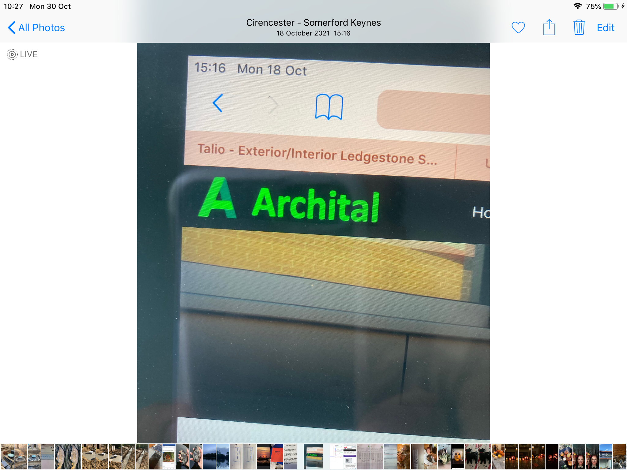

ectoplasmosis Posted October 30, 2023 Share Posted October 30, 2023 I'm looking for a way to make a window reveal trim from powdercoated aluminium, as per the example in the attached photo. I can find plenty of extruded aluminium products for dormer roof edge trim, but can't seem to find anything off the shelf for making the window reveal trims as per the photo, even though I can find plenty of examples of this having been done. I must be looking in the wrong places... Any pointers gratefully received! Link to comment Share on other sites More sharing options...

ectoplasmosis Posted October 30, 2023 Author Share Posted October 30, 2023 Thanks for the recommendations; I was hoping there would be an off-the-shelf product available without needing to go bespoke! Any other suggestions much appreciated. Link to comment Share on other sites More sharing options...
ectoplasmosis Posted November 10, 2023 Author Share Posted November 10, 2023 To answer my own question, I have found and purchased the following profile: 'Tamlyn XT-VERT'. Available from here, among other places: https://guttercentre.co.uk/aluminium-trims/10077-896052-aluminium-vertical-profile-x-3m-length.html#/952-colour-mill_finish_non_painted I'm having it powdercoated to match the Velfac windows, will report back after it's all installed. Link to comment Share on other sites More sharing options...
