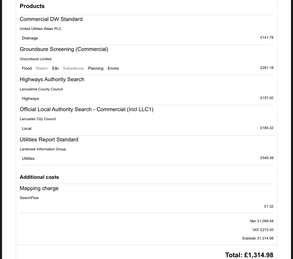

1) Searches - the solicitor is pushing for me to complete the full set of searches which is going to cost just over £1.3k but not sure if I need these. Looking at the sample reports, not sure what I’d get from it. I’d still need to do a site investigation, contact energy suppliers etc. Are these searches worthwhile?

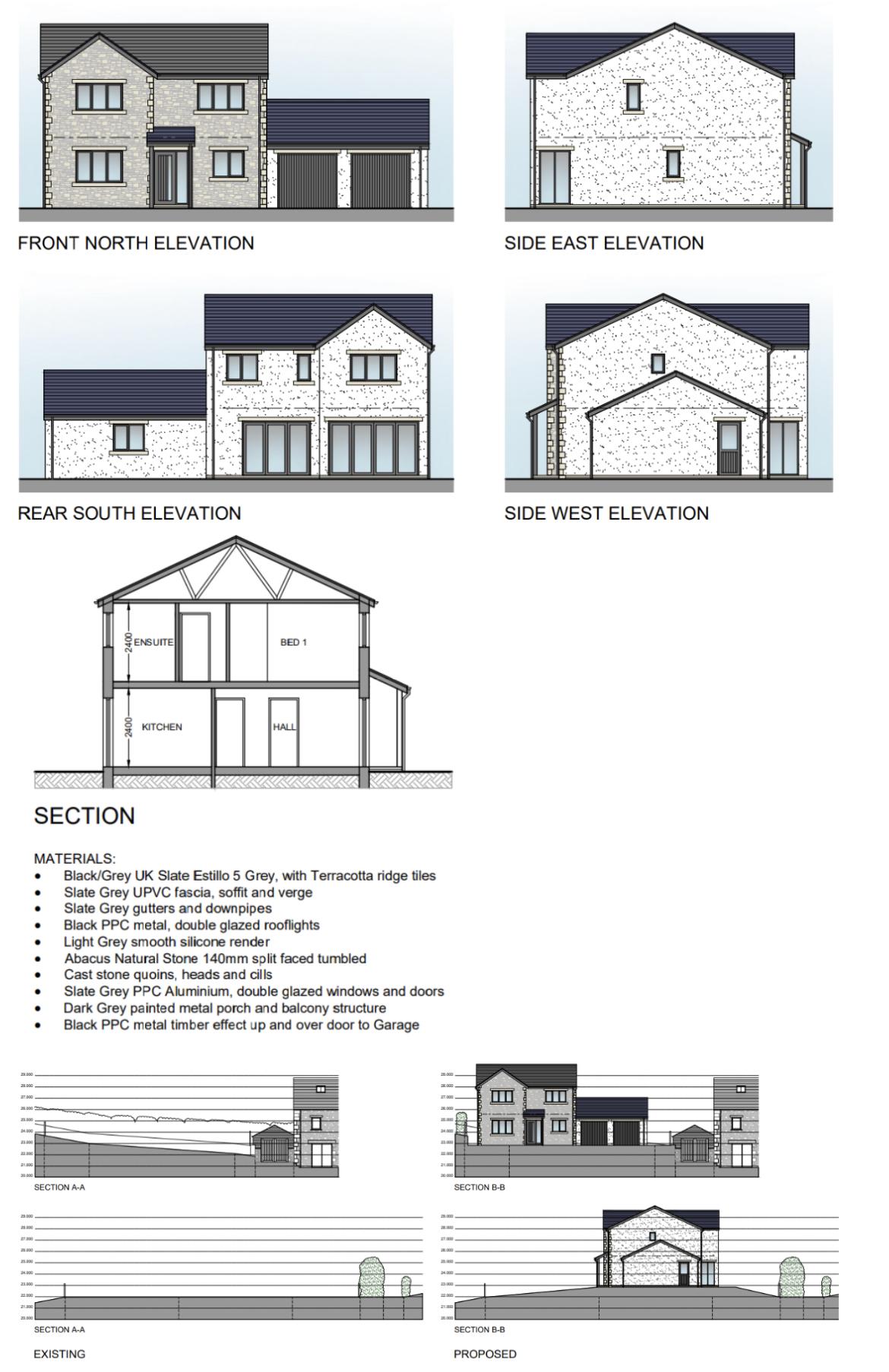

2) Planning - attached is the existing approved plans. There is a condition to remove permitted development so we want to submit new plans to convert the garage to a granny annex and make the loft a master bedroom/en-suite. If I plan on a timber build, I believe I only need an update concept plan from an architect rather than the full works?

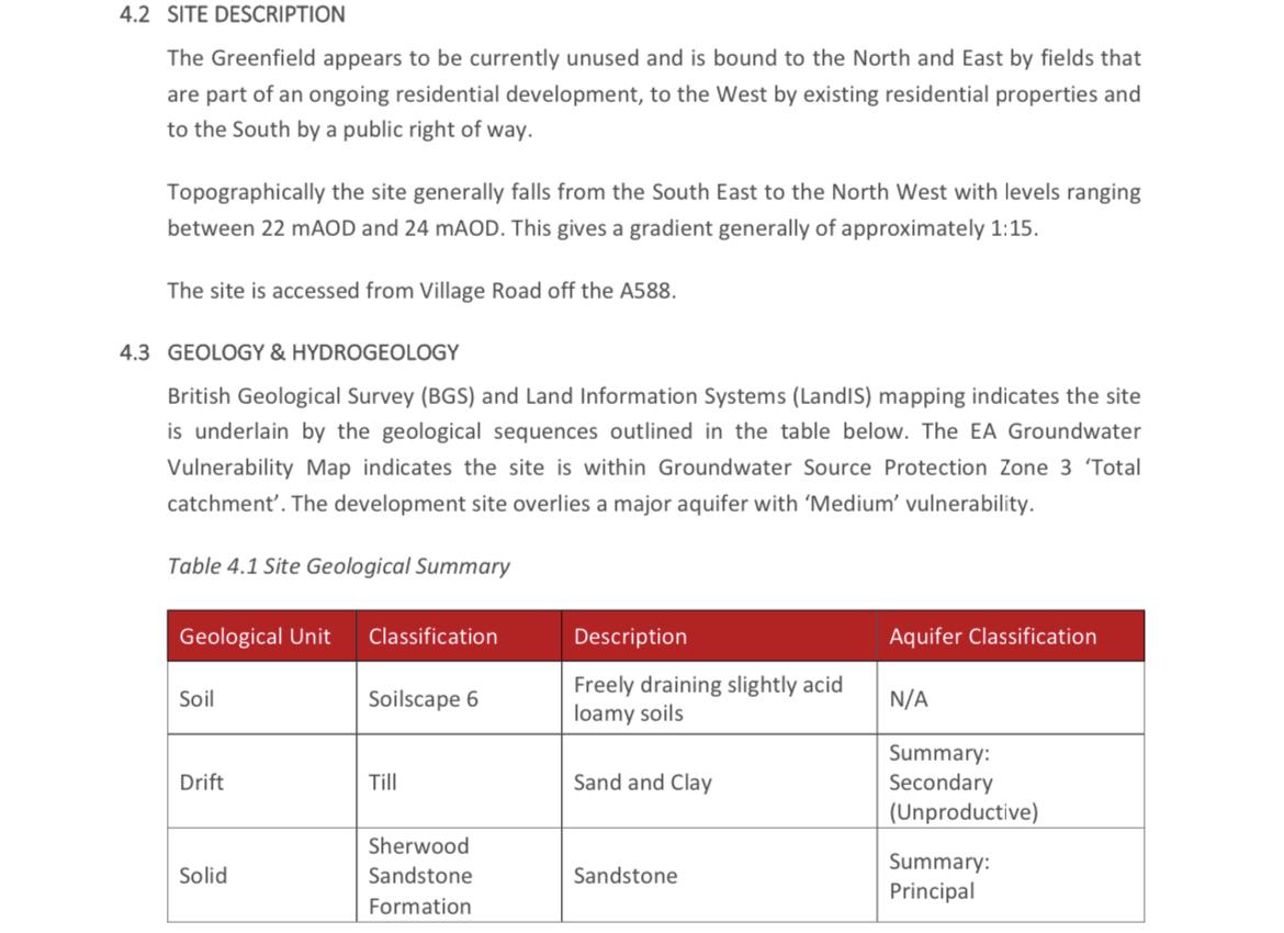

4) Soil Type - as part of the planning, there was a Drainage Strategy completed which briefly touched on the geology of the site. Attached is the result, I can see it references Till which I’ve read is not good for foundations although wondered if anybody could possibly give some more info on this?

I am struggling to think of what "searches" are likely to cost £1/3K  I paid less than that for the total legal work when buying my plot.

Attached is the searches quote we have been provided. Seems very excessive to me.
I presumed after digging down it would be sand and clay based in the drainage strategy report although probably best just to wait until a full soil survey is done.

It seems excessive. However, it is essential to do these to show up any issues, potentially huge.
A cable or sewer. A right of way. Mines beneath. An infilled tip.
Scottish lawyers are very, very much better value than English, esp in SE.England.
does it say how thick the 'till' is?
Sandstone at about 1m would be good news.

The land is the corner of what was farm land that has been sold off with planning. I know this is landlocked already and we need a right of way to use the private road that connects to the highways which is currently used by the converted barn on the plot of land next to this. In two minds whether it was worth risking not doing the searches.
I think the expense is because they are quoting for commercial searches rates than residential searches as this is just a plot of land, not sure if that is the correct process really.
Unfortunately no depths mentioned in this document.
That seems evasive. If someone has dug a hole it isn't much trouble to measure the depth. Ask politely?
Ahh but I now see they haven't dug a hold, just looked at a general statement in  a book on the area.
Till is glacial deposits. It can be very good to build on. Also it can be tend of m deep.
Really I would want to dig a hole on your site because it might be topsoil on fill or disturbed till. Farmers bury stuff in corners of fields too.
