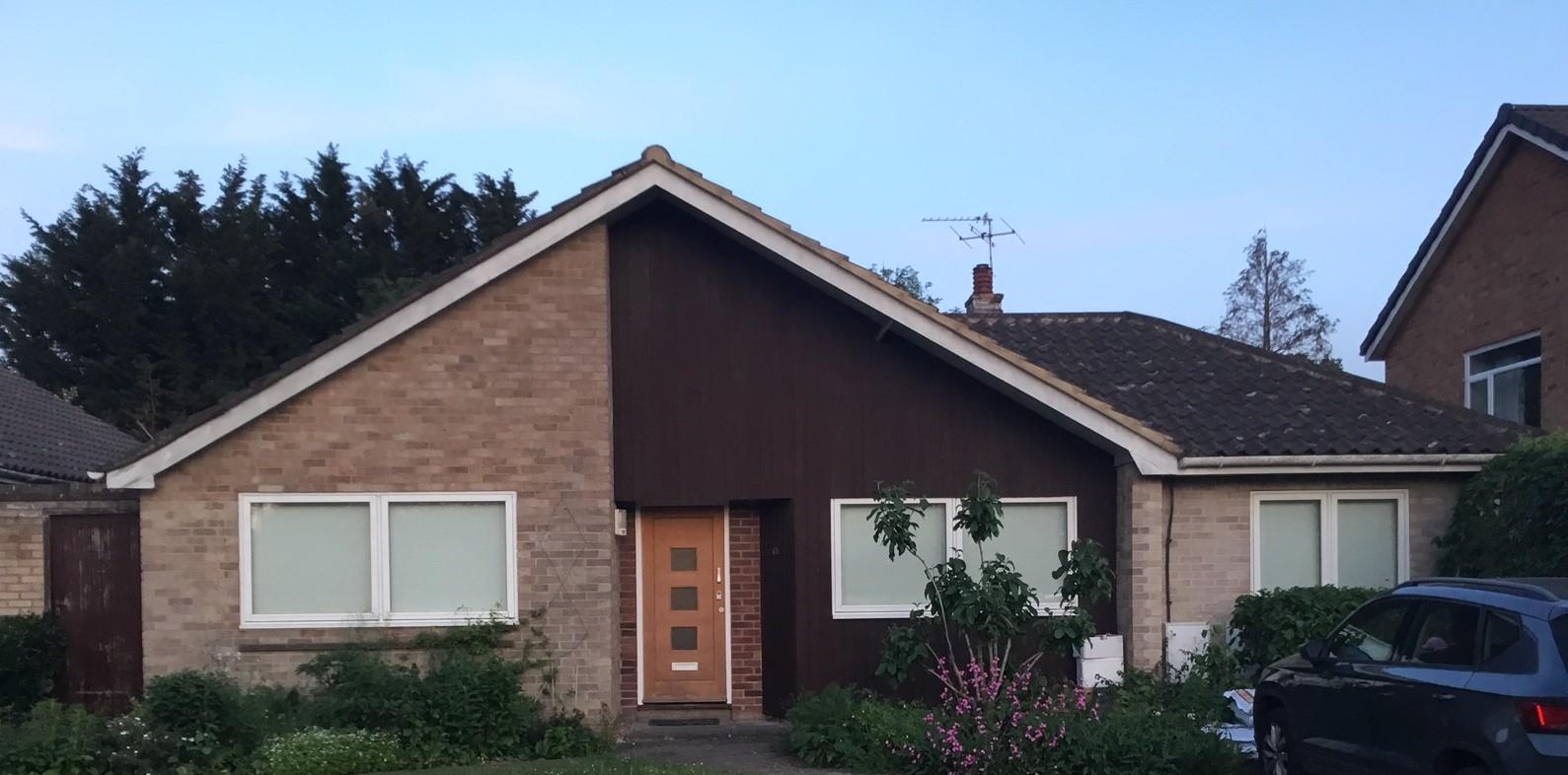

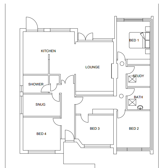

Novice Becky Posted October 8, 2023 Posted October 8, 2023 Hi. Just officially joined so I can ask some questions on this amazing forum! I'm a novice but I enjoy DIY (when time permits), so far mainly designing and building storage/fitted cupboards/kitchens, working with wood. Never built a wall in my life - but this forum gives me confidence to try things. A LONG introduction to my ongoing retrofit project (lots of questions to follow) ... I'm reattempting a retrofit project that started 15 years ago when we moved in. We're in Surrey (M25 J9) and have a 1960s bungalow: gable roof detached bungalow side extension (on the right) built by builders 2009/2010 - Side extension has a double-hip roof. Approx 134 m2 Front of house is north-facing - so living area is south-facing (with lots of solar gain) solid concrete floors (suspended concrete floors in extension) open plan living/kitchen/dining (used to be 3 rooms) 4 bedrooms snug study 1 bathroom 1 shower room (kinda also utility with washing m/c) AIMS: Reduce our fuel bills and CO2 emissions, heading towards net zero Stop using fossil fuels so stop using gas. Resolve our condensation problem - cold and north-facing spots get mouldy. Very high humidity readings in winter. It's got worse, I think, because 15 years ago we fitted high-spec argon-filled wooden framed double glazing to all but 2 windows, I insulated loft with recycled plastic insulation (laid over old mineral wool) and our children are now all teenagers so bigger lungs and bigger baths/showers. All bedrooms have trickle vents. We also have 1980s CWI which has failed (a surveyor put a camera in the cavity a few years ago). BACKGROUND: When we moved in (2007) and did a load of work it was hard to find any 'green' trades/expertise and I just had my Green Building Bible. I was told MVHR wasn't appropriate for my leaky house. People were clueless about underfloor heating let alone heat pumps and timber frame building etc. so we just did what we could. I've put off getting things done/repaired because of a string of situations and I was desperate to have a retrofit assessment first to make sure everything worked together - Whole House Approach. I've finally found and had a retrofit assessment which was incredibly underwhelming and didn't shed much light (because my home is, on paper, already above average in terms of efficiency measures, despite the fact we consume more than our fair share - approx 22,000 kWh of gas and 5,300 kWh of electricity PA). TO DO LIST: MVHR (Leti guidelines suggest this is a very good option for ventilation for me) ... so remove and block up 3 external vents/fans Replace 2 old windows and very leaky front door CWI - extract mineral wool and replace with EPS beads (waiting for the above to be done first) and the company will also fill the smaller empty cavity that is behind the wooden cladding at the front of the house (Bed 3). ASHP coming in January (I want to get this done before I have a big repair bill on my 15 year-old gas boiler - or panic replacement) re-lay loft insulation and insulated boarding after it's been trashed with MVHR and ASHP installations. Then work at making the house more airtight- I bought a Flir camera and this highlights some problem areas that need insulating/draughtproofing, particularly around windows. Windows are high spec wooden-framed windows but fitted by a general builder with no attention to thermal bridging (I've learnt a lot since then). Two at the front were fitted by a FENSA fitter but they're possibly even worse. Also in the extension I can see that the CWI does not reach to the top of the ceiling and we have problems with thermal bridging across the ceilings with two steel joists Looking into retrofitting airtightness tape around windows - looks like I have to strip back the plaster. And something like Compriband on the outside. Not sure about sills Draughtproof windows/doors, loft hatch plus plumbing that goes through external walls. Chimney in lounge is still in situ but not used (currently insulated with a 'chimney sheep') Bathroom and shower room both need refurbishing, insulate bathroom ceiling (steel joist) Kitchen and bathroom lighting (retrofit LEDs didn't last) And building storage for the endless 'stuff' my family accumulate External Wall Insulation is very expensive (esp for the smaller gains it would seem to bring) so I'm thinking creatively and may build a wooden lean-to along the side passage (with thick polycarb sheets on roof) for storage and drying washing which would also act as a buffer zone. And I could construct something to act as a buffer zone along the other narrow side of the house. Maybe some EWI at the front (north). Shading at the back (south-facing) - my first attempt at making shade sails out of organic cotton sheets was not very successful!! Back to drawing board on this I'd like to replace the loft insulation with something breathable and use a vapour control layer etc but because it's a bungalow there's a large surface area so expensive to do and lower priority (I found this website helpful https://www.eco-home-essentials.co.uk/how-to-install-insulation.html)
