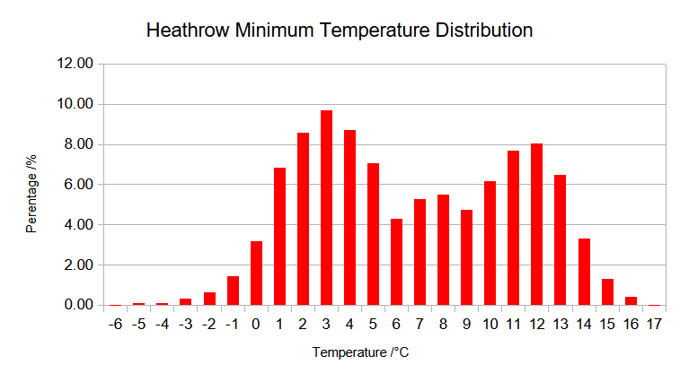

SteamyTea Posted October 1, 2023 Share Posted October 1, 2023 (edited) Do you know the performance hit for cold batteries. It may not be worth the bother. Below is the minimum temperature distribution for Heathrow, which is close to you. 0°C and below accounts for 6% of the total time, but remember that it will not be a contiguous string of time. Edited October 1, 2023 by SteamyTea Link to comment Share on other sites More sharing options...

windsor-tg Posted October 1, 2023 Author Share Posted October 1, 2023 21 minutes ago, SteamyTea said: Do you know the performance hit for cold batteries. It may not be worth the bother. Below is the minimum temperature distribution for Heathrow, which is close to you. 0°C and below accounts for 6% of the total time, but remember that it will not be a contiguous string of time. Someone who has the same type of batteries that I have mentioned that keeping the batteries warm allows then to charge and discharge at full 2500w power. Below 12c, SunSynk batteries halve it to 1250w and approaching zero they turn off altogether. If this is not the case, then I’m happy not to add any insulation to them. Link to comment Share on other sites More sharing options...
jack Posted October 1, 2023 Share Posted October 1, 2023 1 hour ago, windsor-tg said: Someone who has the same type of batteries that I have mentioned that keeping the batteries warm allows then to charge and discharge at full 2500w power. Below 12c, SunSynk batteries halve it to 1250w and approaching zero they turn off altogether. If this is not the case, then I’m happy not to add any insulation to them. If they're in a garage and regularly charging and discharging, it's possible that the temperature inside the case may rarely if ever fall below 12°C. In our garage, the air temperature rarely falls below around 5 or 6 degrees, even during a long period of very cold weather. Also, is your garage attached to the house? If so, there'll be some heating from the house through the common wall. And finally, I'd try and find written confirmation of what you were told. At the moment you just have someone's say-so. Link to comment Share on other sites More sharing options...
