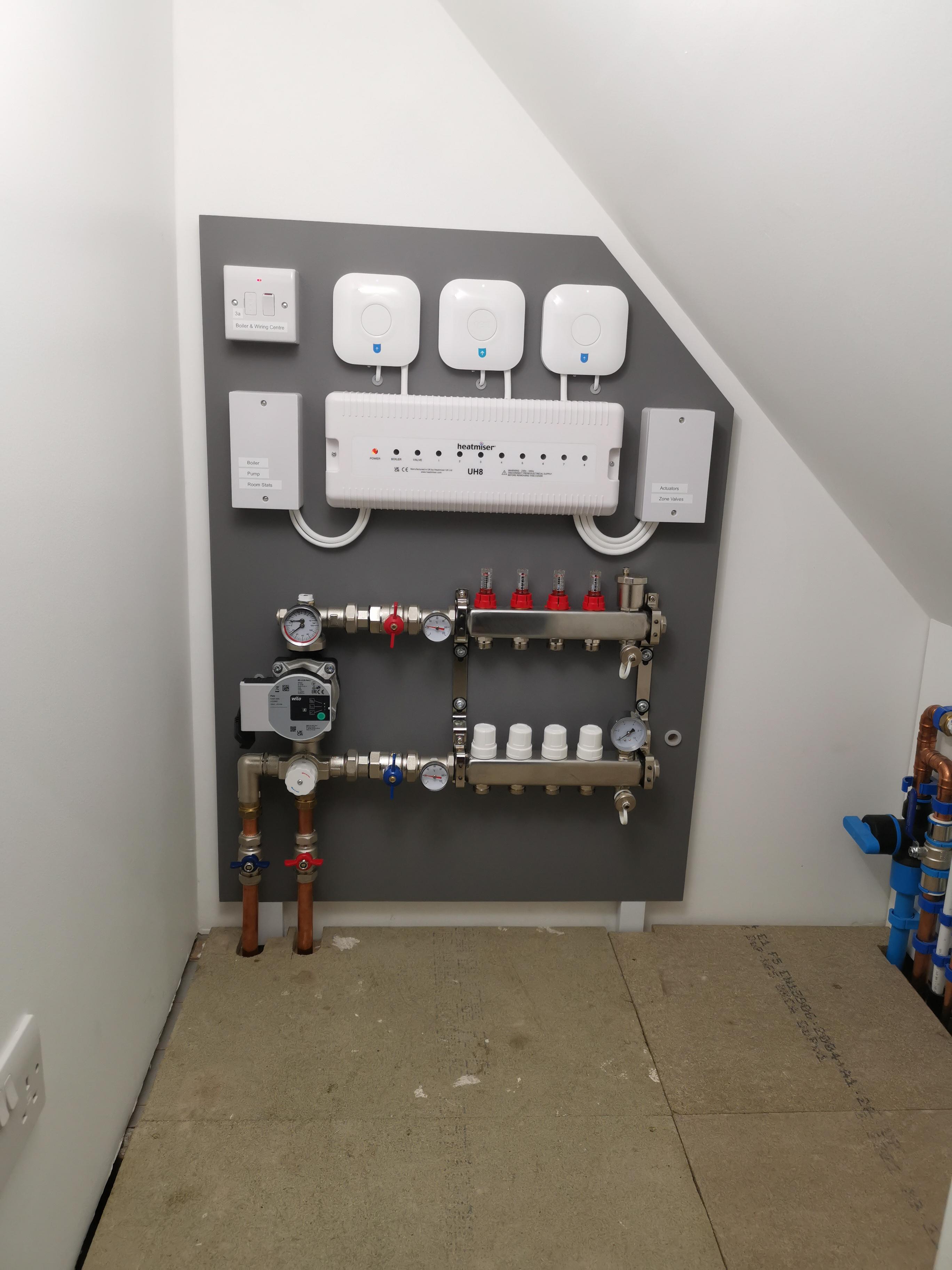

Super_Paulie Posted September 24, 2023 Share Posted September 24, 2023 I haven't fired it all up yet as I'm still at the insulation stage in my roof. I assume it'll be ok but it was a steep learning curve and @Nickfromwales and @JohnMo helped loads amongst other forum members, all very helpful. I didn't even know what a buffer tank was until they helped me out, now it's obvious it would have been required in the way I want to do things. I've tested the electronics and valves and its all good to go in the near future, but it was stressful and confusing at first. I'll draw it all out at some point for future reference but attached is how it's all controlled. Zone valves and buffer are at the upstairs/loft. 2 Link to comment Share on other sites More sharing options...
Nickfromwales Posted September 25, 2023 Share Posted September 25, 2023 20 hours ago, Super_Paulie said: I haven't fired it all up yet as I'm still at the insulation stage in my roof. I assume it'll be ok but it was a steep learning curve and @Nickfromwales and @JohnMo helped loads amongst other forum members, all very helpful. I didn't even know what a buffer tank was until they helped me out, now it's obvious it would have been required in the way I want to do things. I've tested the electronics and valves and its all good to go in the near future, but it was stressful and confusing at first. I'll draw it all out at some point for future reference but attached is how it's all controlled. Zone valves and buffer are at the upstairs/loft. Nice and neat, top job 🫡👌 1 Link to comment Share on other sites More sharing options...
TonyT Posted September 25, 2023 Share Posted September 25, 2023 Good to see good work being installed no matter that it’s in a cupboard. Looks great! 1 Link to comment Share on other sites More sharing options...
