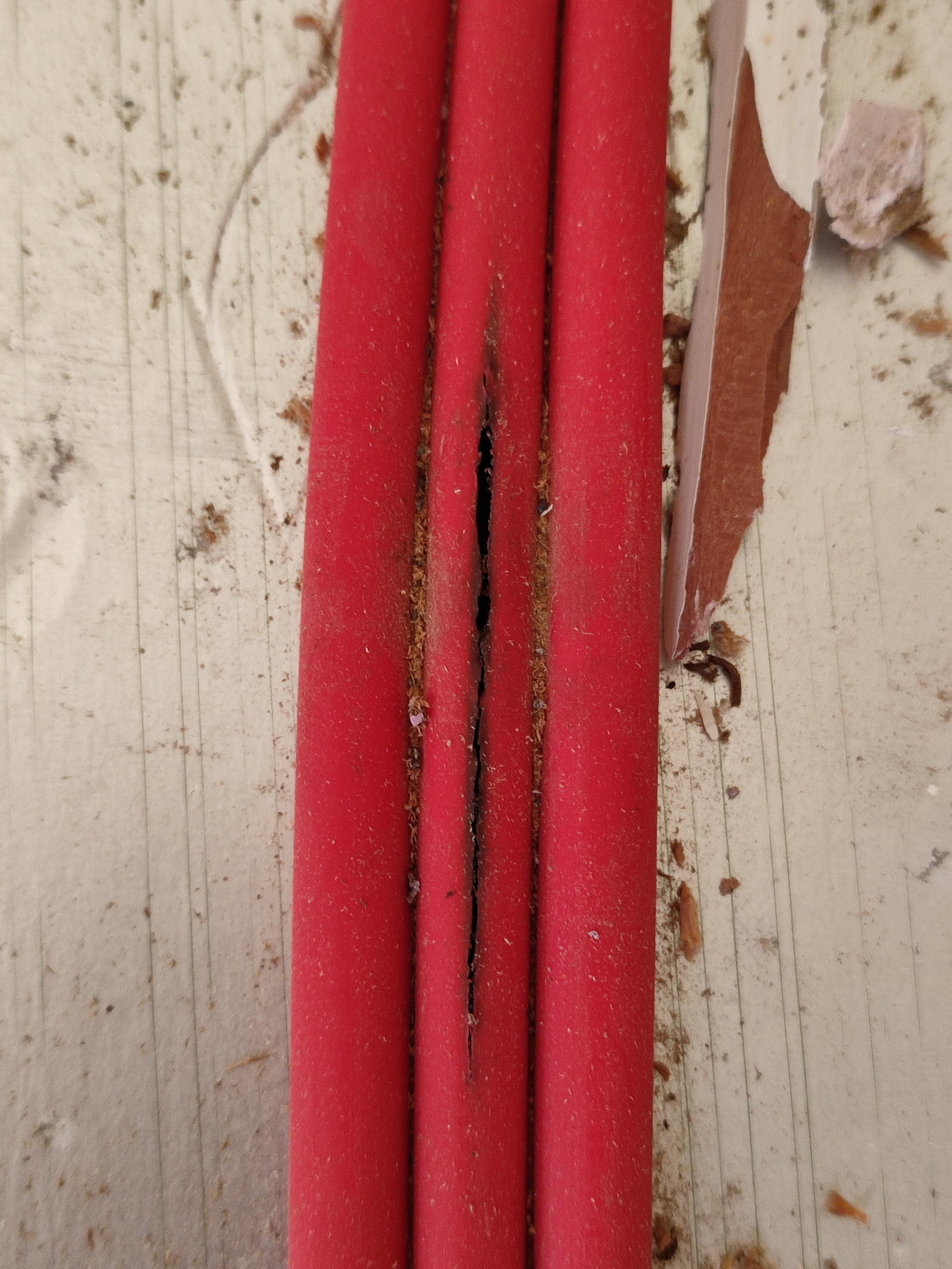

Flash forward to now and the system is plagued by leaks. I am converting the downstairs office to a bedroom for my dad who sadly has dementia and have been ripping up the UFH.
Here are some pics.
One of the 4 splits we found in one room.
It appears the pipes have been abrading against the floorboards (company recommended the pipes were pressed in contact with the floorboards for better heat transfer). When my dad fiddled with the hearing system last winter he pressurised it to 1.5bar (we have been running sub 1 bar for many years) and caused these thin patches to rupture.

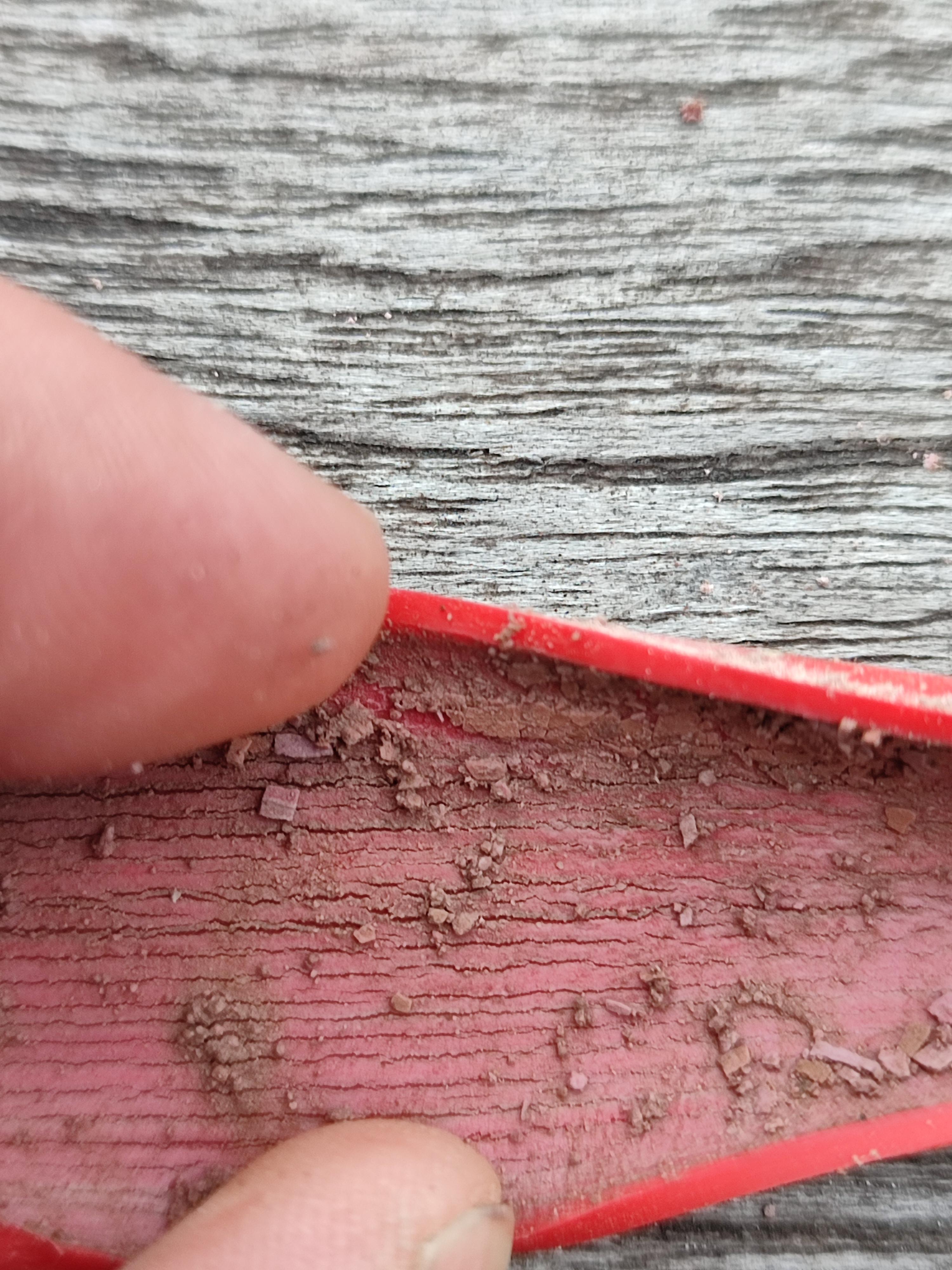

That debris appears to be the inner part of the pipe that has just dissolved away!
The bit that worries me is about 2/3 of the downstairs is cast into screed under tiles. If the issue was simply abrasion of the pipes from the outside, i'd be reasonably confident the slab pipes would be OK.
But if the pipes are corroding from the inside, it's only a matter of time before they go.

Is that the inside of the pipe or is it the inside of the boiler/gunk from constant topping up and non oxygen tight pipework not buried inside a screed etc?
Pipe looks like it cracks/crazed as you peel it open but I don't see bits of the pipe breaking away there but rather collected muck braking away from the pipe.
