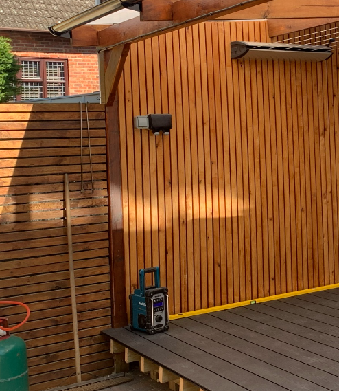

Tony K Posted September 8, 2023 Share Posted September 8, 2023 Evening. I am considering fitting external timber cladding to look a bit like this.. I appreciate the benefit of something expensive like larch or cedar for the natural colour of the timber, but I want it black. In light of the colour choice, my thinking is that I can buy something cheap like 25mm x 50mm pressure treated batten, paint it black, and away I go. Am I missing something?! Thanks Link to comment Share on other sites More sharing options...
Dave Jones Posted September 9, 2023 Share Posted September 9, 2023 did this at our old place, got a price for ceder and nearly fainted. bought a load of 4.8m treated 2x1 roofing batten. put it through our DeWalt portable planer and it came out lovely and smooth. stained with osmo and you cant really tell the difference. used a battery brad nailer for invisible fixings. whole lot cost less than £100, the osmo being the dearest part. 6 Link to comment Share on other sites More sharing options...

Tony K Posted September 9, 2023 Author Share Posted September 9, 2023 6 hours ago, Dave Jones said: did this at our old place, got a price for ceder and nearly fainted. bought a load of 4.8m treated 2x1 roofing batten. put it through our DeWalt portable planer and it came out lovely and smooth. stained with osmo and you cant really tell the difference. used a battery brad nailer for invisible fixings. whole lot cost less than £100, the osmo being the dearest part. Great stuff @Dave Jones, exactly the sort of thing I am hoping to do. I hadn't thought of putting the battens through a planer, good idea. Link to comment Share on other sites More sharing options...
