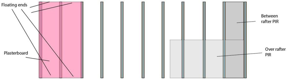

Super_Paulie Posted September 8, 2023 Share Posted September 8, 2023 Happy Friday gents and ladies. This week i will be mostly insulating my vaulted ceiling/lean to in the extension. BC been out, all happy so far and ive over-specced it against my planning approval. So ive got 125mm rafters. 50mm ventilation void, going to go with 75mm in-between the rafters and 75mm under. Then batten for service void and then finally plasterboard. My question is in regards to the batten. I cant find sod all online so i guess its common sense, but I was going to run the battens horizontal, so perpendicular to the rafters. All well and good but i assume i also need to run vertical battens to accommodate the ends of the boards so how do i pass my services though if im effectively making a frame under the plasterboard? Beer o'clock. Link to comment Share on other sites More sharing options...
MikeSharp01 Posted September 8, 2023 Share Posted September 8, 2023 Well Merlot o'clock anyway. I have found that the best way to deal with board ends, assuming the horizontal rafters are not on the 400/600 grid as if they are you can fix them to the rafters, is just to use off cuts of the batten behind the board ends where they join to allow the boards to get mutual support from each other and that has never been a problem. Just cut grooves in the back of the battens to get the cables through but make sure you keep fixing screws away from the cables. 1 Link to comment Share on other sites More sharing options...

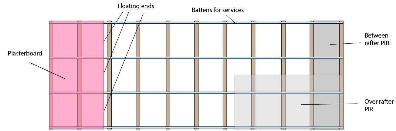

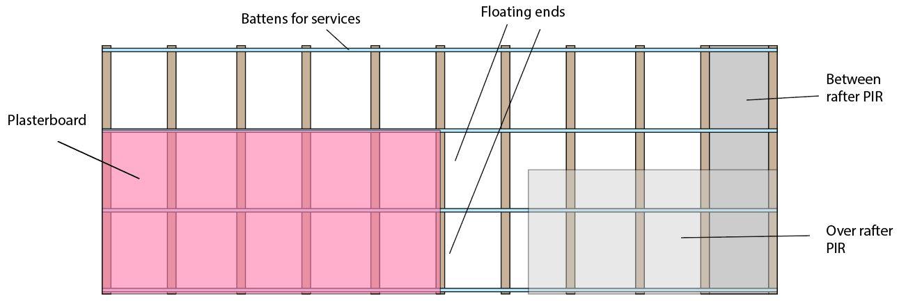

Super_Paulie Posted September 12, 2023 Author Share Posted September 12, 2023 On 08/09/2023 at 17:27, MikeSharp01 said: assuming the horizontal rafters are not on the 400/600 grid as if they are you can fix them to the rafters the rafters are, but if i am to create a service void with horizontal counter battens then i'll always have floating ends, so to speak. When boarding out stud work ive always made sure every side of the board is supported, so, im not sure if im getting the wrong end of the stick here as unless i create a frame for the boards with the battens then i'll always have floating ends. See attached shoddy picture. Would i just add shorter battens at the ends of the boards so i dont have any floating ends? Link to comment Share on other sites More sharing options...

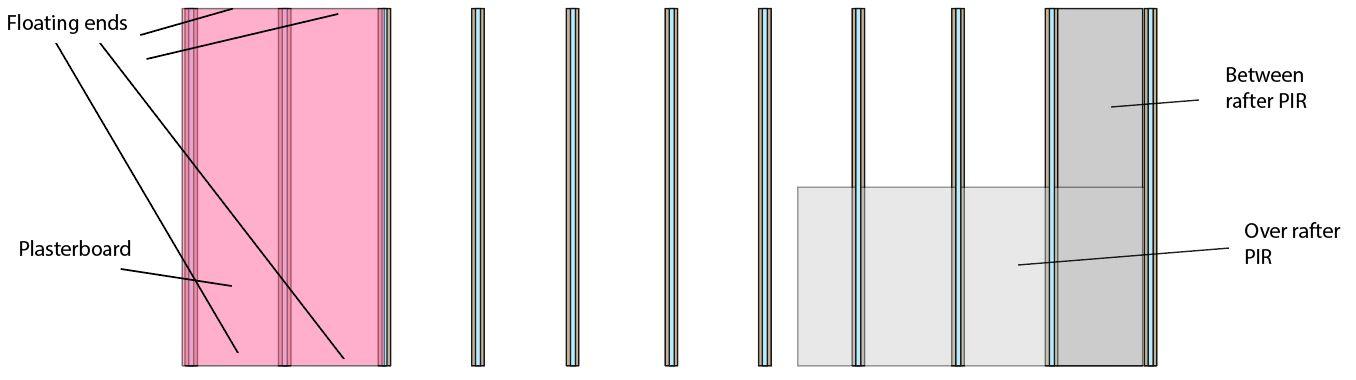

Super_Paulie Posted September 12, 2023 Author Share Posted September 12, 2023 or are we saying go this way? from what i can see @Buzz went like this, sorry for the name drop Buzz. Link to comment Share on other sites More sharing options...
MikeSharp01 Posted September 12, 2023 Share Posted September 12, 2023 No keep the support across the board side just rebate the backs of the battens in places to let the cable through. Link to comment Share on other sites More sharing options...
Super_Paulie Posted September 12, 2023 Author Share Posted September 12, 2023 plenty of ways i guess, im just worried about the unsupported parts of the plasterboard as i assume they will be bouncy. Link to comment Share on other sites More sharing options...
