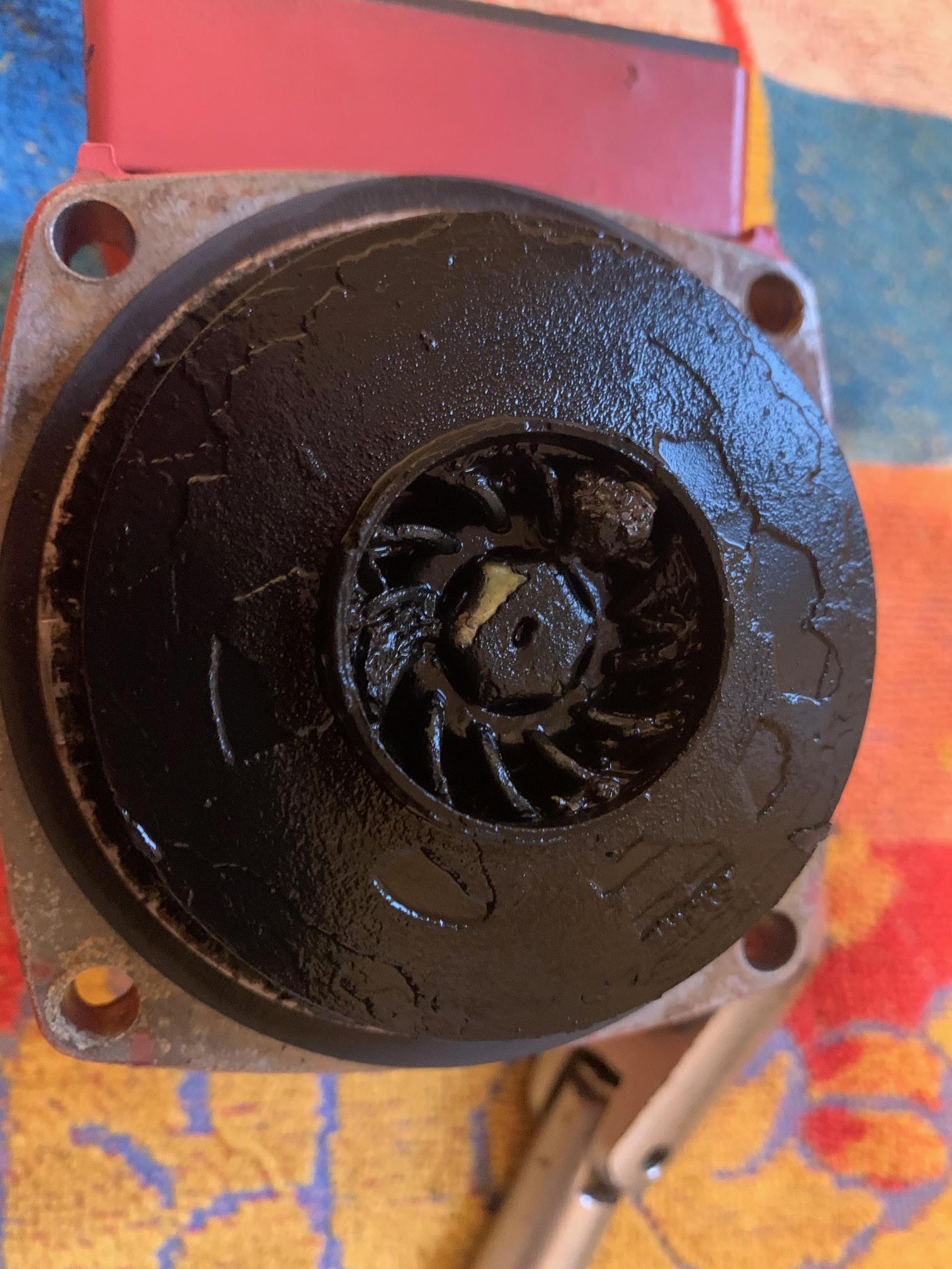

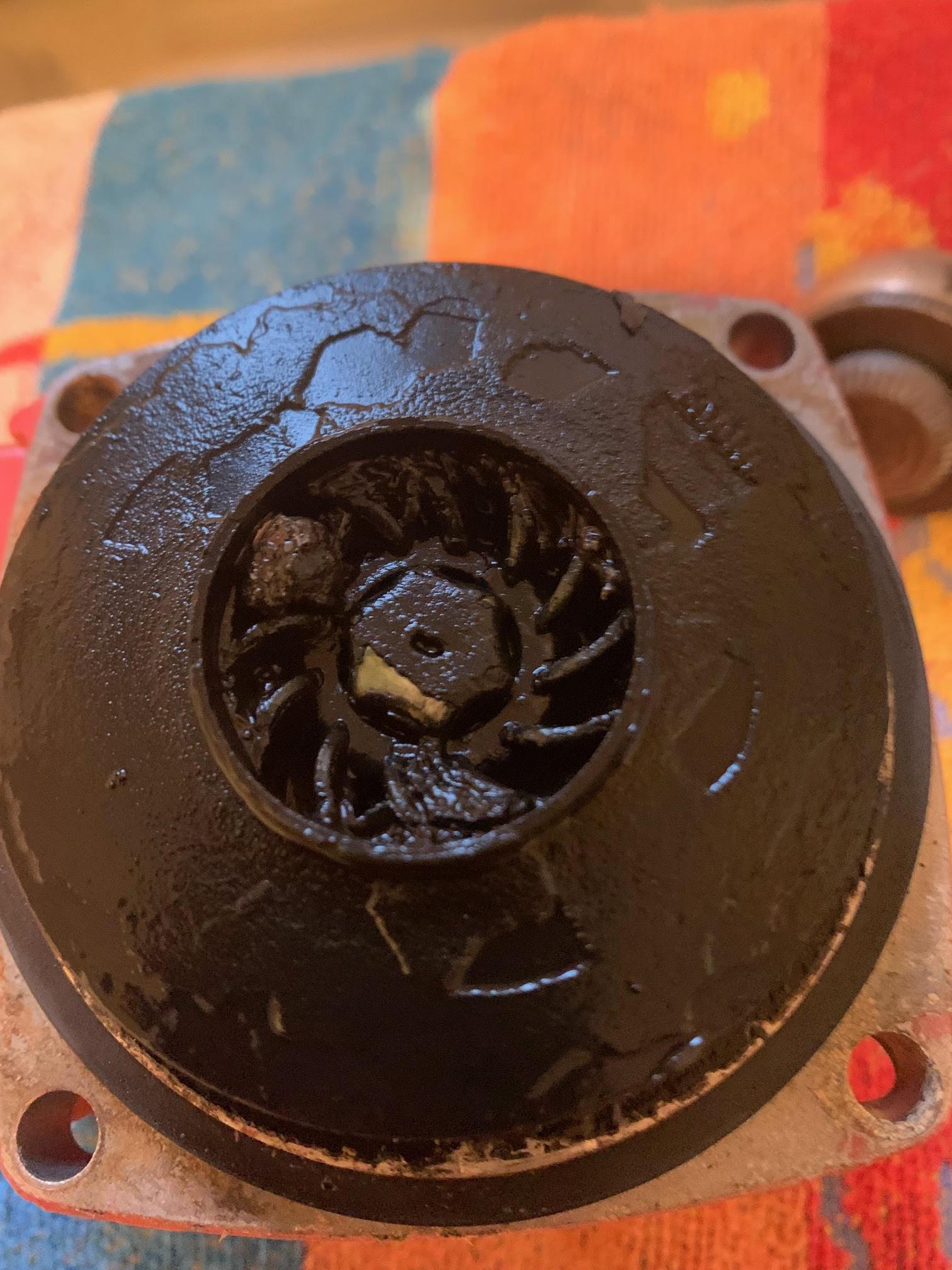

marshian Posted January 22, 2024 Posted January 22, 2024 Just coming back to this topic because for the last year and a bit I've had to run my CH pump on speed 2 to stop the boiler short cycling - Previous 30 years it's always been fine on speed 1 but I made a lot of changes a year or so back doubled rad size and reconfigured pipework as well as changed all the lockshield valves and TRV's. I think I know why now - I pulled the pump apart at the weekend Took a bit of work to get it clean and all the impeller channels clear - I have a magnaclean unit in the circuit but it's after the pump and never seems to collect much magnatite 1
JohnMo Posted January 22, 2024 Posted January 22, 2024 Looks like a system flush/chemical clean and some corrosion inhibitor wouldn't go amiss. Wonder the system worked at all. 1

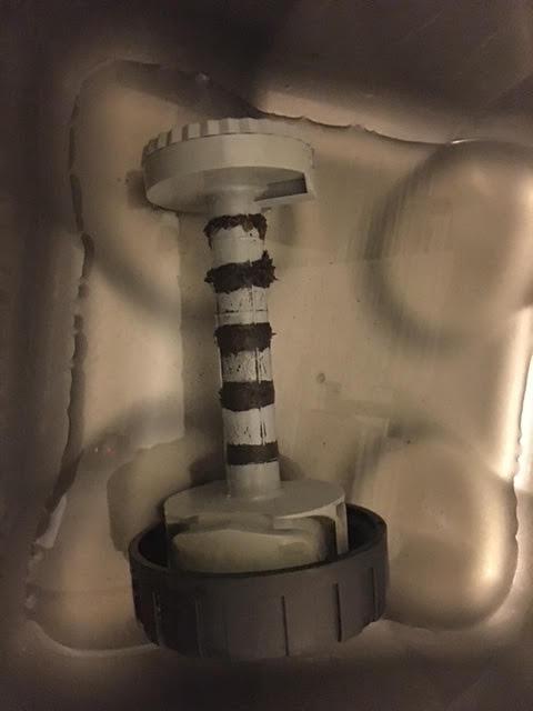

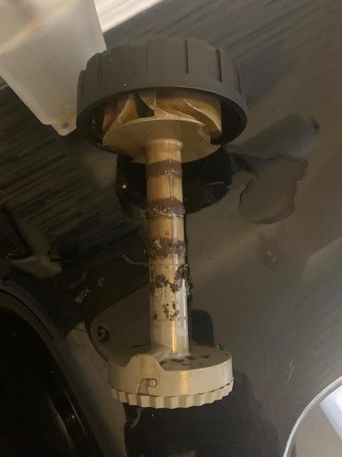

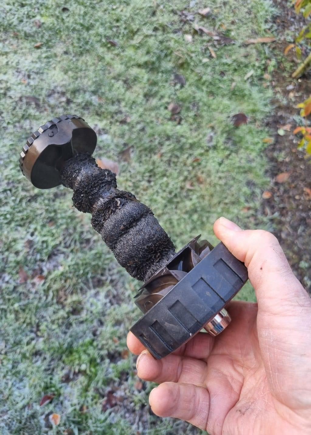

marshian Posted January 22, 2024 Posted January 22, 2024 On 22/01/2024 at 12:48, JohnMo said: Looks like a system flush/chemical clean and some corrosion inhibitor wouldn't go amiss. Wonder the system worked at all. Expand System is fully dosed with inhibitor All rads are new (or less than 2 years old) CH Circuit was drained and refilled twice in the last 2 years - each time it was flushed and then treated I have a magnaclean unit in the circuit but it's after the pump Current pump was fitted in dec 1999 and I'm pretty sure it's built up the level of magnatite deposits over time. It's possible changing rads and making changes to the CH circuit pipework in 2022 disturbed material and at that point the pump would see it first. Magnaclean images from the 6 monthly checks carried out in last 2 years - it picks up something but nothing like my mate got in his system after 1 week!!! (I'll try to find that picture)
SteamyTea Posted January 22, 2024 Posted January 22, 2024 On 22/01/2024 at 13:41, marshian said: Expand Is it a hedgehog foetus?
marshian Posted January 22, 2024 Posted January 22, 2024 On 22/01/2024 at 15:39, SteamyTea said: Is it a hedgehog foetus? Expand I don't believe it is but I can understand where you got that idea from It's not the worst I've seen either
