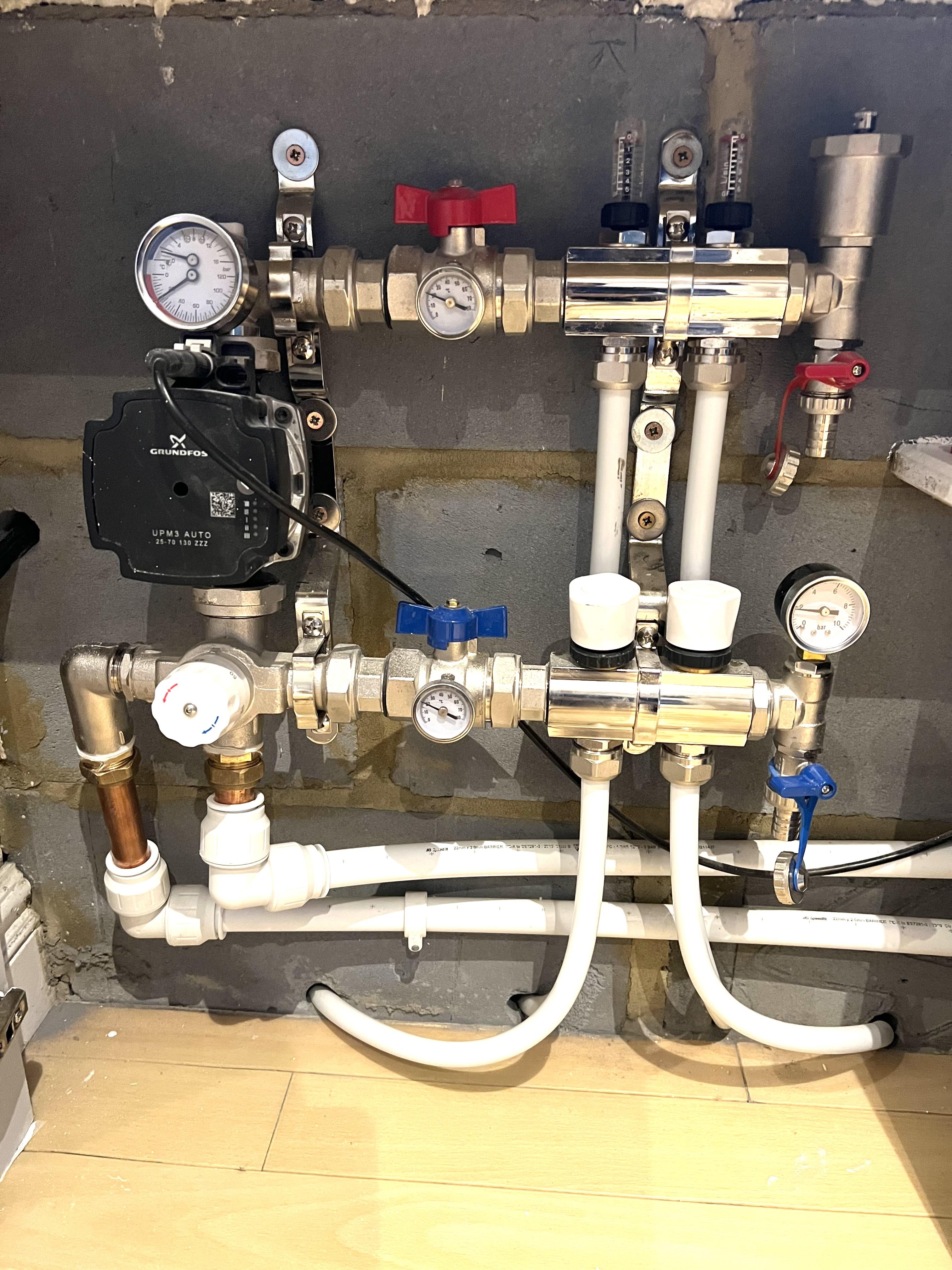

windsor-tg Posted September 3, 2023 Author Share Posted September 3, 2023 Thanks @JohnMo I have just one room that has UFH (all the rest of the rooms have radiators) so I have just one room thermostat to control the UFH. I believe I have 2 loops on the UFH and 2 actuators. I have attached a photo of my UFH manifold and associated components. None of the 4 towel radiators have TRVs. All the other 17 radiators have TRVs. Based on this, is the only solution is to have a buffer cylinder in the return on the CH circuit? Link to comment Share on other sites More sharing options...
JohnMo Posted September 3, 2023 Share Posted September 3, 2023 No boiler would be able to support the UFH without a high risk of short cycling. So you have to options. 1. Leave everything as it is add a buffer, so if your UFH has 160m of pipe that's about 25l of water, so you need a 25l buffer. 2. Don't install a buffer, but have a rationalisation of the TRV's and zoning. So you always have a decent circuit volume open. You would need to do some balancing of the radiators to keep the room from overheating. Having the towel rads as a buffer my be the easiest solution. Have them so they are always on if anywhere else calls for heat why If you are going new boiler I would suggest the minimum. Have it set up to run weather compensation, to do this, it will need to be a boiler that will do one temperature for cylinder heating and a different temperature for CH. Don't go low loss header. Get rid of most of your TRV's so the system runs open circuit, but on weather compensation, with a temperature setback overnight. Get the whole system flushed. 1 Link to comment Share on other sites More sharing options...

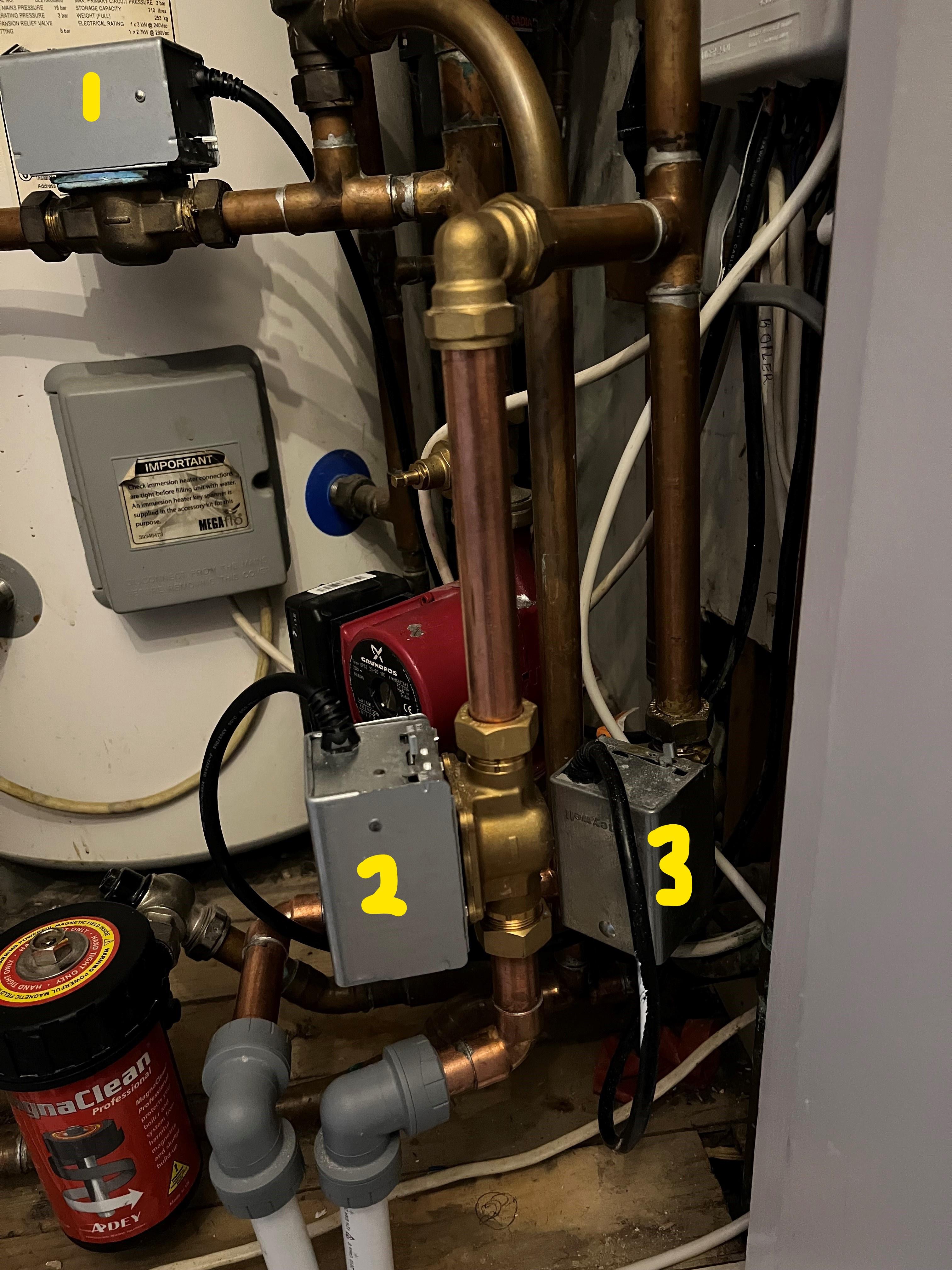

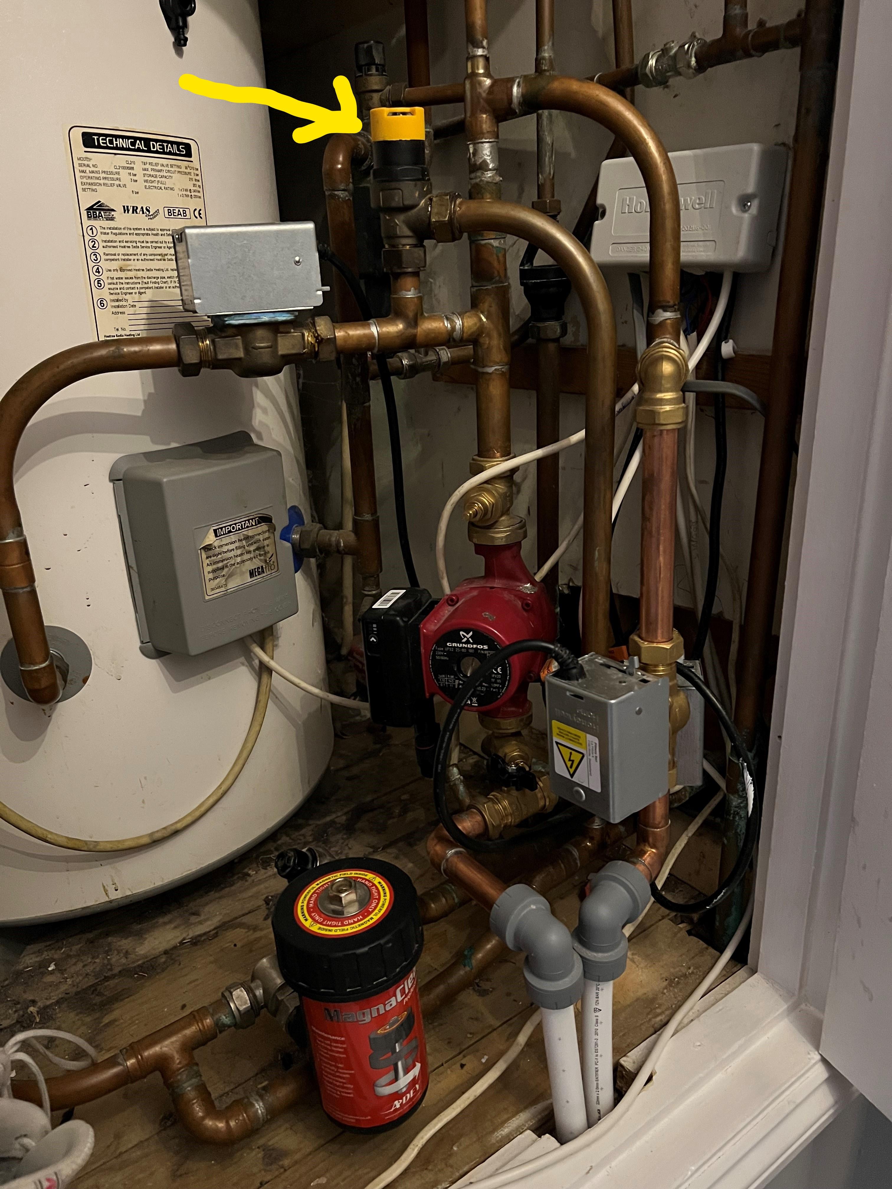

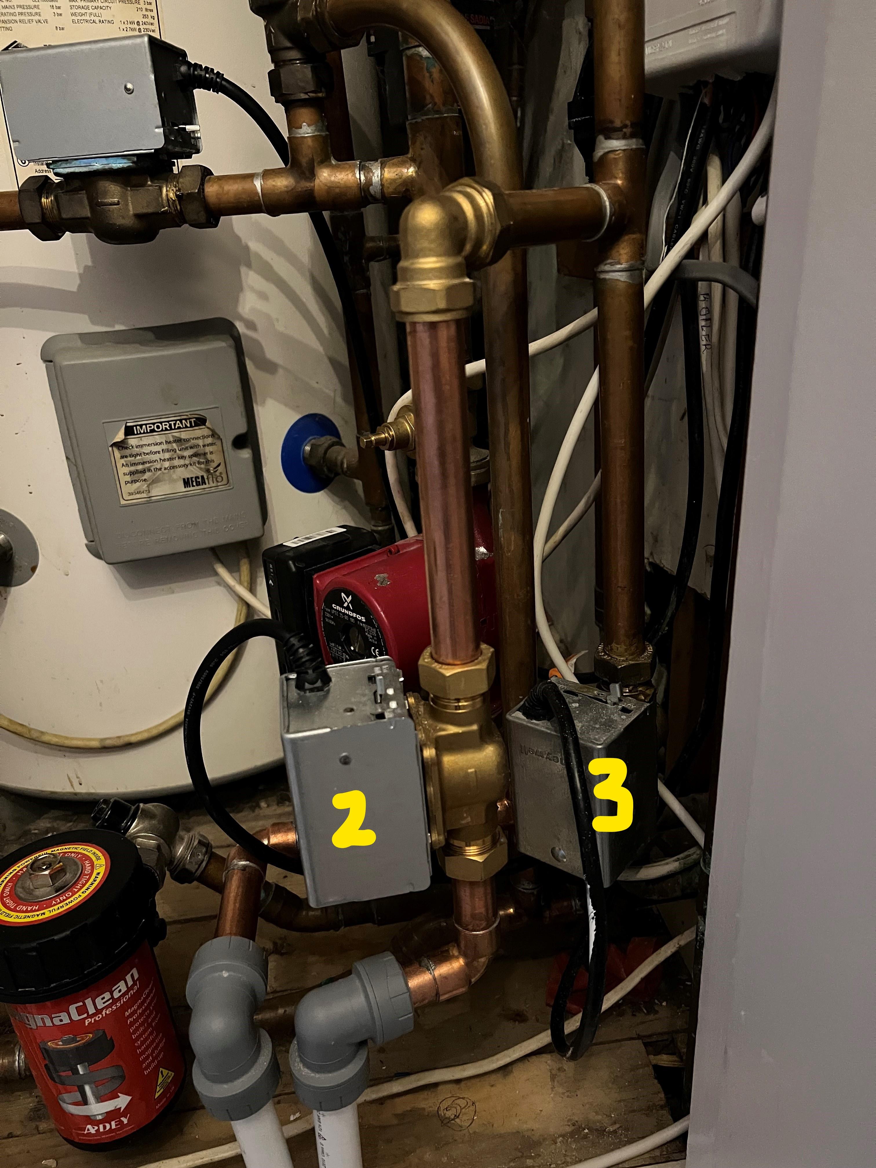

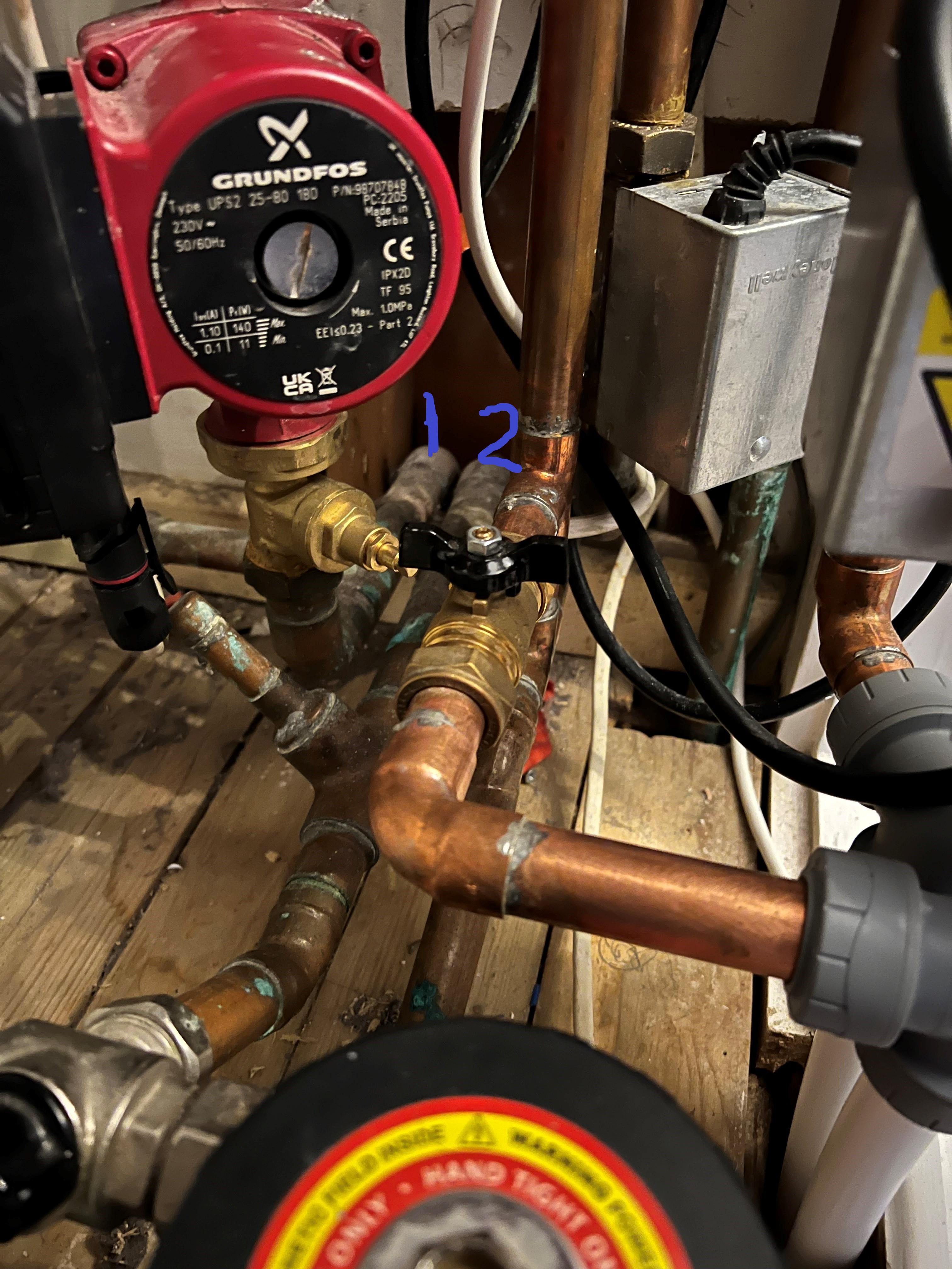

windsor-tg Posted September 3, 2023 Author Share Posted September 3, 2023 (edited) more photos. On the photo 'pipework around pump' - the two pipes labelled '1' & '2' in blue are the 28mm pipes running to & fro from the boiler. The 2 white pipes are the UFH pipes. Edited September 3, 2023 by windsor-tg Link to comment Share on other sites More sharing options...
