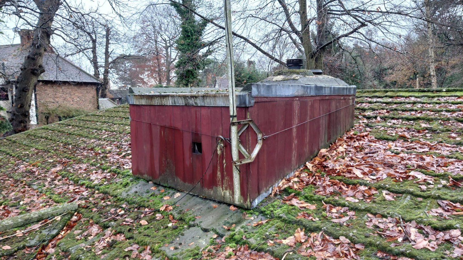

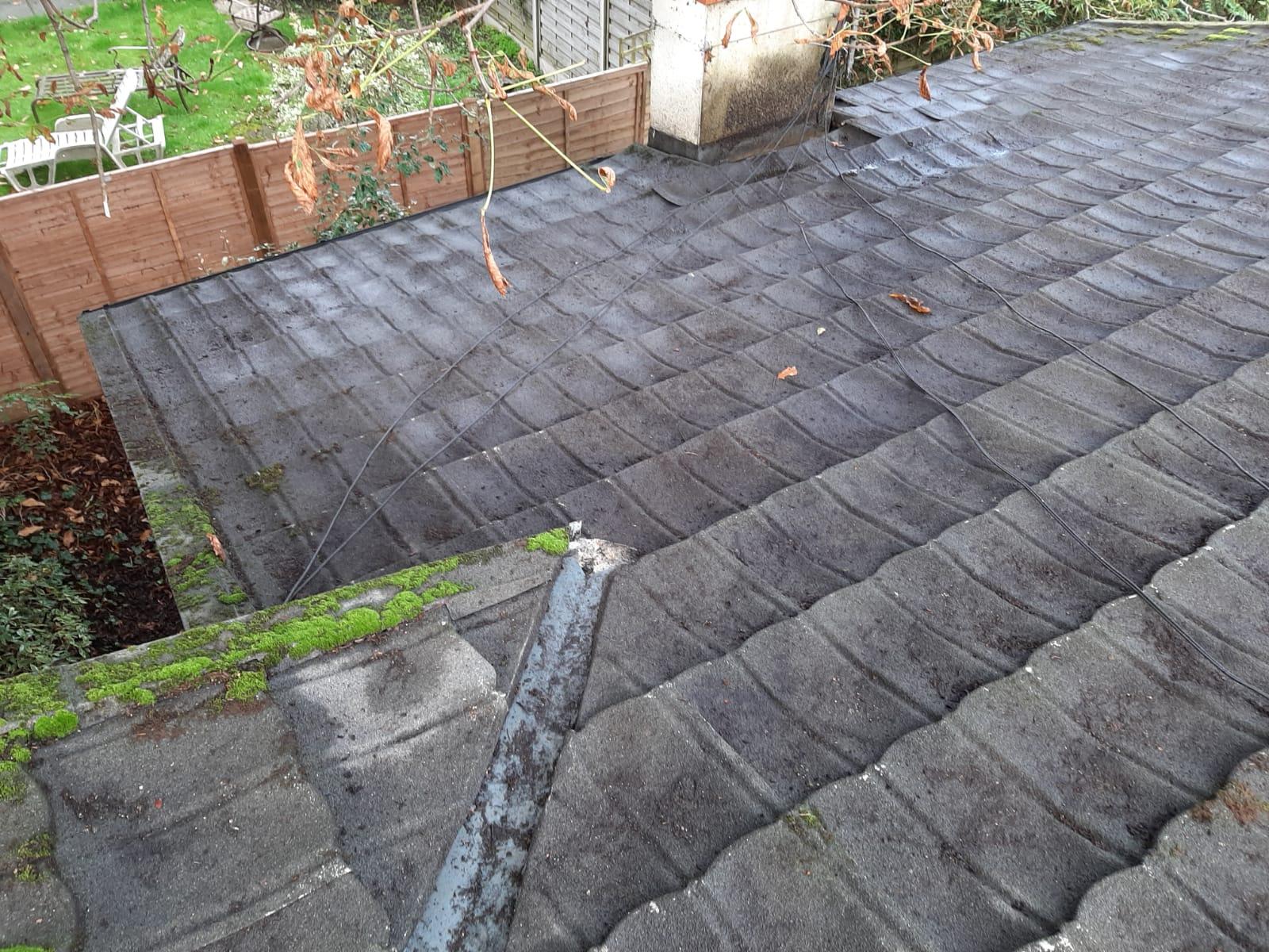

We have a large (c. 280m2) series of sloping cold roofs. These are low angle/gently sloped - I think most/all under around 15 degrees. These have Decra Classic (thin metal composite sheet “tiles”) which may benefit from some repairs (including re-sealing of a large c1.6 x 5.8m angled skylight) and need better insulation.
Parts of the Decra are in poor condition - cracked / banana’ing / patch repaired. However, we’re not aware of any obvious damp / water ingress over the past 18 months or so (though there may have been problems before that, given previous damp issues and repairs). It probably warrants at least some patch repairs.
0ub7D7j8BxK3mc-vQJGymR_2ygib50LwcFkvBlg5F_81LlHjm4cIdndbVjyZlpCKhTta1WlhOHaz9aSFwLIHOgY6UIC-_luLdS_RfbmnnH__UYYGz5ph-N8-7-ld_MUGUbj_KsHCt3E_V_9k2UHPoQ
Angled roof over reception room. Note bending of Decra around chimney (suspect due to weight of leaves which we found there - now cleared)

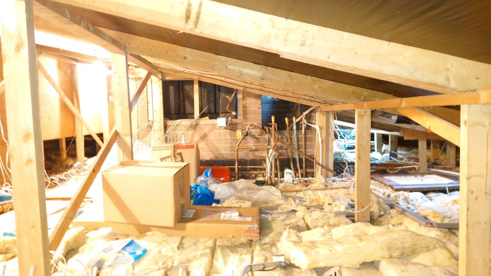

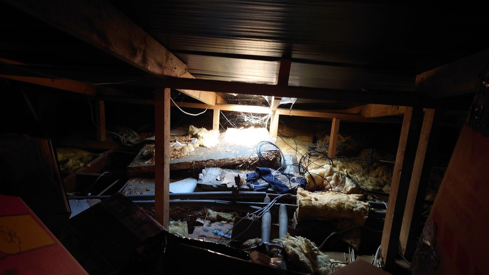

 About half of these roofs (about 180m2) are cold pitched roofs built over a flat roof (which I think was probably the original external roof). For that 180m2 section:
  • Loft is c. 150m2, with a further roof/loft extending over the kitchen (c. 30m2), and further over the car port (though the car port area does not need to be insulated).

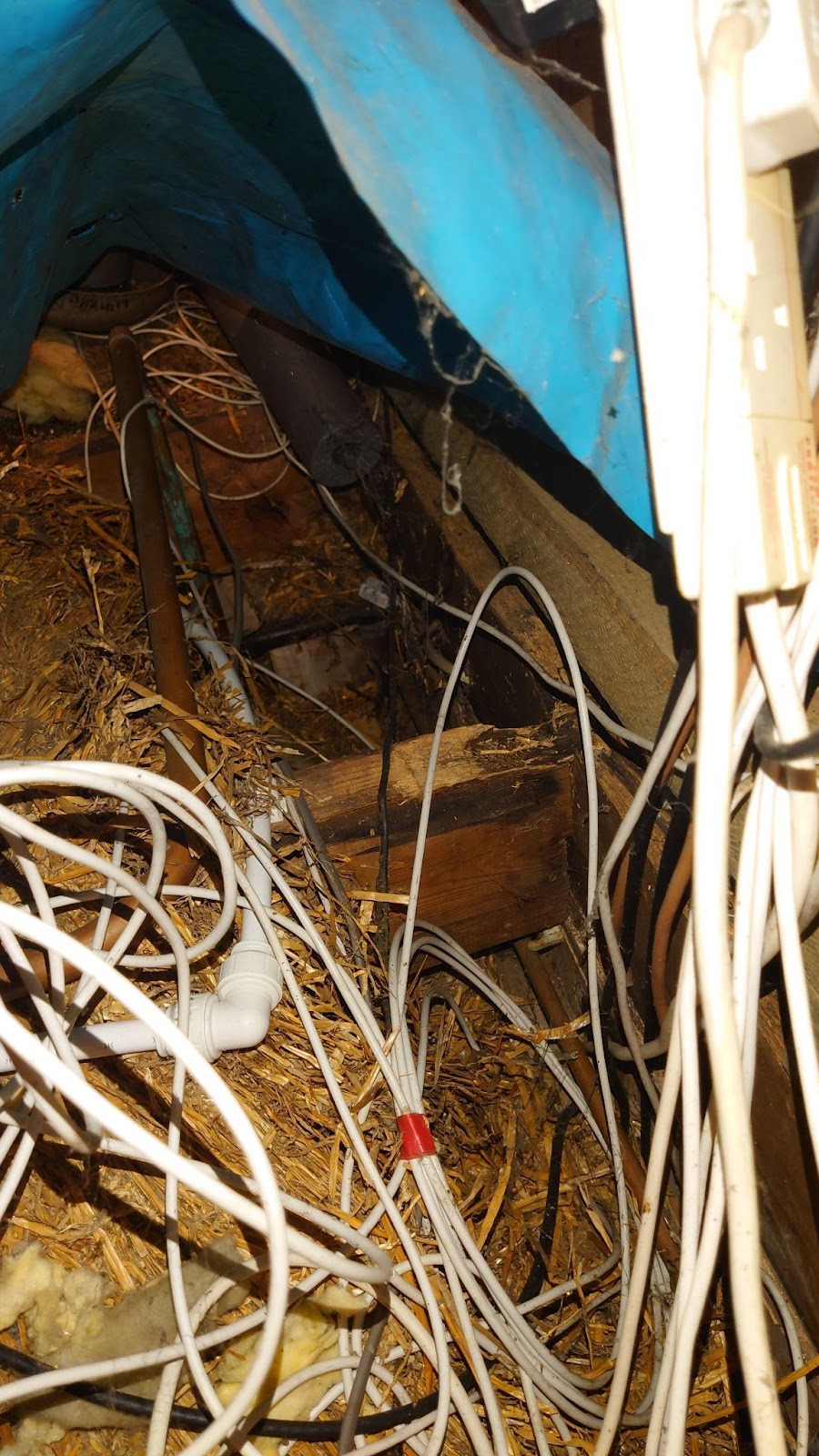

  • Construction appears to be uninsulated joists, topped with a flat roof made of a slab perhaps 75-100mm thick of compressed straw, covered with what looks like bitumen felt (or similar).
  • I think this may have been the original flat roof, probably constructed somewhere between c. 1955-1967.
  • On top of parts of this flat straw/bitumen roof, there's c. 50-100mm of glass mineral wool insulation (see photos); other parts there's nothing or boarded storage.
  • On top of this old flat roof, a lightweight timber frame was built, covered with a black (presumably waterproof) membrane and then sheets of Decra Classic (or similar) lightweight metal/composite roofing “tiles” (with what are I think GRP gulleys). I not sure there’s any OSB or similar between the membrane and the Decra - I suspect not.
  • Rafters are generally 1200mm.
  • Given the lightweight construction and wide rafter spacing, I expect it will only take a very lightweight structure (unless it’s substantially rebuilt/reinforced).
  • Appears to have poor thermal performance / need better insulation. However, given the unusual construction, it’s not obvious to me how best to economically deal with it (and to do so in a way that doesn’t create the risk of condensation issues). Would mineral wool laid out over the old flat roof work? Or PIR? Alternatives would seem to be open cell spray foam, or PIR warm roof - but probably only sensible if re-roofing (which I doubt we can afford).

Loft hatch area showing straw

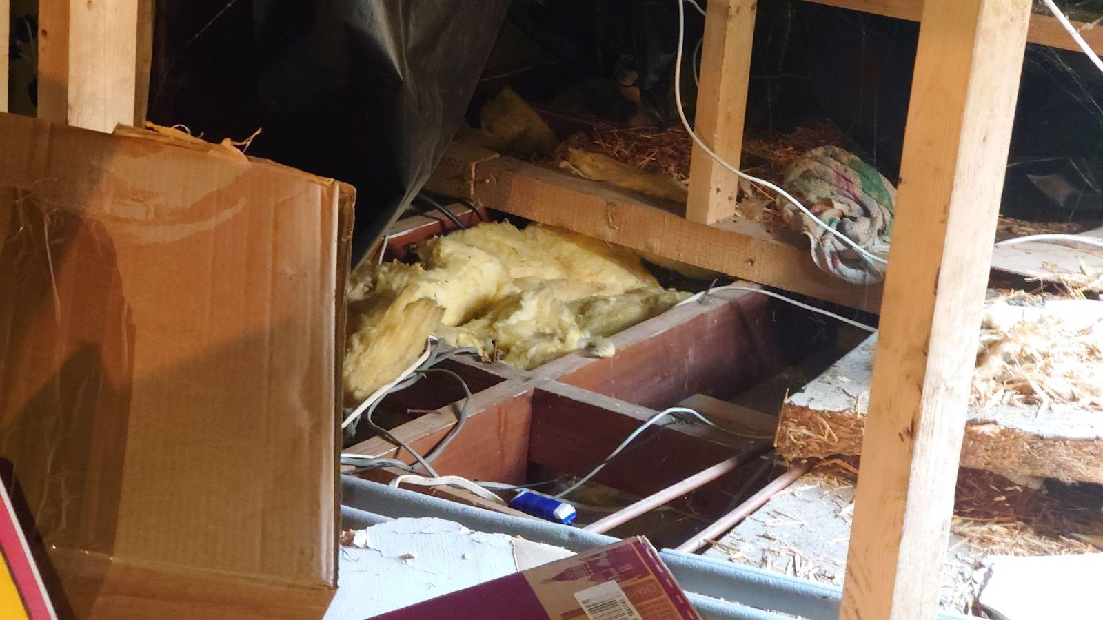

y8r7_7_aGu5Frlkl6FSvbNnSHS44mBYLEW1Tah4qlRth1_LCX_jT3ecRnhUqxZYzvuxckXAvR-RSMV6q688901jUk5J3hSnHcIeuIOBGfby5Dq8x5WoAaI_0iadu-10z0bagUI-0Rdjz2-z8E929PgSection of strawboard lifted to show joists (uninsulated)

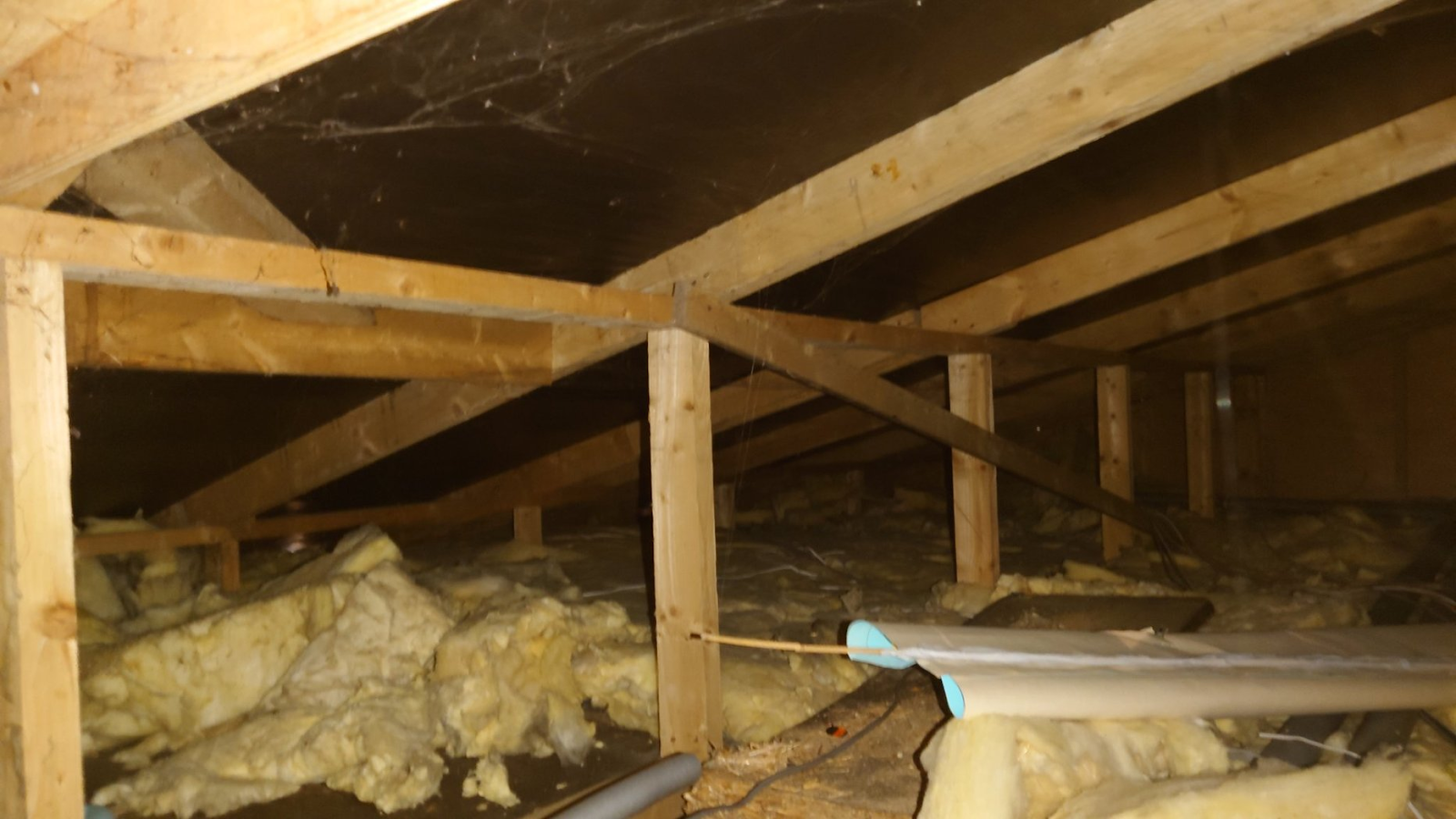

Showing 1200mm rafters etc
1dlIPnikAfhqz_aSag3wYF9ZFcqgdpZvkxtd6besNHjgkPSxbs8pbdOJ-kqEQe5-cZMNh-DYF0lXWajnDGkbhkCITPBkbvKWMOFzRatk8nwny3SgO0vwcaj1Hf7B85Sdx3f9EpwdRHeG
UV542jICJ6Fj1qzgfa-Ud9-KPGlq0cvC9XJEiRknPwMaERFMrLs7kYV-ioUTmsfySiU3gRSs-jfMdgOHm5efYWNrKy-0h6yCGI1x1JpfGz7GL8nolFo4yi-F_pc7xUAdLRnORsZ0tpqTkYhGxQkBXg
Some parts have up to 100mm mineral wool insulation above the old straw flat roof

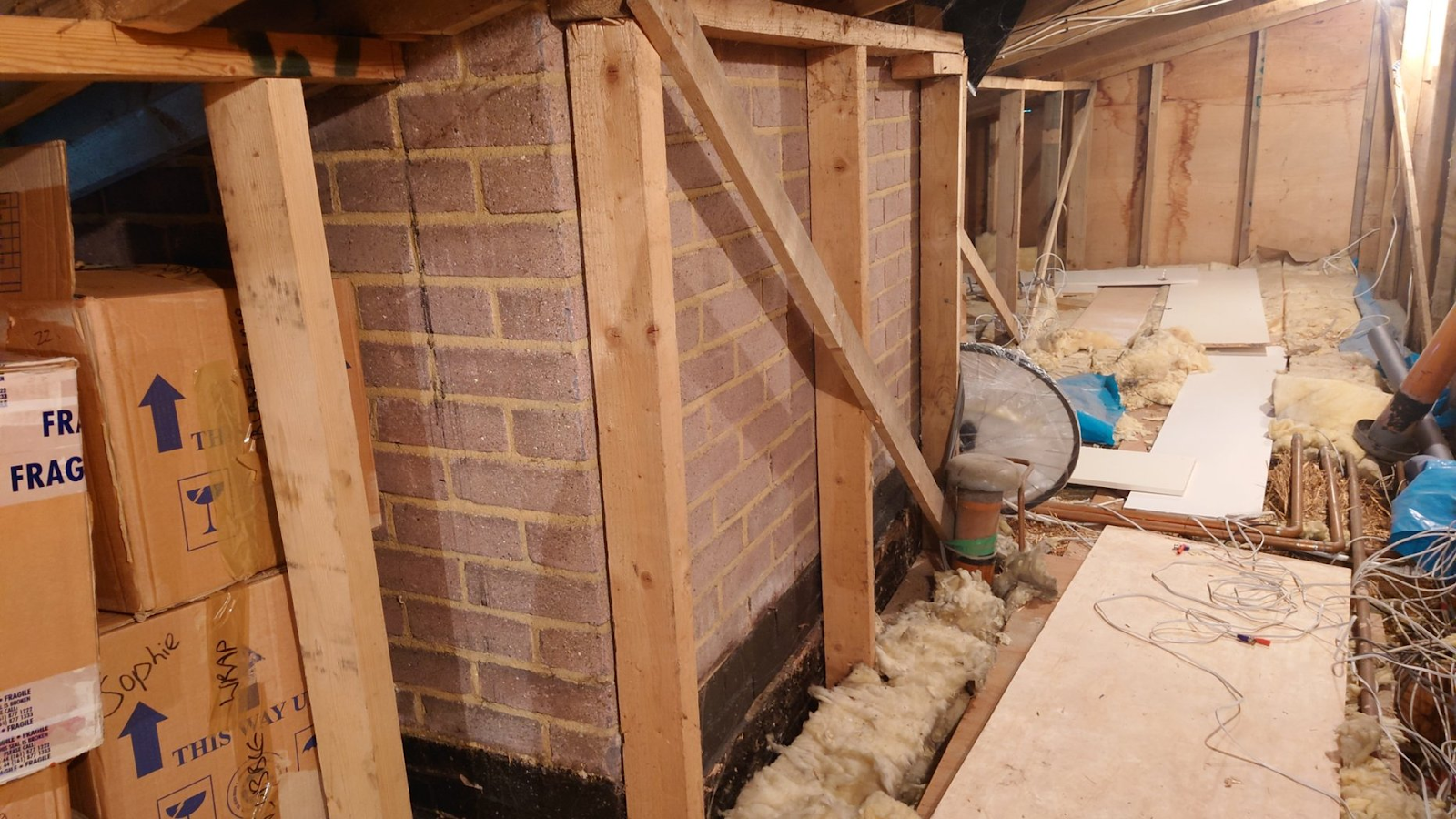

There is a square sectioned wooden clad brick upstand (with TV aerial) in the former, which used to contain a water tank. It’s redundant and could (but need not) be removed if that’s easier. It may be brick beneath the timber (given that it's brick underneath, I suspect it is, so removing it is probably more hassle than it's worth).
