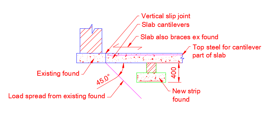

On 29/08/2023 at 14:01, Annker said:
I think there is an alternative method where a concrete ring beam is cast at the base of the footings.
I think I can see where you are coming from. Below is a simple model / sketch.

@Annker The theory around the sketch is well tested. This cantilever slab method is used when you have say a gap site and can't pile up against the adjacent buildings for one reason or another. The above I think results in an independent floor that doesn't impact too much on the existing founds etc. Looks simple as it's a foundation within an existing foundation... but.. the underbuilding will maybe have cross walls etc so it's not as simple as it looks as a sketch!
The new strip found might cause a bit more settlement due to the extra stress on the soil but most buildings tend to fail / protest when the walls move outwards rather than inwards.
In a domestic application you may just have a configuration where this is best solution, not often but sometimes.
