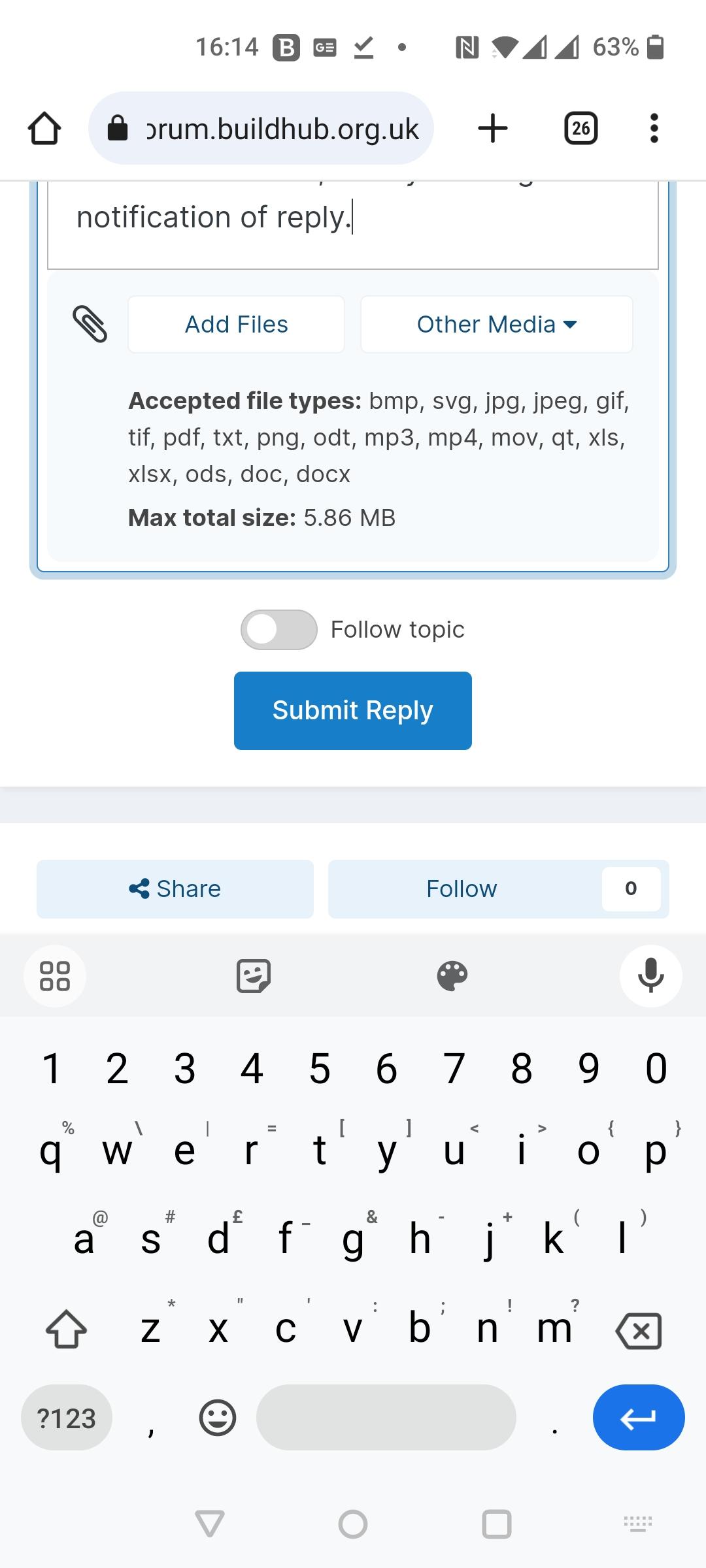

JohnMo Posted September 18, 2023 Posted September 18, 2023 1 hour ago, mickeych said: just getting used to finding responses here! Follow the thread, then you will get a notification of reply.
mickeych Posted September 18, 2023 Author Posted September 18, 2023 3 hours ago, JohnMo said: Follow the thread, then you will get a notification of reply. got it. thanks
