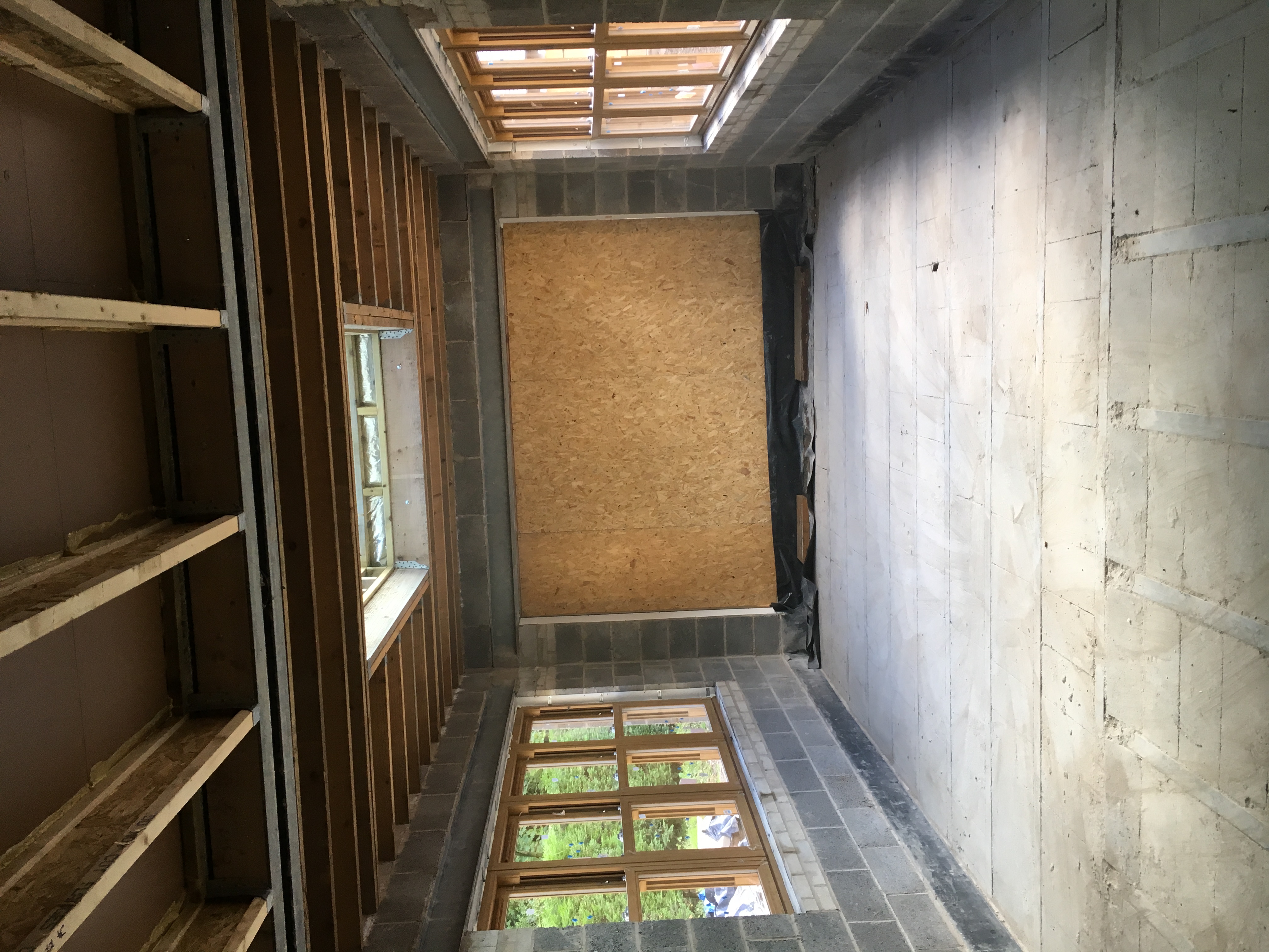

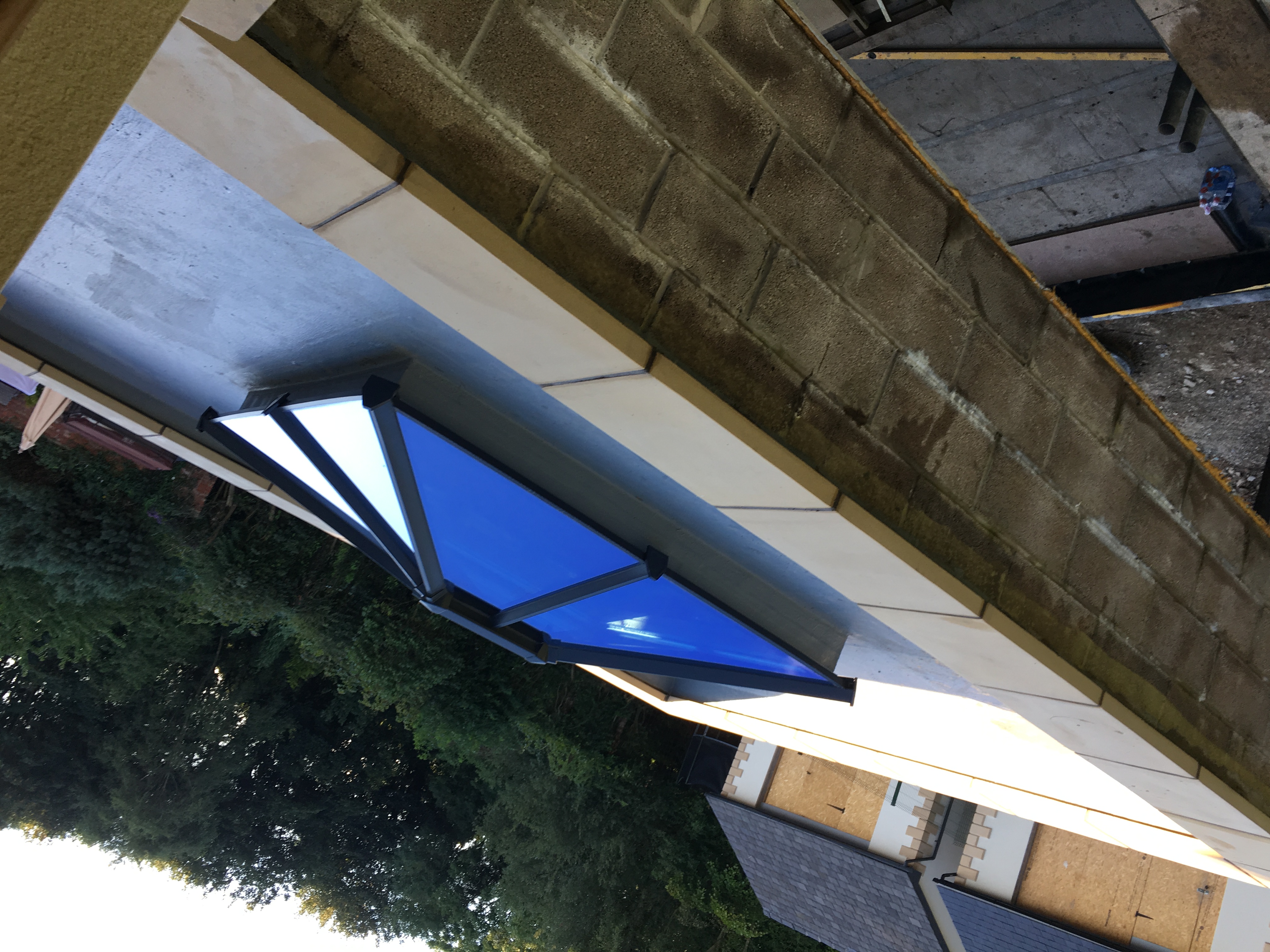

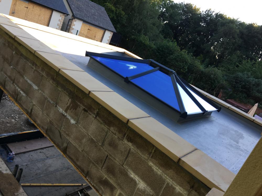

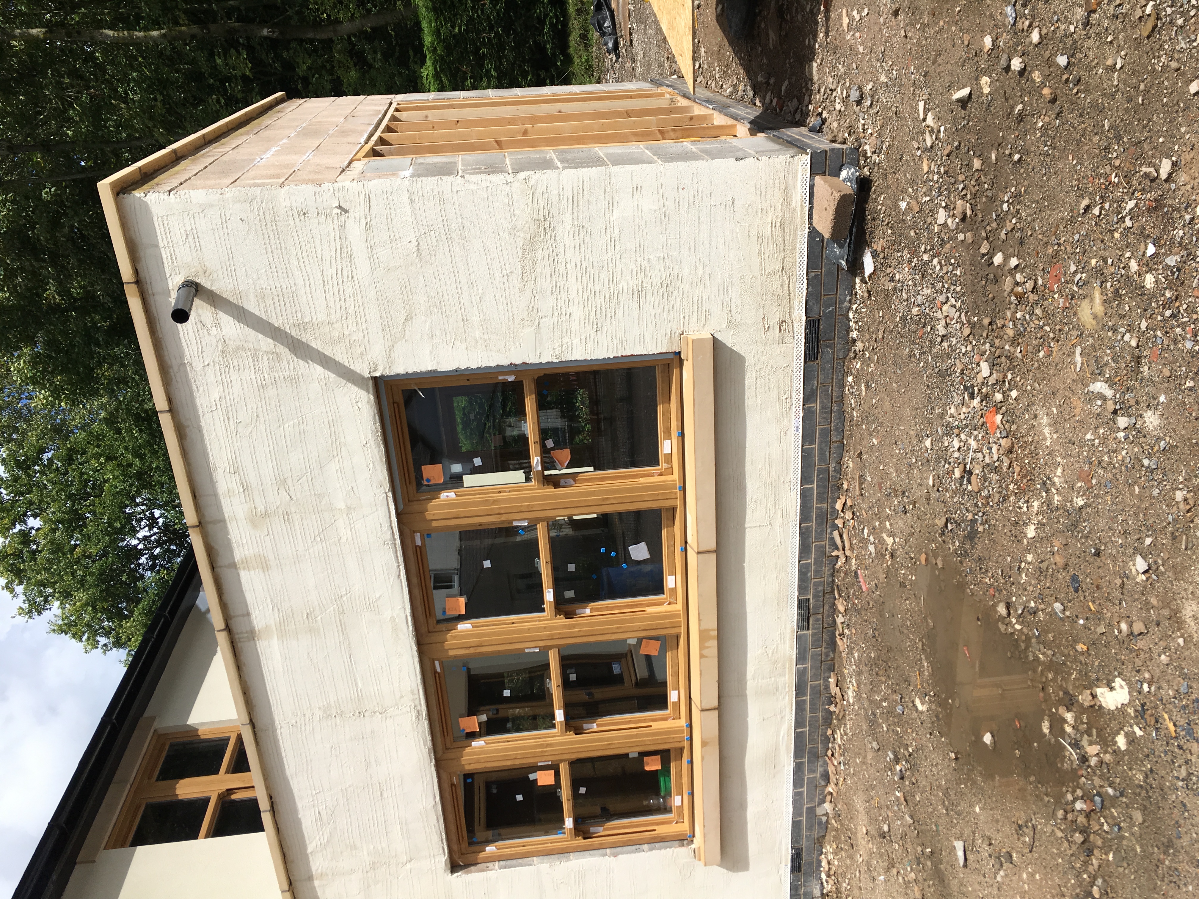

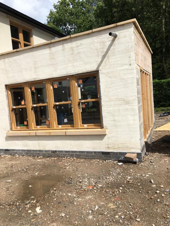

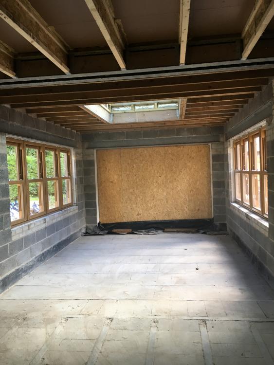

nod Posted August 23, 2017 Share Posted August 23, 2017 We finally took delivery of the copings and lantern for the orangery the local company offered to install the lantern £900 for cash Talk about easy money Very simple to fit It took my wife and myself three hours to install came in kit form and assembled like mechano Fitting the last two sets of four sash windows wasn't so straight forward i had the manufacture and joins in a set of four but had to take all eight sash windows out to unload them 2 Link to comment Share on other sites More sharing options...

nod Posted August 24, 2017 Author Share Posted August 24, 2017 9 hours ago, Ferdinand said: Looks good. How do the two levels of roof work? Thanks it took a bit of thinking about Id run the joists cross ways So I marked out at 400 centres and fixed a 70 x 18 mill strip of ply in the centre of the lantern Both top and bottom and a 10 mil strip 400 either side of centre Then boarded out with 15 mil osb Then the multi layer foil insulation and then I fixed 70 mil down to 10 mil tapers to corispond with the osb strips Which created a nice crown top and bottom then I used the OSB 3 to board it out works really well wgen it rains heaven it pours out of the temporary pipes at the side Ferdinand 9 hours ago, Ferdinand said: Looks good. How do the two levels of roof work? Ferdinand Link to comment Share on other sites More sharing options...
nod Posted August 24, 2017 Author Share Posted August 24, 2017 8 hours ago, MikeSharp01 said: Looks like a neat piece of kit - who supplied it? Hi Mike I went for a Eurocell sky pod main reason being the place were I buy UPVC gutters etc had a mock up on display and it look really solid Link to comment Share on other sites More sharing options...
