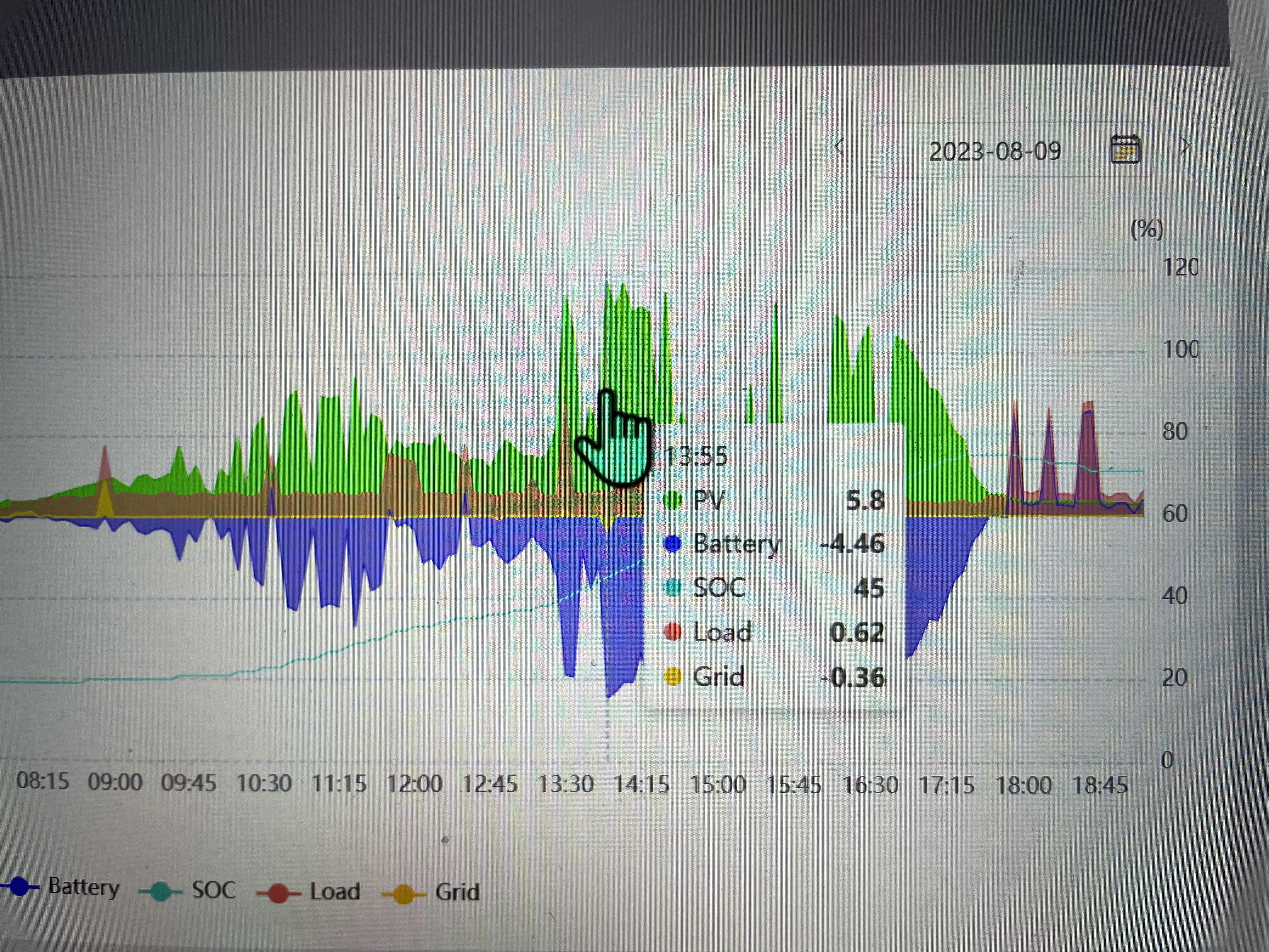

bob the builder 2 Posted August 9, 2023 Posted August 9, 2023 Hi All Just starting to optimise my solar / battery install. here are the key facts and performance stats - PV Facing due south - 10KW system (420w panels / black) - Optimisers on all panels (some shading to lower section in evenings) - Max daily production - 20kwh - Max daily peak production - 5.8kwh - 20kwh battery - Eddi solar inverter would value any thoughts on the performance of the system / ideas on how to improve Bob
SteamyTea Posted August 9, 2023 Posted August 9, 2023 1 hour ago, bob the builder 2 said: Max daily production - 20kwh 20kWh seems a little low. You seem to have a constant base load, can you reduce that?

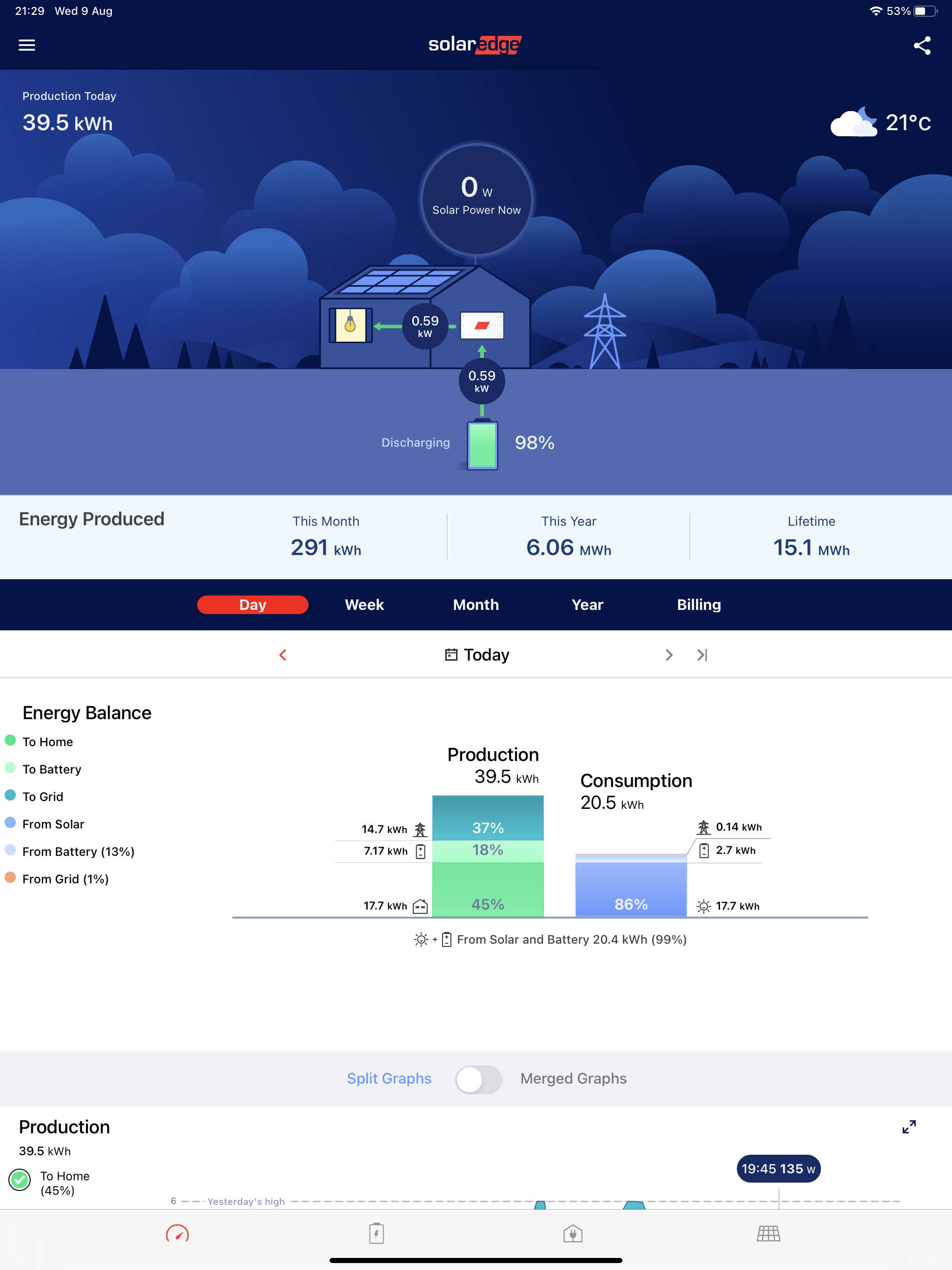

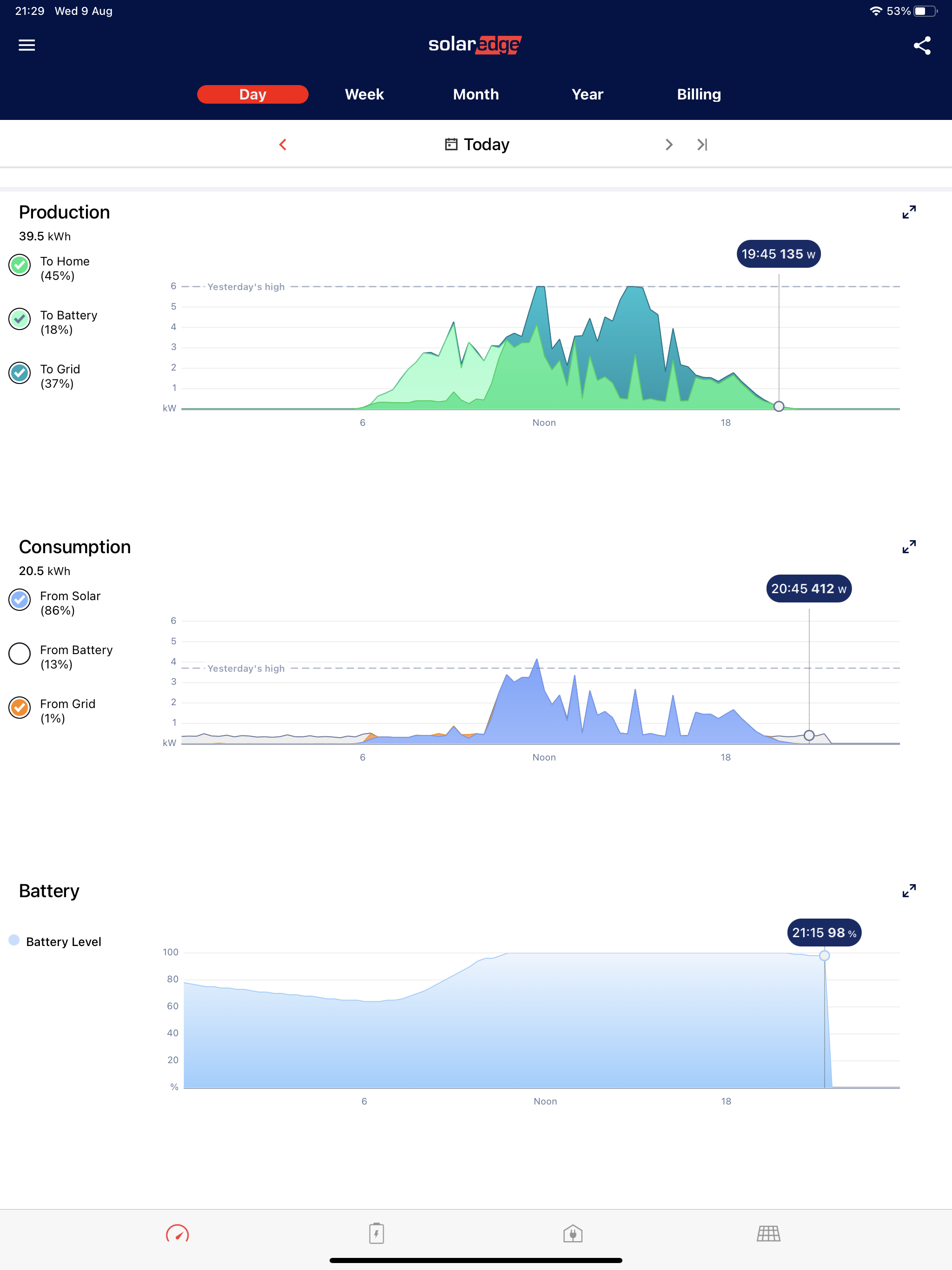

Johnnyt Posted August 9, 2023 Posted August 9, 2023 (edited) That does seem low but clearly dependant on what kind of a day you’ve had. Our system is similar in many ways 10.02 kWp over 3 orientations with 2x 9.7 kWh dc coupled batteries and an immersun dhw diverter. Here’s our stats for comparison. What neck of the woods are you in? We have 2 strings over 3 arrays all optimised. Edited August 9, 2023 by Johnnyt
