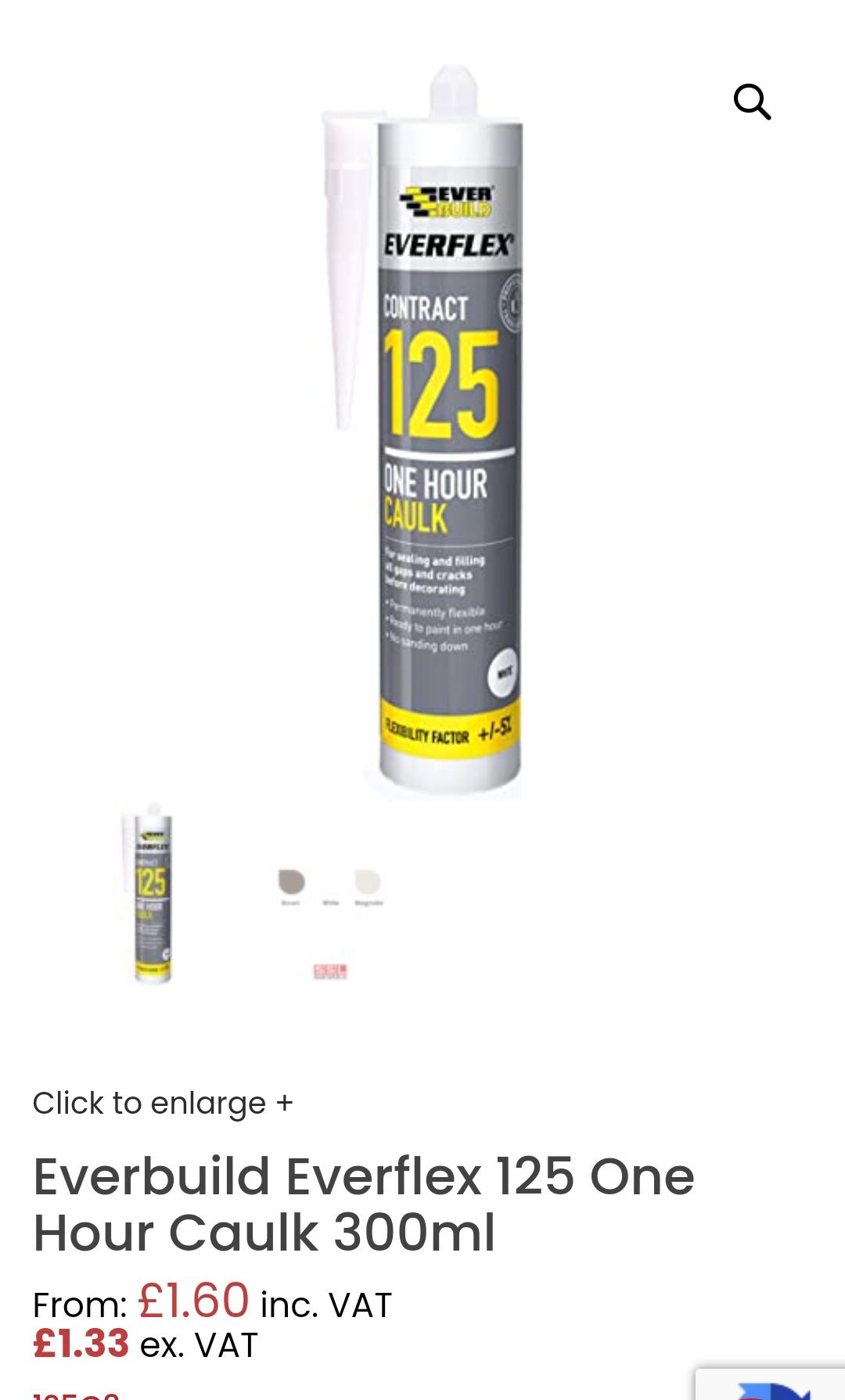

2. Do you have any recommendations for "permanently flexible sealant"?
Probably not the best person to ask but here's a suggestion.
1 hour ago, vagrantly3893 said:
Screenshot_2023-08-10-17-20-28-739_com.android.chrome-edit.thumb.jpg.57d9590e2237ee53e2a40356a4051b98.jpg

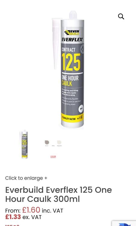

For the caulk, is it also a good idea to tape over the joints after caulking with don't vapour barrier tape?
Again you can tape if you want it won't make much difference.
The main aim of the caulk is to stop as much of the bulk air from escaping from the house into the roof. As you're in an old barn its probably fairly "holey" anyway so I wouldn't sweat it. There's lightly plenty ventilation in the roof so I would stay away from trying to create a vapour Barrier anywhere.
