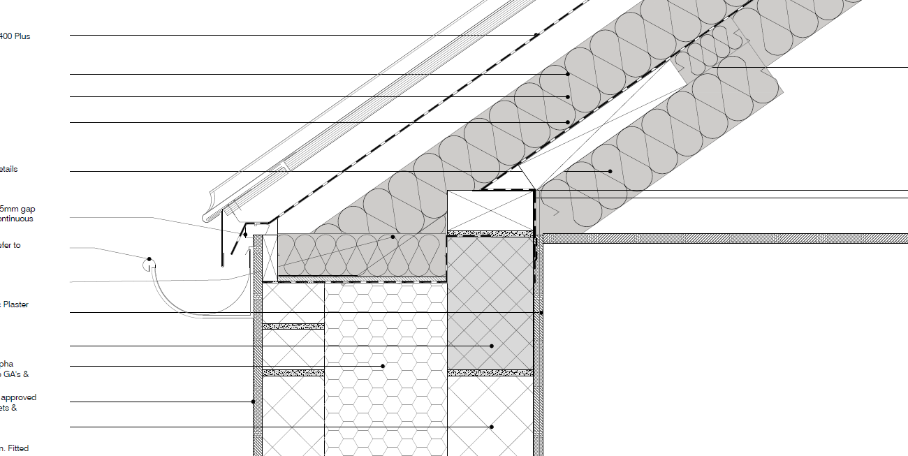

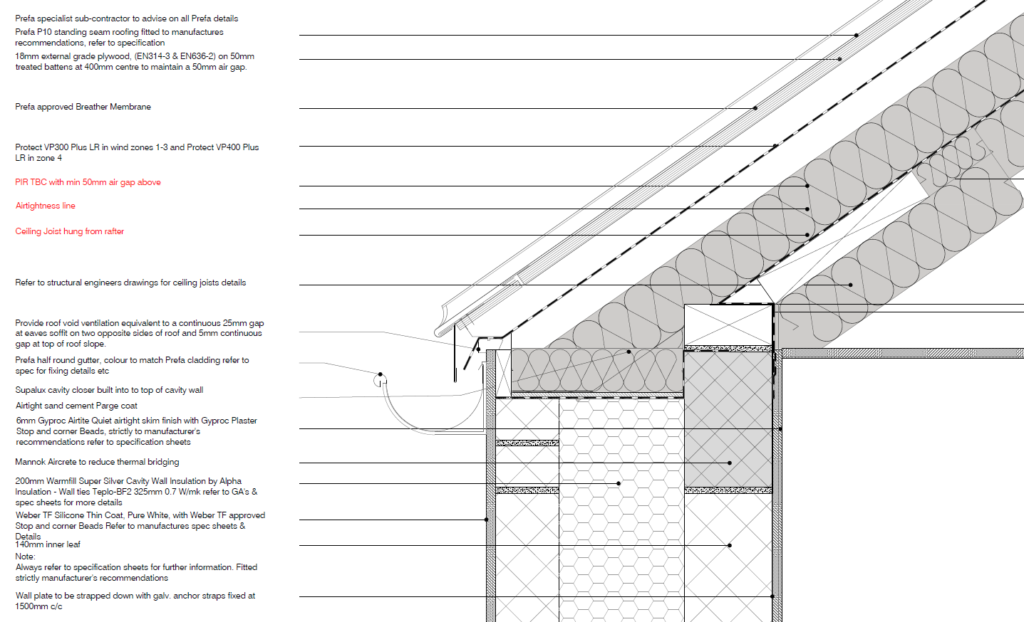

Mr Blobby Posted July 30, 2023 Share Posted July 30, 2023 (edited) Sorry if this is answered elsewhere but here goes... Following the warnings on here about warm/hybrid roofs we are going for a cold roof over a warm loft construction. Well I thnk we are, I've not done this before, hence the need for some guidance on here. The proposal from the architect is like this: 1. standing seam 2. standing seam breather 3. ply 4. batten + ventilation gap 5. breather membrane (replacing old roofing felt type) 6. batten + ventilation gap 7. PIR between rafters 8. Airtight membrane 9. PIR under rafters Cut roof hanging off two steel beams AFAICS Architect diagram like this: So my questions are: 1. Cutting PIR between rafters seems like a challenge that will end up with lots of air gaps. What about mineral wool between rafters and PIR below rafters? 2. Builder says we can do mineral wool between rafters, full fill up to the breather membrane. The 50mm gap between breather membrane and PIR is not needed for mineral wool. Is that right? 3. Architect says mineral wool is no good above rafters because cold air will blow through it like a wooly jumper on a windy day. 4. Is this cold roof / warm loft thing a typical design? Any general way to improve this? I like the idea of mineral wool for the sound insulation too. Any advice on buildup here very welcome. Edited July 30, 2023 by Mr Blobby terrible spelling Link to comment Share on other sites More sharing options...
Gus Potter Posted July 31, 2023 Share Posted July 31, 2023 Can you post the drawing again as the notes are hidden a bit odd? Also can you post a ridge detail and what you are doing up there? Do you have dormers? what is happening there at that interface? Are you putting an ensuite in the attic? It does look like you have some kind of hybrid roof, I have nothing against them but you need to understand how the tiles are fixed, vapour control.. what you have posted looks far off what you need to certify the design is ok both in terms of insulation and tile fixing. Oh and lastly has anyone thought how all that is going to work structurally? Can you tell us a bit more about that? Link to comment Share on other sites More sharing options...
Chanmenie Posted July 31, 2023 Share Posted July 31, 2023 Mineral wool is not as efficient as PIR. And if the rafters are plumb and square cutting the PIR should not be over challenging plus you can seal with gapotape or airtight foam. Have a look at Robin Clevit videos he shows a jig he made for cutting PIR that will keep the blade straight and true. Im cutting PIR for my roof using two layers, 100mm and 75mm as thinner sheets are much easier to cut than one thick one, plus I’ll have a better chance of achieving the airtightness. Link to comment Share on other sites More sharing options...

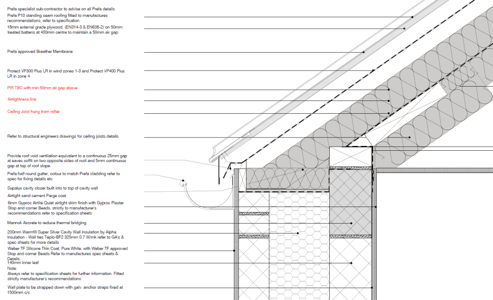

Mr Blobby Posted July 31, 2023 Author Share Posted July 31, 2023 12 hours ago, Gus Potter said: Can you post the drawing again as the notes are hidden a bit odd? Here you go... 12 hours ago, Gus Potter said: Also can you post a ridge detail and what you are doing up there? Good question. No ridge detail available yet. I assume it is vented. 12 hours ago, Gus Potter said: Do you have dormers? what is happening there at that interface? No Dormers 12 hours ago, Gus Potter said: Are you putting an ensuite in the attic? No plans to do that. 12 hours ago, Gus Potter said: It does look like you have some kind of hybrid roof, I have nothing against them but you need to understand how the tiles are fixed, vapour control.. what you have posted looks far off what you need to certify the design is ok both in terms of insulation and tile fixing. Roof will be covered in standing seam aluminium, so no tiles. Is there anything missing here? 12 hours ago, Gus Potter said: Oh and lastly has anyone thought how all that is going to work structurally? Can you tell us a bit more about that? Well I hope the SE and architect have figured this out right! AFAICS there are two steel purlins supporting the roof. Otherwise roof is standard 35 degree cut pitched roof with gable ends, not a hipped roof. No dormers. Link to comment Share on other sites More sharing options...
Mr Punter Posted July 31, 2023 Share Posted July 31, 2023 17 hours ago, Mr Blobby said: 1. Cutting PIR between rafters seems like a challenge that will end up with lots of air gaps. What about mineral wool between rafters and PIR below rafters? Yes you can do this but lower insulation from the mineral wool. Use Rafter Roll 32 for good performance. 2. Builder says we can do mineral wool between rafters, full fill up to the breather membrane. The 50mm gap between breather membrane and PIR is not needed for mineral wool. Is that right? Yes. 3. Architect says mineral wool is no good above rafters because cold air will blow through it like a wooly jumper on a windy day. The mineral wool would be between the rafters with a breather membrane above. 4. Is this cold roof / warm loft thing a typical design? Any general way to improve this? Yes it is fairly typical. Make sure your final spec is approved by the standing seam manufacturers. Link to comment Share on other sites More sharing options...
Mr Blobby Posted July 31, 2023 Author Share Posted July 31, 2023 Thanks @Mr Punter 2 minutes ago, Mr Punter said: 3. Architect says mineral wool is no good above rafters because cold air will blow through it like a wooly jumper on a windy day. The mineral wool would be between the rafters with a breather membrane above. My mistake sorry, I meant mineral wool between rafters of course, not above. 🙄 So no ventilation gap is required between breather membrane and mineral wool between rafters. That's good. Our architect seems to be keen on PIR between rafters. Not sure why. We can hit our target u value with 150 mineral wool between rafters and PIR under rafters ok. Detail diagram has airtigtht membrane placed between layers of insulation. I would have thought easier to install the airtight membrane under the insulation. At the purlins the membrane is just taped to either side of the steel I reckon. Under, over, does it matter? Link to comment Share on other sites More sharing options...
