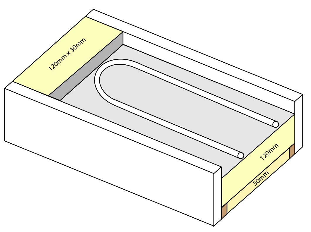

The build-up for my suspended floor is the same as the attached image. PIR 120mm but less in places where it was necessary.
My question is, the area where the support battens are, that's a void there. Would there be any benefit in running a membrane under the joists and laying in a 50mm fibreglass roll in that void area? I could also potentially friction fit/foam in another pir board of 50mm.
Was just wondering if a PIR/fibreglass roll combo would provide any additional benefits. I'm aware you need twice as much fibreglass to be comparable to PIR but a mix of materials might provide untold benefits?

The more the better, is the simple answer. If you can robustly add 40mm or 50mm of PIR to the existing 120mm then you'll have a very good level of insulation (U-value). What would make this all a waste of time is ventilation heat loss (drafts) around the perimeter, up behind the skirting, and tenting into the dwelling.
How have you planned to kill this off?
I was going to go with expanding foam all around the perimeter? Seems to be the easiest way and what I've done in the past.

Any genius suggestions on how I attach? The top layer is resting on the battens obviously but the lower board will have nothing underneath it.
Nails angled downwards slightly? I don't have the room underneath to get a driver in to attach any supports.

 Illbruck 330 ordered and i have all the insulation in and to be foamed. Filled the "batten void" with 50mm PIR with the 120mm resting on the battens.
Would i be right in thinking that i should create an insulated barrier from where the pug/biscuit mix goes to the end of the joist run to avoid it losing heat into the wall? like this crudely drawn image (without biscuit mix shown)
Yes, but 120mm is a lot for perimeter insulation. 50mm would suffice, and will retain more heated m2 of floor area.
