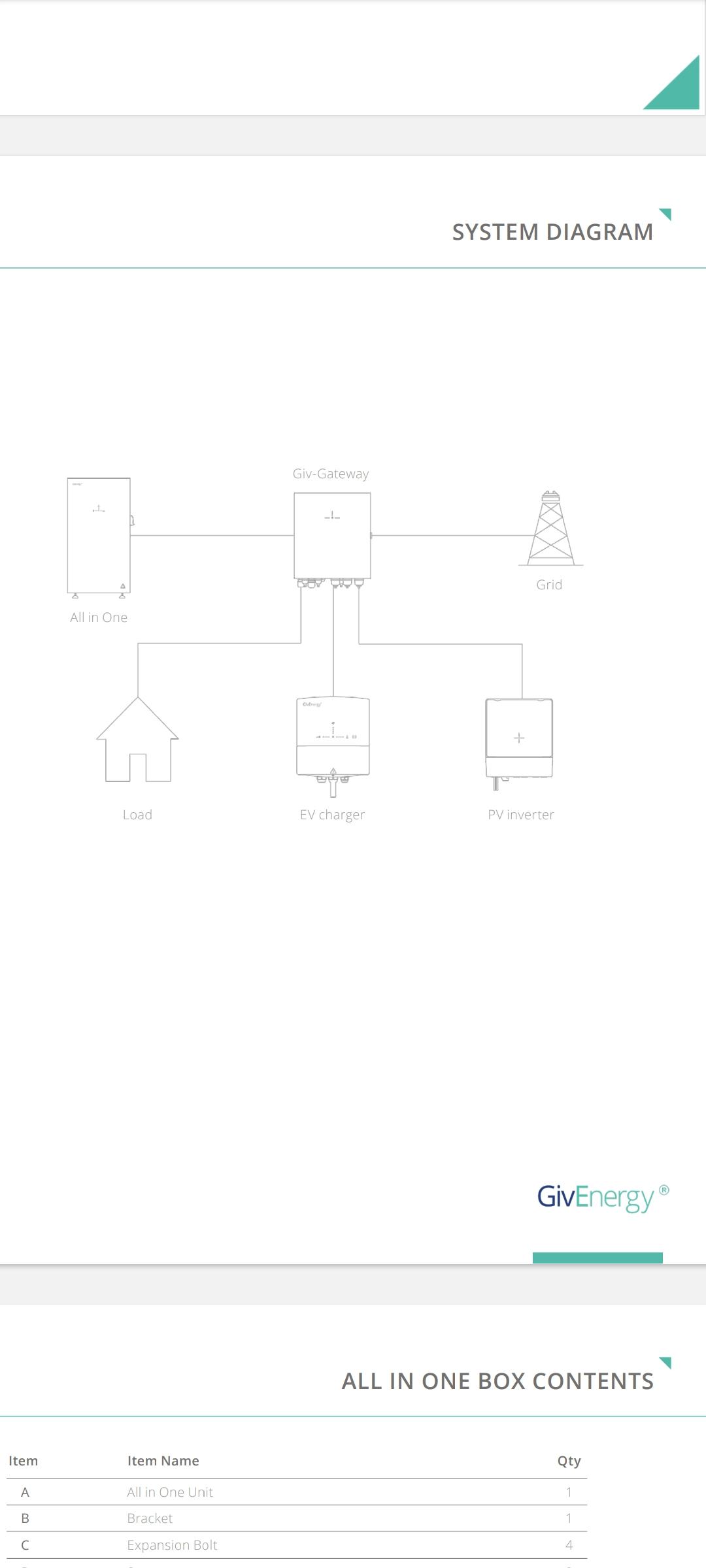

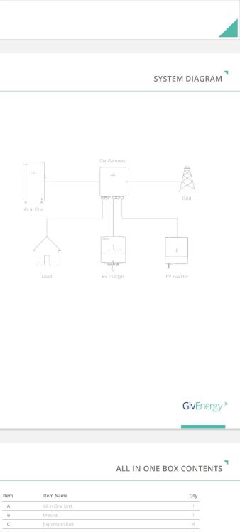

3 hours ago, kommando said:
So a G99 Inverter without being islanded in a powercut
No sure it is, the inverter, battery, PV and mains all connect into the gateway.
The gateway manages it, think only it and the Tesla battery are certified to operate like that. Connects like this,

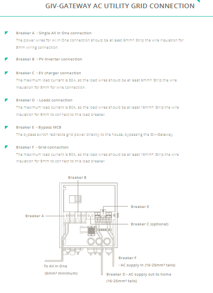

AFIUI the anti-islanding is provided by the Gateway not the inverter itself.
N.b. since that is >16A (3.68kW) it does not qualify for install-and-notify so I think (rules vary) you will have to get your DNO's consent in advance, they will check it is on the ENA database which requires anti-islanding relay operates within ?5 secs of grid failure.
Also if they are like WPD were, they will not grant approval without de-rating the inverter to the 3.68kW - which is my case is not too bad since inverter has 50A passthrough which gives it a max o/p of 12kW when grid is up.
The SunSynk was only 32A passthrough which IMO is defo on the small side esp as I have electric cooker (or I would have gone for the cheaper 3kVA Victron). But sthg you should perhaps check for the Giv, I can only find mention of 25A cont, 32 pk so maybe those are the upper limits.
Incidentally I note it has an integral bypass at B below and also provision C for EV charger.
