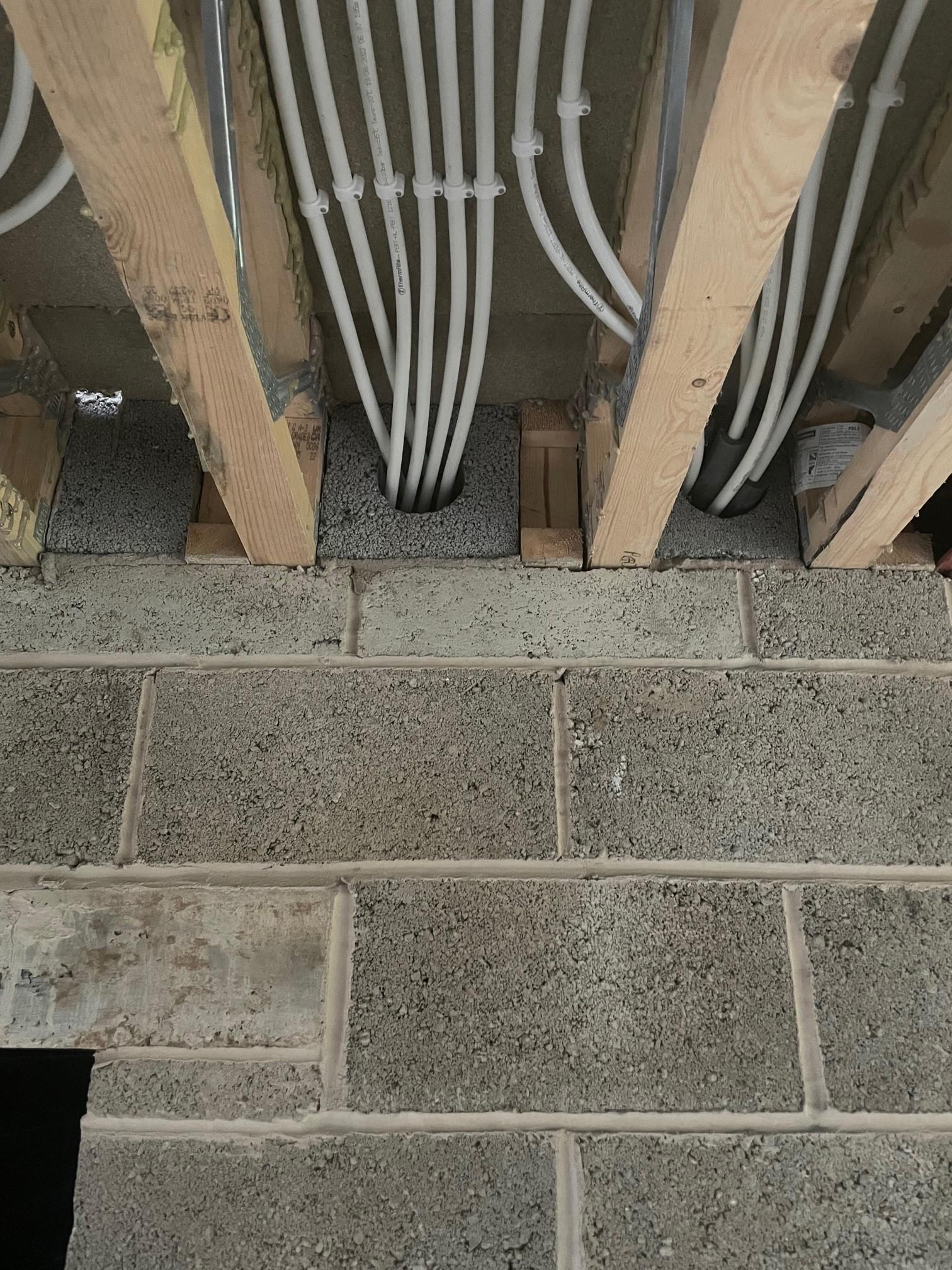

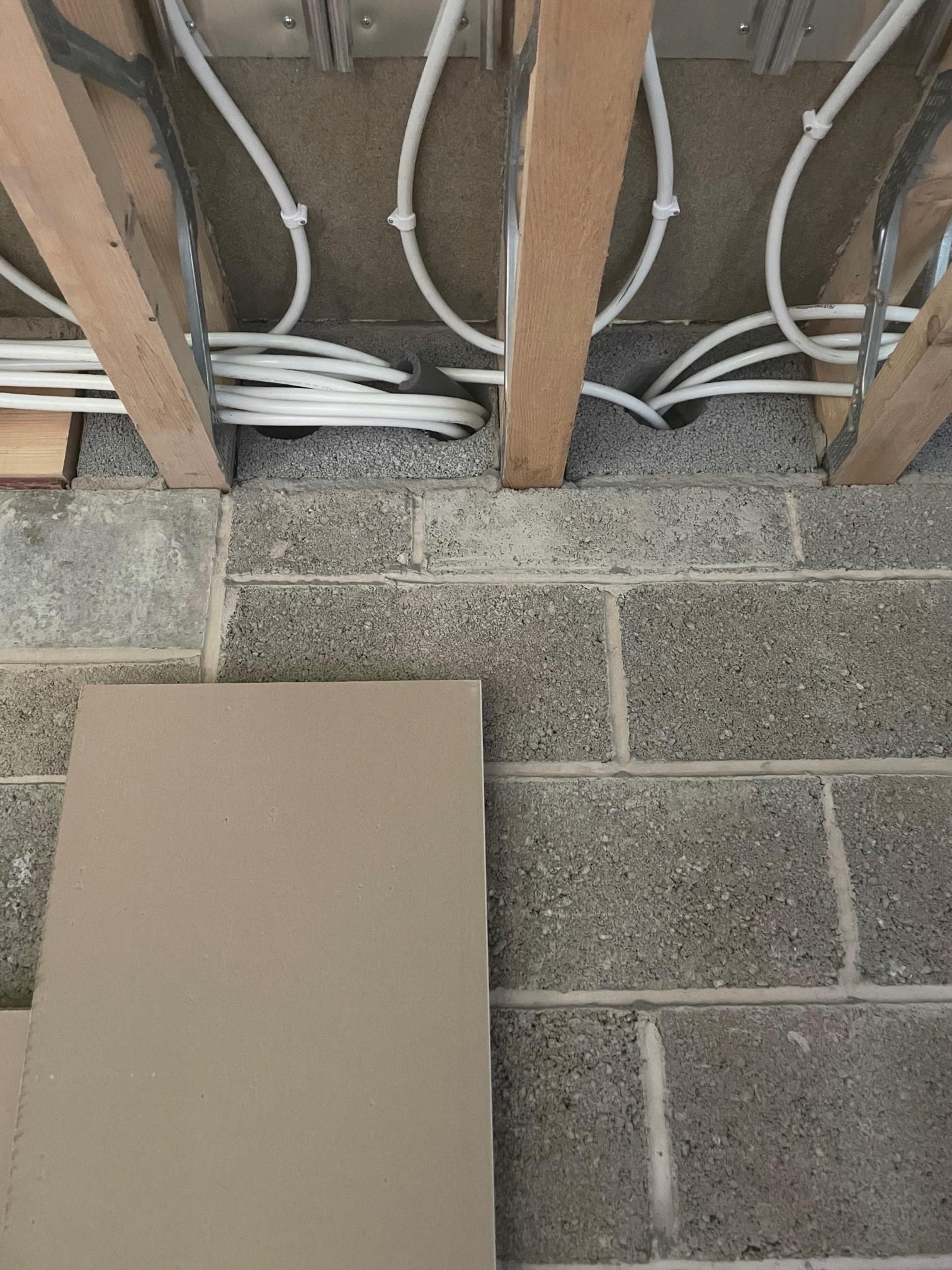

I have installed my 1st UFH pipes on fit from below pipes and due to the layout of house (and steel beams) the routes of my pipes were a little awkward
I had to route them together in places to get back to my manifold. Please the images attached...are there any issues with grouping them like this?
It is the Pert-Al-Pert pipe, i attempted to insulate some bits using standard pipe insulation but i can only get a few on due to the size. I have tried to keep them physically separated but in some cases i think they might be touching

Personally I would have put them in short lengths of flexible conduit. You can still do this by splitting the lengths and snapping them on.
Good idea! I will most certainly do that
Thanks again
Or go on somewhere like 12volt planet or most automotive electric wholesale places, you can buy ready split.
