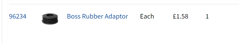

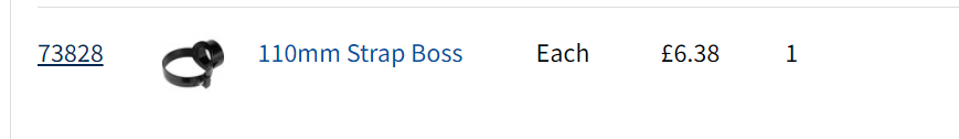

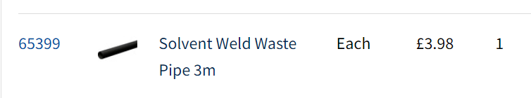

Blooda Posted July 26, 2023 Share Posted July 26, 2023 On 24/07/2023 at 11:22, richo106 said: Daft question - how do I know what drain discharge I am configured for? Not a daft question at all, the configuration Is not entirely clear, and I think there is bit of translation error. In the darkened loft reading the instructions, I initially took the vertical discharge and horizontal discharge as being the configuration of the extract duct to outside. Vertical is where the extract to outside is where the spigot is from the top [as supplied] Horizontal is where you moved the extraction spigot to the side. but that didn't make sense. And tech support were not entirely clear either but did say you only need one. Configuration:- 22mm with a fall to near the Hepvo [copy] One of these:- Then 32mm connected to the Hepvo Hepvo 32mm pipe to 110m strap boss to downpipe A few clips along the way. And insulated if in a cold loft. January 22 prices, That Strap Boss is now £8.88 - 39% Increase Link to comment Share on other sites More sharing options...
