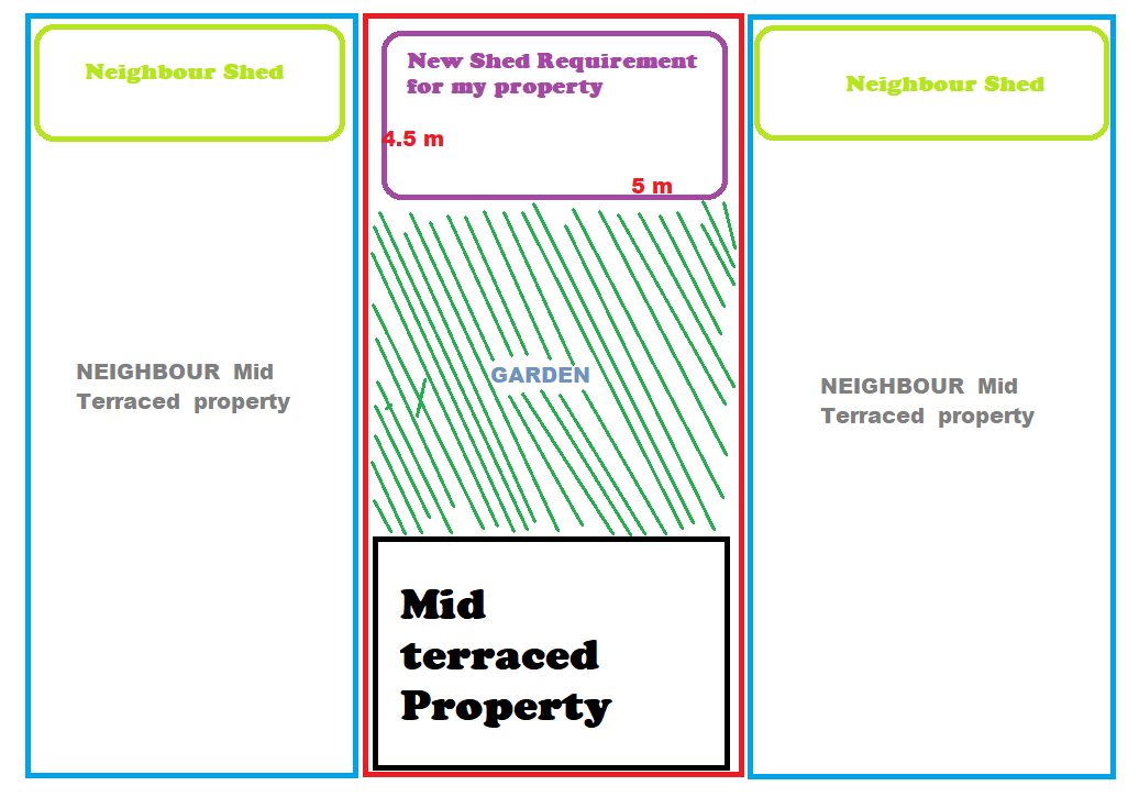

Janan Jai Posted July 12, 2023 Share Posted July 12, 2023 (edited) Any other questions, please ask. Below are the details and image attached for your reference. Size - 22.5 square metres Rough Size - 5m x 4.5m Council - Newham Type of the new build - Garden shed Property - Mid terraced Property age - 1920's built Purpose of the shed - Storage only PVC double door and one window concrete block built (I believe the builder may use a little bit of bricks ? Height - Wont exceed 2.5m Power supply with lights to the shed Tile flooring No water supply or beds to be placed inside the shed. Will only Just storage. Felt roof Will be leaving 50cms of space on 3 sides of the shed (left/right/back sides) for moving around if required Attached image Edited July 12, 2023 by Janan Jai Link to comment Share on other sites More sharing options...
joe90 Posted July 13, 2023 Share Posted July 13, 2023 As long as you still have permitted development I believe you do not need planning permission or building control. 1 Link to comment Share on other sites More sharing options...
ToughButterCup Posted July 13, 2023 Share Posted July 13, 2023 (edited) No. https://www.planningportal.co.uk/permission/common-projects/outbuildings/planning-permission We are not experts. Just interested amateurs. Do not rely on our informal opinions. Edited July 13, 2023 by ToughButterCup 1 Link to comment Share on other sites More sharing options...
Temp Posted July 13, 2023 Share Posted July 13, 2023 You won't need Building Control Approval as it's "constructed substantially of non-combustible materials". If you changed to a timber construction then you woukd require Building Control Approval. 1 Link to comment Share on other sites More sharing options...
joe90 Posted July 13, 2023 Share Posted July 13, 2023 24 minutes ago, Temp said: You won't need Building Control Approval as it's "constructed substantially of non-combustible materials". If you changed to a timber construction then you woukd require Building Control Approval. Because it’s within a meter of the boundary ( I believe !) 2 Link to comment Share on other sites More sharing options...
