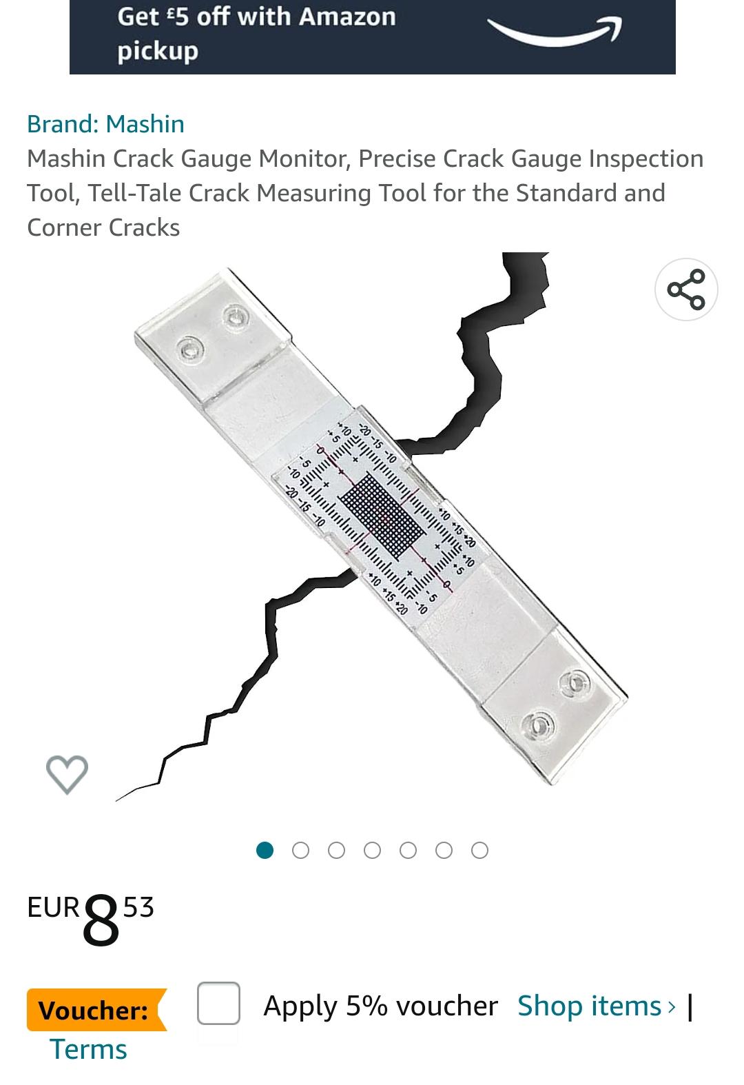

John543219 Posted July 9, 2023 Share Posted July 9, 2023 New double floor extension, just had windows fitted and noticed crack from the top window on the first floor vertically down to bifold below after they went in and were installed. Very good deep foundations with the build at 2.5m so don’t think movement or subsidence (hopefully not)… Should we be concerned??? The exterior is about to be rendered so want to ensure all ok before this is done Any advice appreciated so we can get a good feel for what this might be 👍 Link to comment Share on other sites More sharing options...

Iceverge Posted July 9, 2023 Share Posted July 9, 2023 Put a couple of these on it, take regular pics of it and save it to the cloud. Delay rendering until all movement has stopped. Link to comment Share on other sites More sharing options...
John543219 Posted July 9, 2023 Author Share Posted July 9, 2023 Thanks for this, great advice and will get a few of these on it next week 👍 Link to comment Share on other sites More sharing options...
George Posted July 10, 2023 Share Posted July 10, 2023 (edited) This is most likely due to the concrete blocks shrinking slightly. This happens post manufacture and continues for some months, conditions depending. It can be dealt with by putting in movement joints when blockwork walls are 6m+ (although unusual in domestic settings), but cracks can happen in other circumstances. The line of the wall with a window is a relative weak point so has cracked along that line. Now the crack has occurred, ongoing movement should be minimal. But monitoring will help confirm that. The cracks should be ground out and repointed. If the crack has gone right through I would consider adding in stainless steel helical bars to crack stitch (aka helifix bars) Edited July 10, 2023 by George Link to comment Share on other sites More sharing options...
