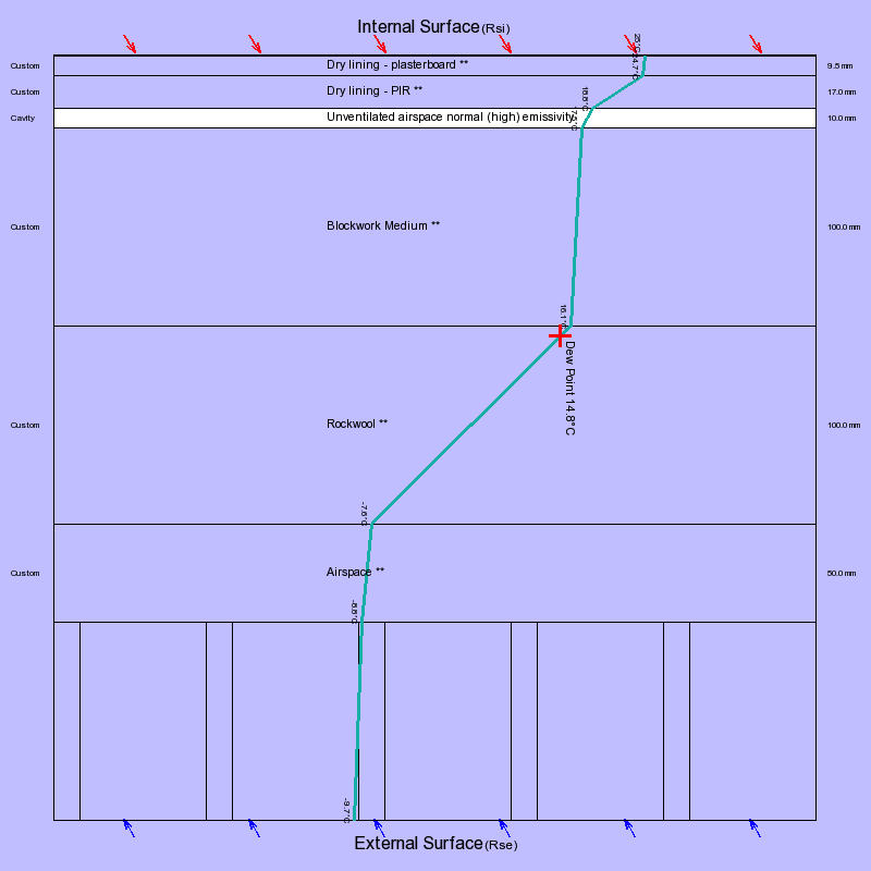

Do I need a VCL in this wall build up ?
Wall build up
100mm Brick
50mm cavity
100mm rockwool slabs
100mm concrete block
Insulated plasterboard (not yet built)
Does the insulated plasterboard require an integrated VCL ? (assume dot + dabbed).

Ok thank you. So no risk of interstitial condensation?
Assuming the insulated plasterboard isn't too thick it should be fine.
Airtighess is your thing here. Drafts are how almost all moisture gets carried into a structure causing interstitial condensation, not diffusion. The airtighess layer can be anywhere, think of it like blocking a pipe, it matters not whether at the beginning of the end so long as its done properly. In in this case a parge coat inside the blocks would work. It'll need to be taped/sealed to the windows and floors and all penetrations to be effective though.
If you can't guarantee this you're better off limiting the thickness of the insulated PB to about 20mm of PIR to ensure the dewpoint of the insulation doesn't move too far inboard in the wall.
In other words if you have drafts blowing through the wall and a hefty chunk of internal insulation there's a risk that damp air will condense on the inner block wall as it'll be too cold.
Have you committed to insulated plasterboard? A MF stud internally might be an easier detail.

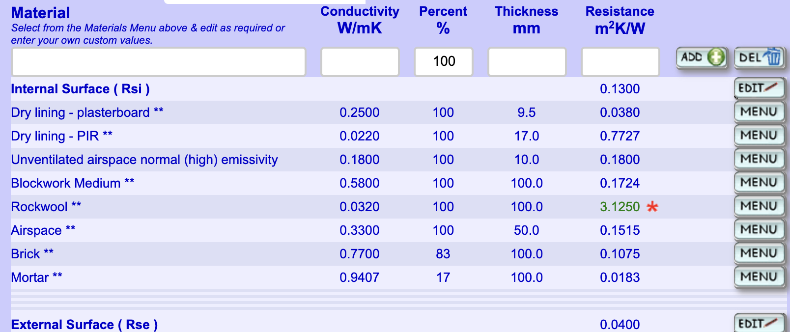

Not committed, looking at 17mm PIR bonded to 9.5mm plasterboard, as the insulated plasterboard.
I'm a little nervous about the dew point also. And I do think we have to assume there will be some gaps between the rockwool locally in a few areas...
Does that make sense ?

That thickness of PIR will be fine.
A quick play with Ubakus.com makes me think about 50mm of PIR is good.
What is the purpose of the 10mm high emissivity gap? It sounds like a recipe for thermal looping in the real world unless you can completely seal the gap. ( impossible in reality)

Thanks for the feedback.. It's dot and dab, so I've assumed some kind of gap behind the blockwork. Does that make sense ?
I don't want to go so high with the thickness, to conserve floorspace !
So to confirm, no need to worry about a VCL, even if the insulated plasterboard has no foil component ?
