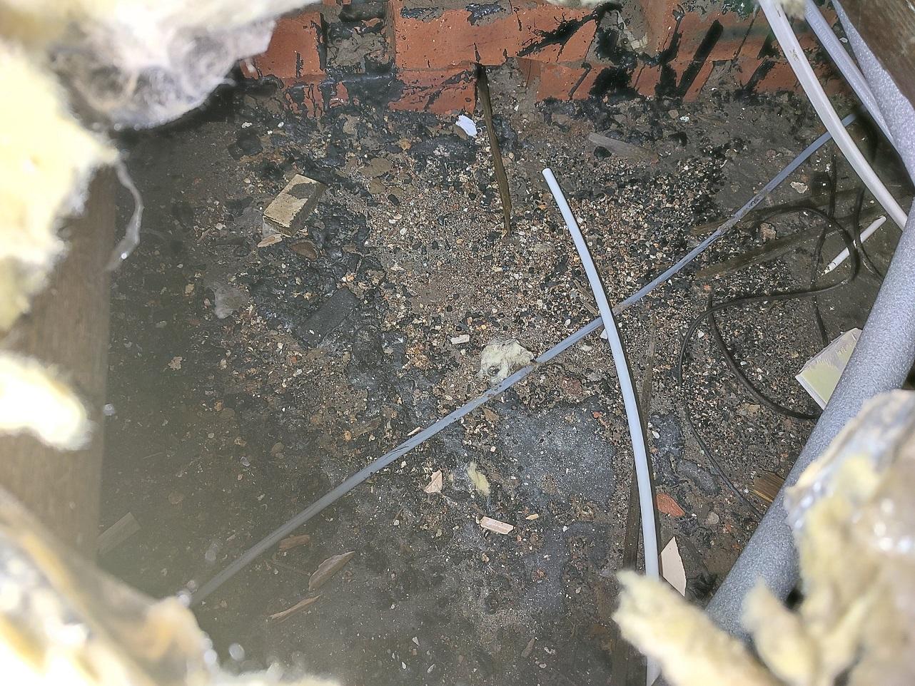

Just had a burst pipe under the suspended timber kitchen floor and need to rip a load of stuff up to fix it. I'd like to properly insulate, and also fit underfloor heating while I'm doing the work. We might have to get a heat pump at some point in the future, and having no radiator in the kitchen would mean we could have a much better layout etc - so while I'm ripping flooring up and fixing plumbing, I'd like to sort out the underfloor for the long term.

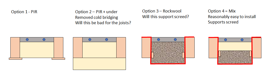

The joists are 5 inches deep, so would maybe fit 100mm of PIR insulation + a space for screed. However, I've seen people recommend rockwool on top of a dpm e.g. here
Would it be a bad idea to have insulation under the joists - this would reduce them acting as a cold-bridge, but they would no longer be exposed to the air to keep dry? 100mm is less than I'd like.
Options I'm considering
Curious what people's thoughts are.
Edit: I also have a bunch of spare 200mm EPS. I'd love to be able to use that!

Question is do you need screed at all in any option - no. You could do a pug mix, basically a weak sand cement mix. Or moulded EPS for the pipes, with additional insulation below. Flooring OSB or ply above then your floor finish.
Don't think 100mm PIR is deep enough, not to stop downwards heating.

Yes by screed I was thinking weak sand and cement mix like you describe, sorry if that was the wrong word. I've seen an 8-1 mix recommended e.g: https://www.centralunderfloorheating.com/underfloor-heating-installation/underfloor-heating-screed.html
Yes, 100 doesn't feel like enough to me... that leaves me with option 2 - or I could use thicker insulation, like the 200mm eps I have and leave the joist bottoms open to the air?

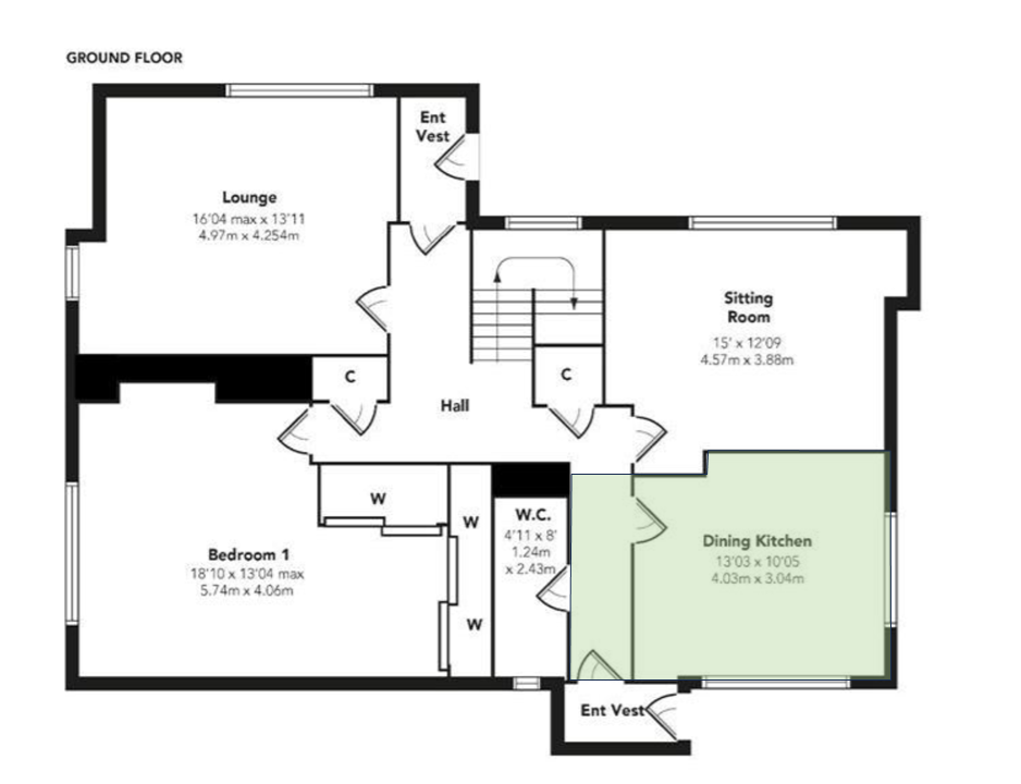

BCO will only be interested in the damp proof course, and the amount of insulation, but you should exceed what they ask for as UK building regs is dire on a good day. They'll 'maybe' be interested in you preserving airflow to the other ventilated floor spaces, so maybe it would help if you uploaded some floorplans showing these areas vs others etc.
Hmm, interesting idea. I measure 460mm to the top of the joists. So the amount of insulation needed might be costly. The floor looks to be sandy ground, with a few bits of broken brick here and there, haven't dug down to see what it's like. Floor is already pulled up to fix a leak.
I'd be doing the work myself - would I need a structural engineer or building regs involved? Presumably wouldn't with just joist-insulation.

Floor plan: Green area is the area in question, we're planning on knocking down the wall and extending the kitchen into the hall:
