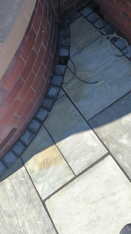

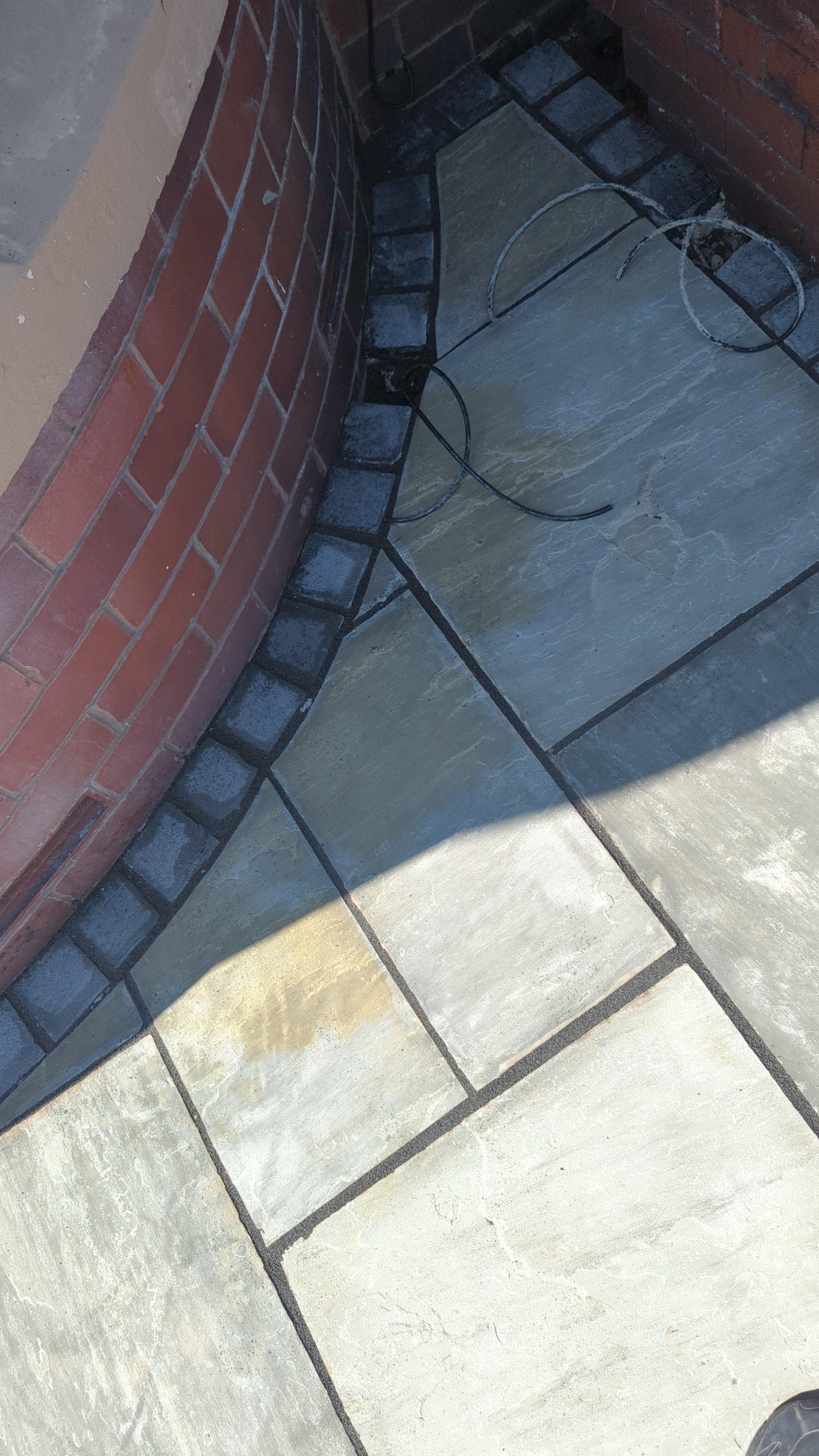

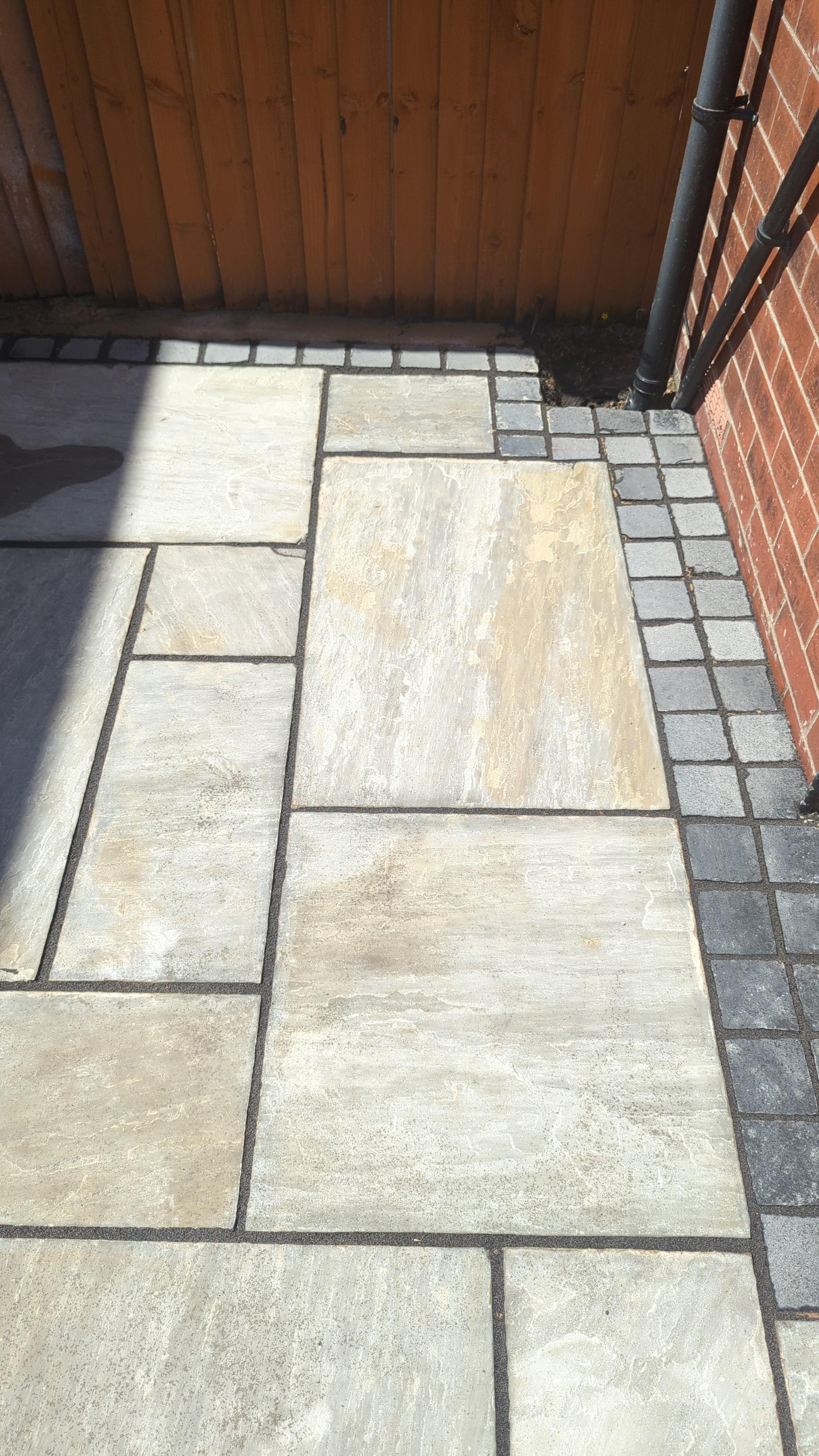

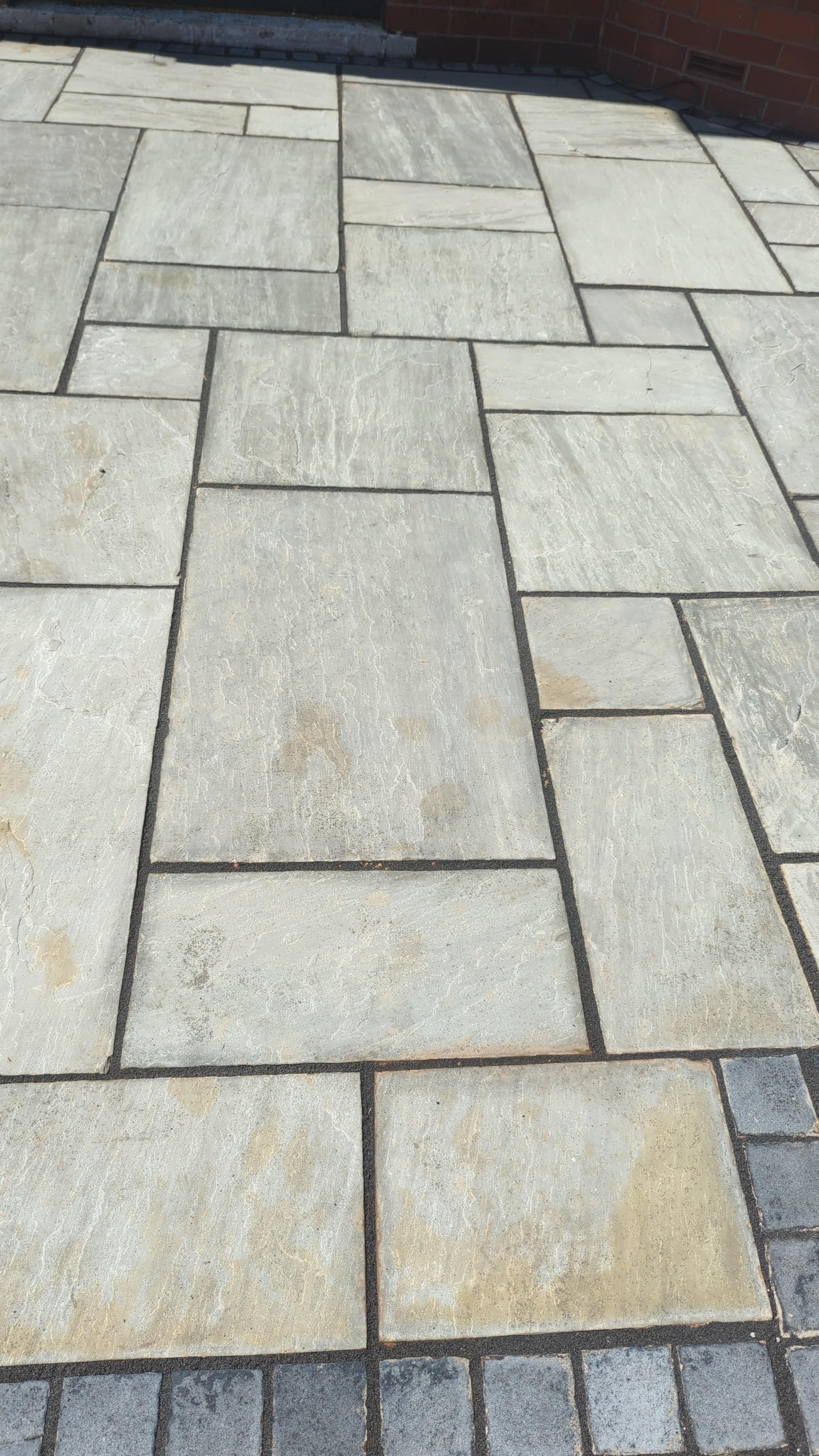

conzyv123 Posted June 5, 2023 Share Posted June 5, 2023 (edited) Was told by the building supplies shop that the patio cleaner would be fine on my new front garden, even after I said I'm sure acid based can't be used on Indian stone, but was told no they use it all the time, luckily I only used on the ending blocks but it has ran into the paving and I have lots of yellow patches, is there anything I can do to help with this issue ? 🤞🤞🤞🤞 Edited June 5, 2023 by conzyv123 Link to comment Share on other sites More sharing options...
nod Posted June 5, 2023 Share Posted June 5, 2023 You will probably have to just let it weather Your not alone Suppliers advise is often quoted on here They only sell the stuff 1 Link to comment Share on other sites More sharing options...
Johnnyt Posted June 5, 2023 Share Posted June 5, 2023 Oxalic acid 1 Link to comment Share on other sites More sharing options...
conzyv123 Posted June 6, 2023 Author Share Posted June 6, 2023 On 05/06/2023 at 22:35, Johnnyt said: Oxalic acid Expand Thanks, I have seen a few people say this in other chats, I will give it a try Link to comment Share on other sites More sharing options...

conzyv123 Posted June 7, 2023 Author Share Posted June 7, 2023 For anyone who is wondering I have used LTP Forrex diluted 1/3 and it's has removed the stains within 2 hrs 👍👍👍🎉🎉🎉🎉 2 1 Link to comment Share on other sites More sharing options...
