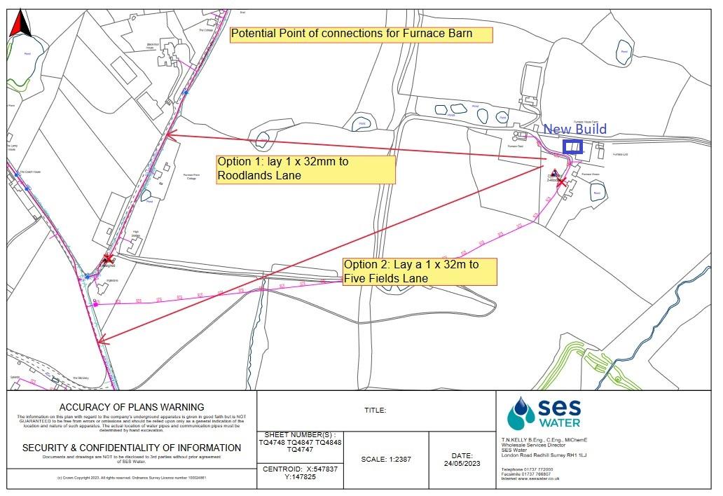

Furnace Posted May 24, 2023 Share Posted May 24, 2023 (edited) I own a farm and have applied for planning permission for a new build. There is an existing water pipe (shown in pink) running 250m from the road to a manhole (marked by red X) by my current home (the farmhouse). From the manhole, there are 3 pipes that serve the 3 properties on the farm. I had intended to obtain a separate water supply that would run 30m from this manhole to the newbuild's location. The water company is saying the Water Act does not allow this - all new dwellings must be connected to the water main, and has offered 2 options. This suggests I am required to install a duplicate pipe running 250m from the mains in the road to an almost identical destination. Do I have any options?. Edited May 24, 2023 by Furnace forgot image. Link to comment Share on other sites More sharing options...
Temp Posted May 24, 2023 Share Posted May 24, 2023 Appears not.. https://www.stwater.co.uk/building-and-developing/help-and-faqs/water/can-i-connect-a-new-property-to-next-doors-water-pipe/ Quote Can I connect a new property to next door's water pipe? No. Section 64 of the Water Industry Act 1991 requires separately occupied properties to be supplied by a separate service pipe. You're responsible for installing and maintaining the service pipe from your house to the boundary with the public highway. Water supply connections for domestic water purposes are provided under section 45 of the Water Industry Act 1991, as amended by the 2003 Act. You can lay the new pipe yourself. Some water companies allow different depths. Sometimes as shallow as 24 inches. I suppose it might be possible to lay 45mm pipe with a ripper and pipe layer on a tractor rather than trench but Ive not done that. Link to comment Share on other sites More sharing options...

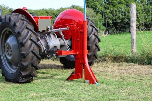

Furnace Posted May 25, 2023 Author Share Posted May 25, 2023 11 hours ago, Temp said: Some water companies allow different depths. Sometimes as shallow as 24 inches. I suppose it might be possible to lay 45mm pipe with a ripper and pipe layer on a tractor rather than trench but Ive not done that. Thanks Temp, SES Water require 750mm minimum depth so about 30inches. I hadn't thought about using a tractor (I have one) and was considering digging a trench (I have a small excavator) and possibly using it to also lay fibre optic cable. The village has FTTC, but the properties on the farm are served by very old and unreliable copper. Link to comment Share on other sites More sharing options...

Furnace Posted May 25, 2023 Author Share Posted May 25, 2023 3 hours ago, Susie said: they might want to check the depth so tractor and ripper might not be allowed. I've asked them what and when they need to inspect. It could be they need the entire trench to be open prior to any pipe going in but I'm awaiting their reply. It all seems crazy since there's already a water supply here, but the rules may now forbid using it for a new dwelling Another big sigh Link to comment Share on other sites More sharing options...

IanR Posted May 27, 2023 Share Posted May 27, 2023 (edited) Just to add my experience. Water company (and Electricity) wanted 1200mm depth due to crossing a field that could potentially be "deep ploughed". No one could give me an explanation of what typical agricultural process would go anywhere near that deep, but they had a drawing and were sticking to it. I was told that up to 32mm water pipe could go in without requiring chlorination. My trench went in 900mm wide (iirc) x 1200 deep and I laid the ducting for the electrical connection one side and the water pipe the other. Water wanted to inspect it before it was filed, so after they gave the OK, I back filled to around 600 deep and then laid in the OpenReach duct and cable, plus another duct for my own data and power to the gate. The 100mm duct I used for power was really too small, it was a difficult pull for the 3 phase public supply cable (only drops to domestic supply at 25m from property). Next time I'll go with a 150mm duct. I also wished I'd left a pull chord in the BT duct, would have made retro-fitting FTTP (which has just been done) far simpler. In truth the trench took no time, although we did bring in a 13T machine for it. 150m was dug in a day. Edited May 27, 2023 by IanR Link to comment Share on other sites More sharing options...

Furnace Posted May 27, 2023 Author Share Posted May 27, 2023 (edited) @IanRThat's really helpful. It seems a bit crazy to lay in a duplicate pipe, but if the rules require it... Deep ploughing 1200mm???? Not on any land around here. It's 'min till' all the way in these parts. I think using a larger machine is the way to go. My digger is only a 3ton job and will struggle with such a deep trench. I've probably got 250-300m to dig and in the winter the clay sticks like **** and in the summer it's like concrete, so power will likely be the answer. Of course, the route that avoids tree roots will likely smash the clay land drains, leaving another problem to be resolved. Did the water company require barrier pipe because it was a farm? What diameter conduit did you install for the Openreach connection? Edited May 27, 2023 by Furnace Link to comment Share on other sites More sharing options...
