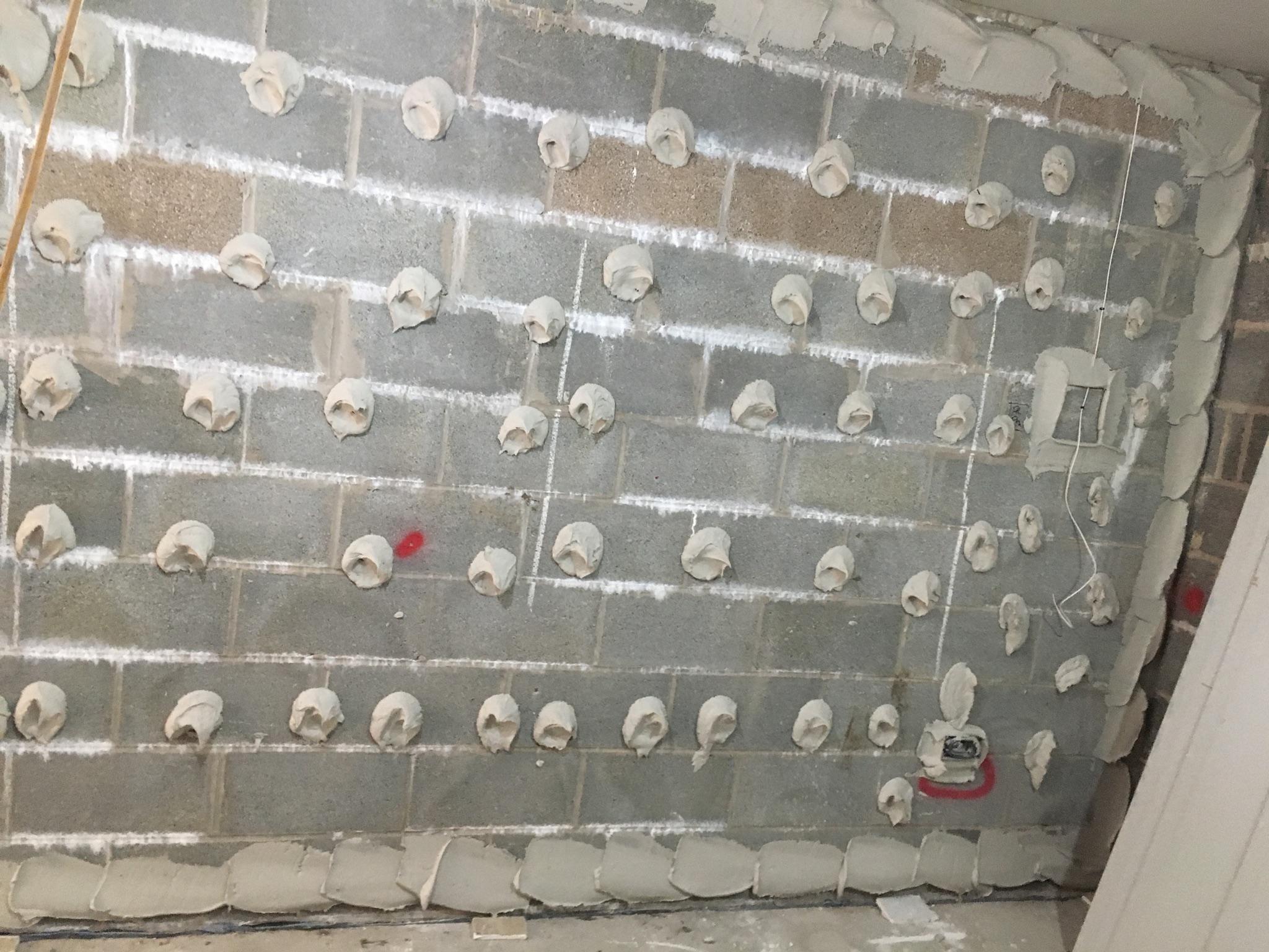

We've got our shell erected, brick and block cavity wall construction.
I'm looking to retroactively bring our wall u values up, and it looks like drylining with insulated plasterboard is the only realistic option.
I was previously hoping to use wet plaster for the "easy" air tightness, but this doesn't appear to be feasible...
Any recommendations for how we can best ensure we get decent air tightness with insulated plasterboard dot and dabbed onto concrete blocks?
Parge coat?
Tape applied where?
If anyone can give me a bullet proof spec, that would be awesome.
Thank you in advance

00F5852C-6CB0-4FE0-B87F-1E4EB84975BD.thumb.jpeg.0b519fe3ea484a190cd5a56c52171307.jpegMany on here swear by Parge But from an airtightness point of view it’s a waste of time
It’s better to make sure that the continuous lines of dab are applied around all perimeters sockets and window reveals Acoustic sealant should be applied to ceiling edges also
and before you start make sure all joist ends are pointed in tight
Pink backed PBS for dabbing

wow, awesome, thank you. This should be easy enough to specify and explain with your picture and comments :)
Your welcome
Simply repeat around the house
Window reveals and heads
Parge won’t do any harm Your only looking an afternoon for two spreads to do a four bed home
But don’t refer to it as an airtightness layer
It will say on the bags Sound coat
As soon as you say airtightness They won’t bother solid dabbing the angles
Most of The properties that I dot and dab have to achieve a rating of 2
Whilst they big builder saint test many
They do test some and we never know which ones
 Good luck
