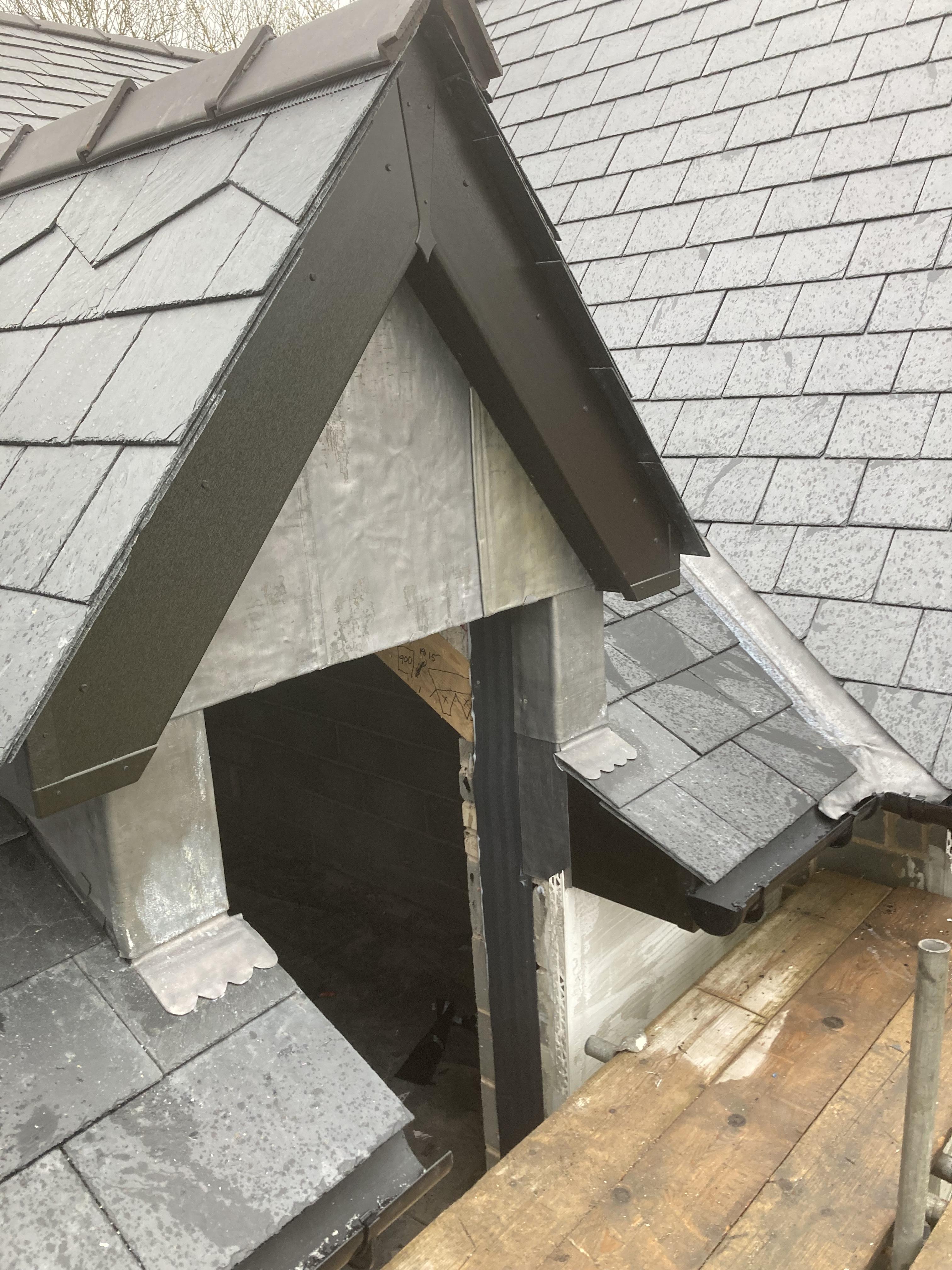

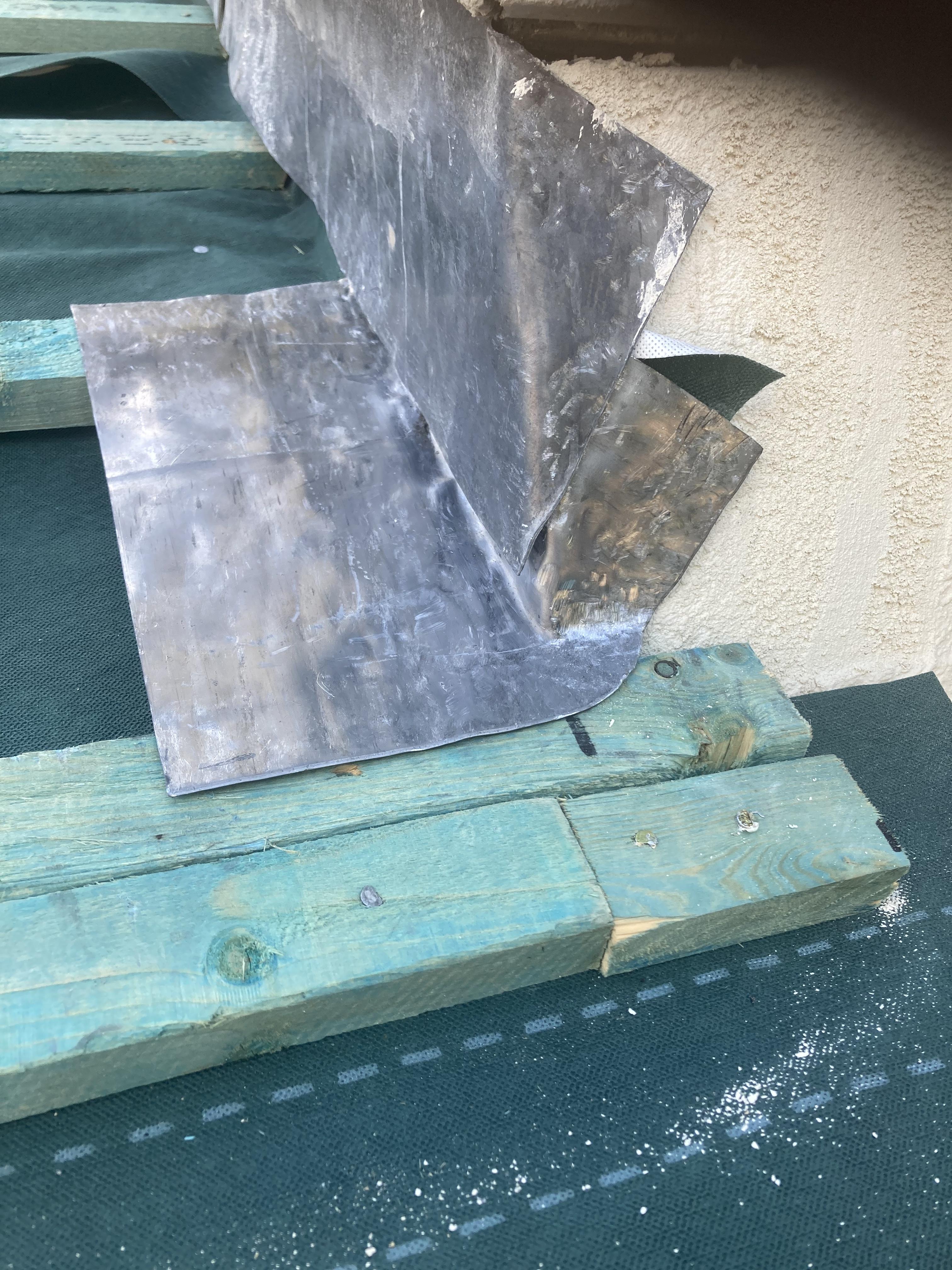

nod Posted May 19, 2023 Posted May 19, 2023 Someone asked about a lead corner detail I did promise to post when I was doing some more lead pictured is nothing fancy as it’s nearly all covered Just enough to cover the external corner base
Dave Jones Posted May 19, 2023 Posted May 19, 2023 they normally make the cover flash a bit longer and dress it down to make a nice finish. all cosmetic of course.
nod Posted May 19, 2023 Author Posted May 19, 2023 Yep As I say you won’t see any of that it will finish simalar to this 2
